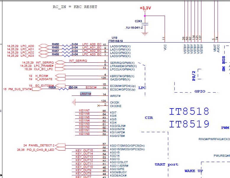

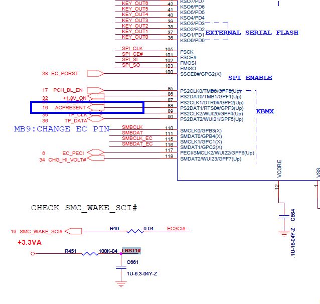

Found WRST#/ LRST#( EC_Reset) missing

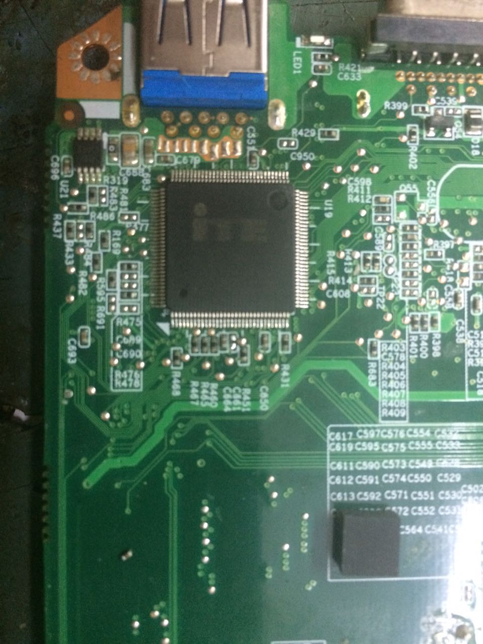

Further tracing for problem found 3.3V on pull up resistor R451 but not on PIN 14 of IO controller
So biggest and only suspect as seen in schematic is C661
Removed and Bingo
