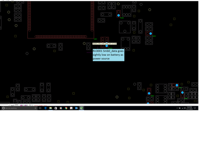

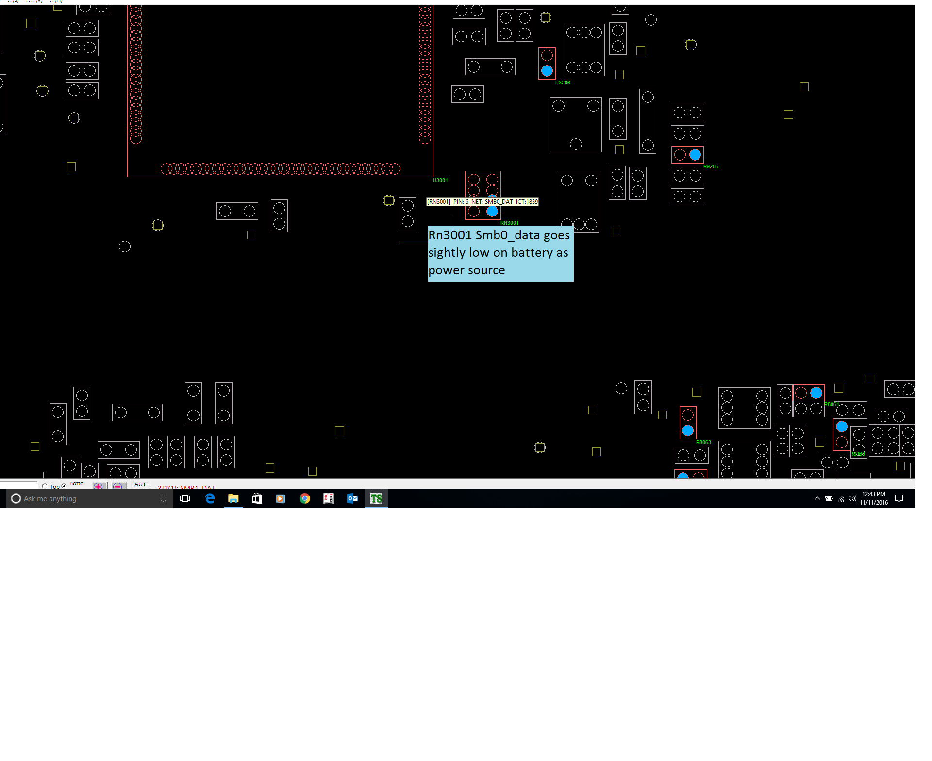

[hidden]2 days Back received a HCL laptop which is ASUS motherboard with the problem as working fine on adapter and battery, charging ok but at only battery doesn't work even do not power on. as all you know there is no pdf for this so worked only board view and finaly found as attached image in fact sm bus pull up goes low to 2 volts on battery as power source.
