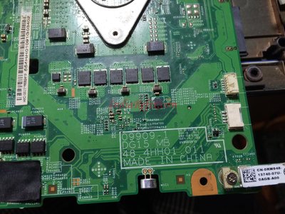

MODEL- DELL INSPIRION 5010
BOARD PART - DG15 MB 099091-1

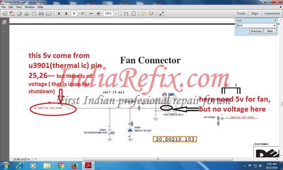

THEN TOUGHT IF TO RESOLVE THE FAN VOLTGE MAY BE WORK
THEN GO TO CHECK FAN PIN 1 NO 5 VOLTAGE
TRACE IN SCHEMATICS FAN PIN 1 CONECT TO THERMAL IC U3901 PIN 25,26 THERE IS NO VOLTAGE
CHECK THE PIN IMEDANCE OK BUT NO VOLTAGE
CHECKED THE VDD 5V PRESENT IN PIN 27, 24 OK BUT NO VOLTAGE FOR FAN
THEN REPALCE THE U3901 IC BUT NO VOLTAGE FOR FAN
THEN CHECKED FOR PIN 1 VDD 3.3V RUN ,,,, HERE NO VOLTAGE

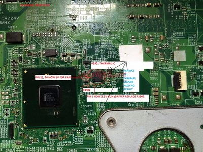

TRACE IT FOUND R3902 IS OPEN SO THAT NO 3.3V IN PIN 1
RESOLUTION
JUST REPLACED R3902 RESISTER ALL VOLTAGE OK
PIN 25, 26 NOW 3V TO 5V AS PER HEAT FOR FAN
PIN 1 3.3V
NOW ALSO FAN CONECTOR PIN 1 PRESENT FAN VOLTAGE
AND FAN WORKING FINE
THEN CHECKED BOARD ALSO WORKING FINE NO SHUTDOWN
DONE AFTER LONG TIME 5 DAYS

BOARD DG15 MB 09909-1
U3901 AND RESISTER PLACE  R3902 IN BOARD
FAN PIN 1 NO VOLTAGE
U3901 AND RESISTER PLACE  R3902 IN SCHEMATICS
NOW IT WORK FINE
NOW IT WORK FINE
