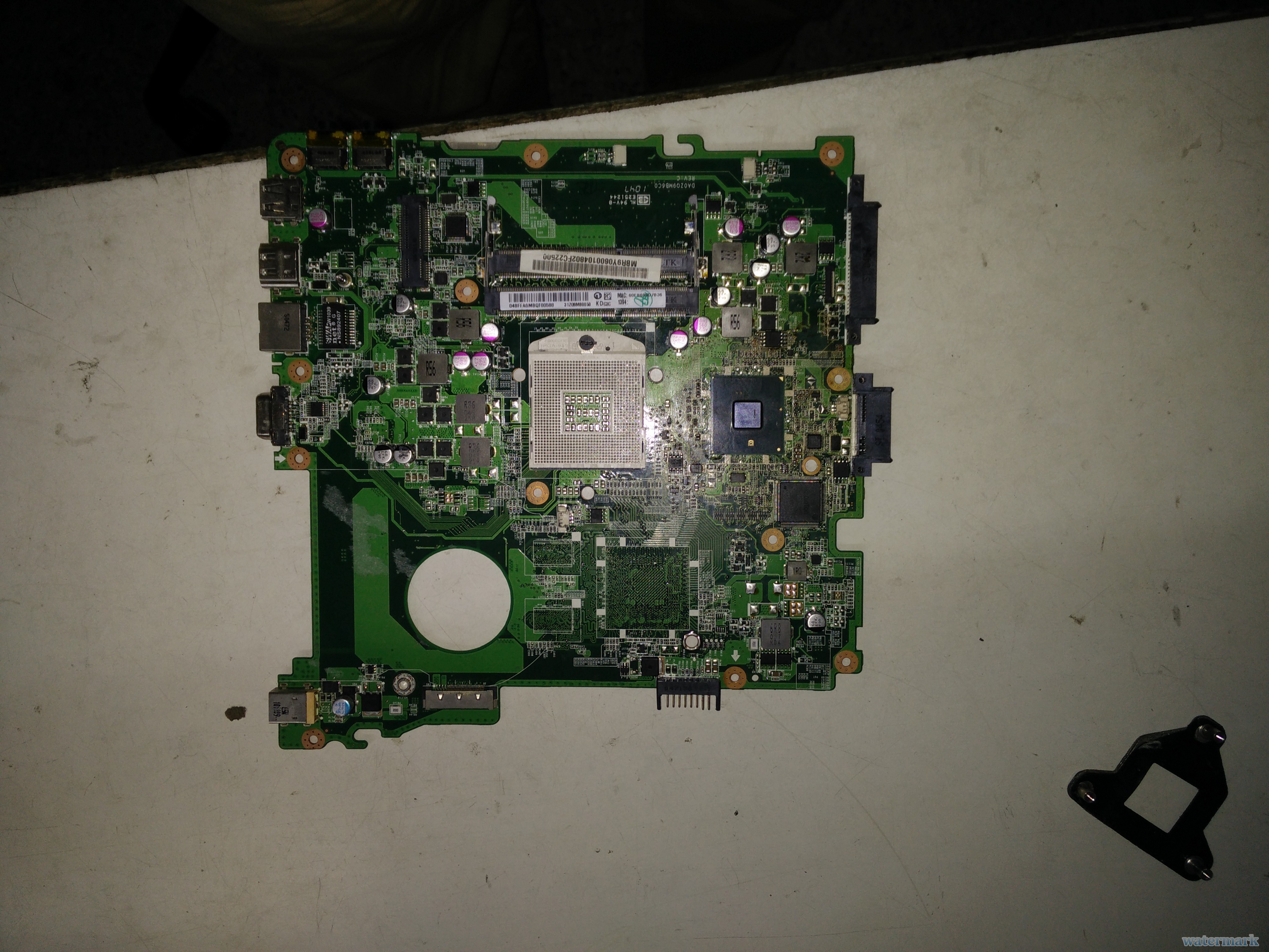

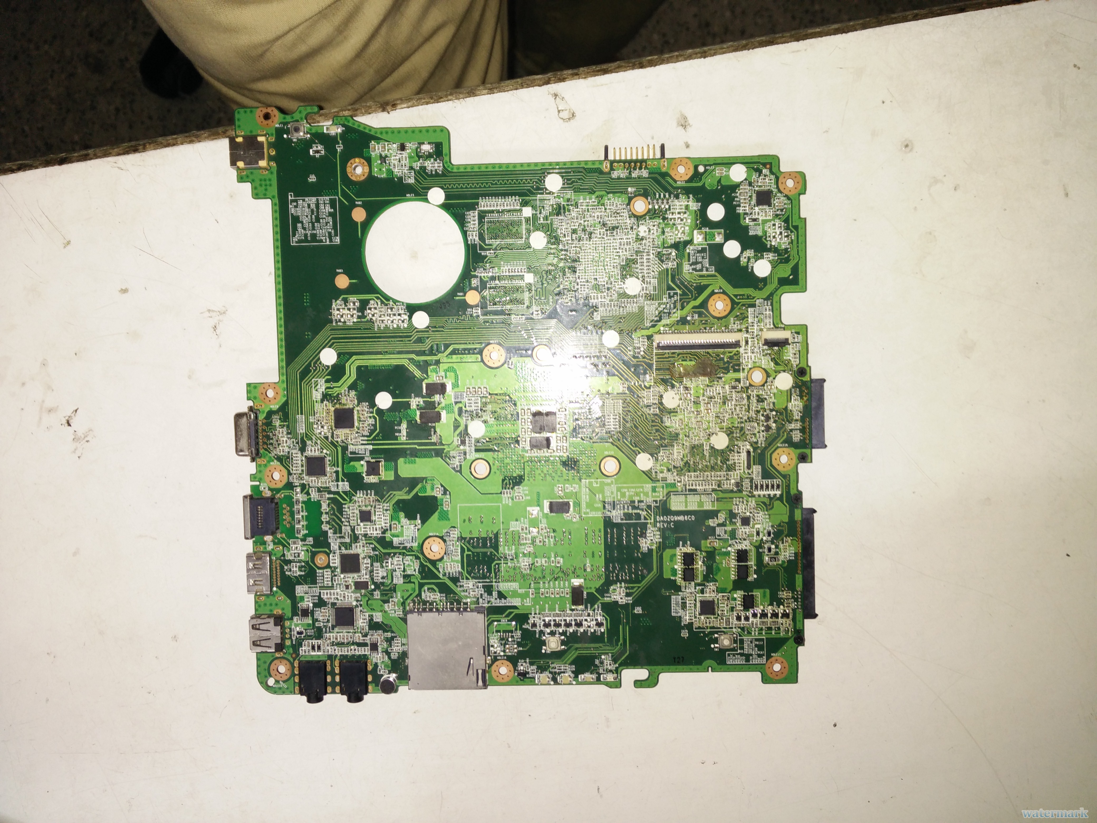

I have uploaded photos
Model no : Acer aspire 4738
Board no : DA0ZQ9MB6C0
Problem : Not detecting HDD & ODD
Work done : Replaced PCH / Reflash BIOS / Checked +5V at HDD Connector present
There is no TX data signal coming from PCH to HDD

Pch new?
Re: Acer aspire 4738 not Detecting Both HDD & ODD
I think first was with cleaner if no result
then check the around of pch if any resistance or capacitor missed or removed
I had such case
if not then Rework the pch
