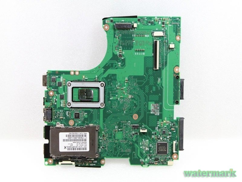

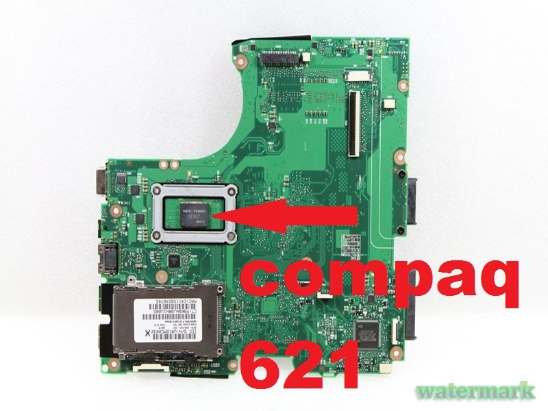

Case Study : Compaq 621
Fault : bios password and power off when loading windows or installing os.
Diagnose write bios password removed. Now power off problem. Remove token(Nec) .
PUT 6 Caps. 330 problem solved .laptop working fine .

arunbharti wrote: Fri Apr 14, 2017 9:17 am SAME CONDITION NOT WORKING !! ANY OTHER SUGGESTION
Did you changed the NEC/Tokin Cap ?
arunbharti
Re: Compaq 621 bios password and shutdown
Post by arunbharti »
Yeah sir I add the 330 capacitors same condition
