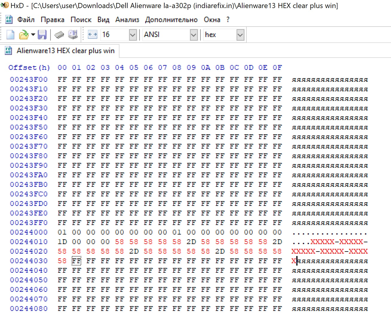

Thanks for the dump. I inserted a clean region replaced the Windows key. everything began to run very quickly. but alienfx doesn't work. On the motherboard there is still flash memory with a smaller volume. maybe you have a dump from it.
I think this is where the address is stored to manage Alienfx
Alienware13 HEX clear region winXXXX.rar
(3.92 MiB) Downloaded 250 times

I guess this is really the memory of ALIENFX
I thought my memory dump was corrupt. but flooded it back. and to my surprise, the backlight turned on in the same green shade.
ATTENTION. after ALIENFX firmware. need to sew the main BIOS clean region. because The system has not booted.
For you, dump the BIOS with a clean region. You only need to add your Windows key through the Hex editor. (instead of XXX)
For you my dirty dump AlienFX
thanks aamkaachaar.
(I wouldn't have succeeded without you.)
(3.92 MiB) Downloaded 235 times
alienfx dump.rar
(393 Bytes) Downloaded 244 times
