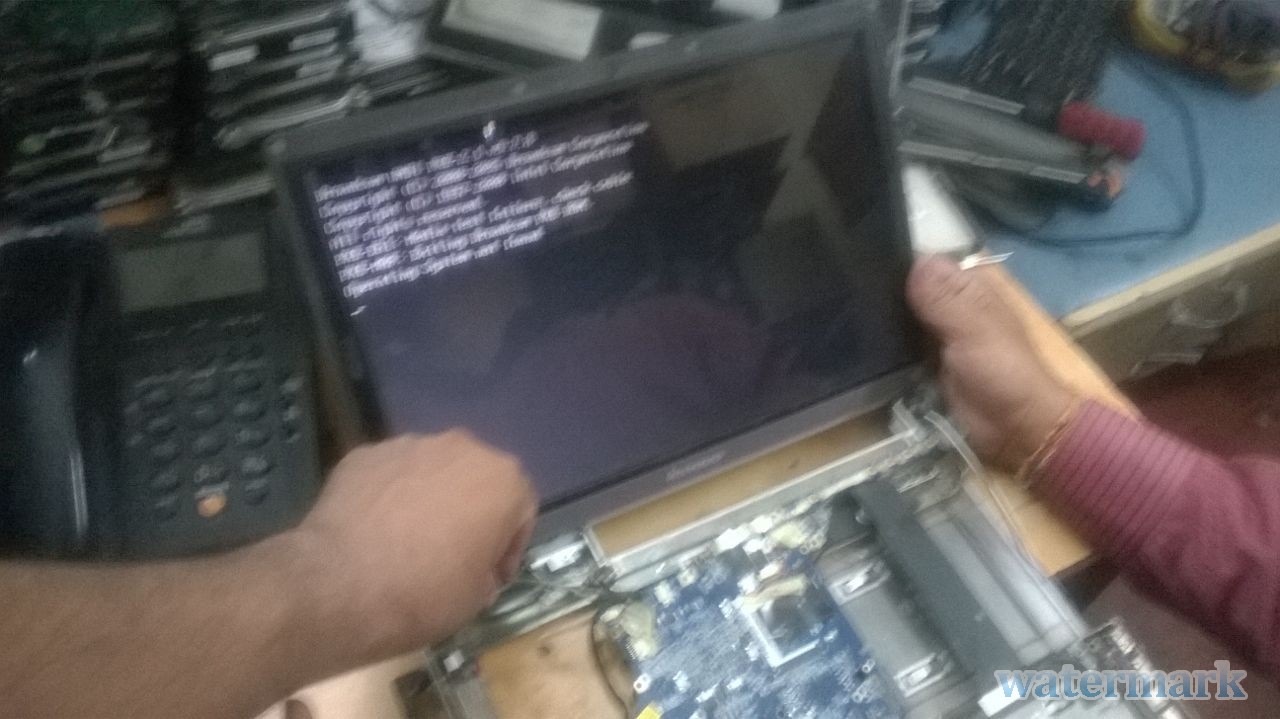

Case Study
Make/Model- Lenovo Y410
Motherboard Part No- Compal LA-3571P
Processor Type- C2D
Ram Type – DDR II
Problem – No power
Diagnosis- Short in 19 V line
Process-
Laptop is in no power condition …. Diagnosis found short in 19 V line .. Found PC160 Short in the Vcore section .. replaced and Job done
