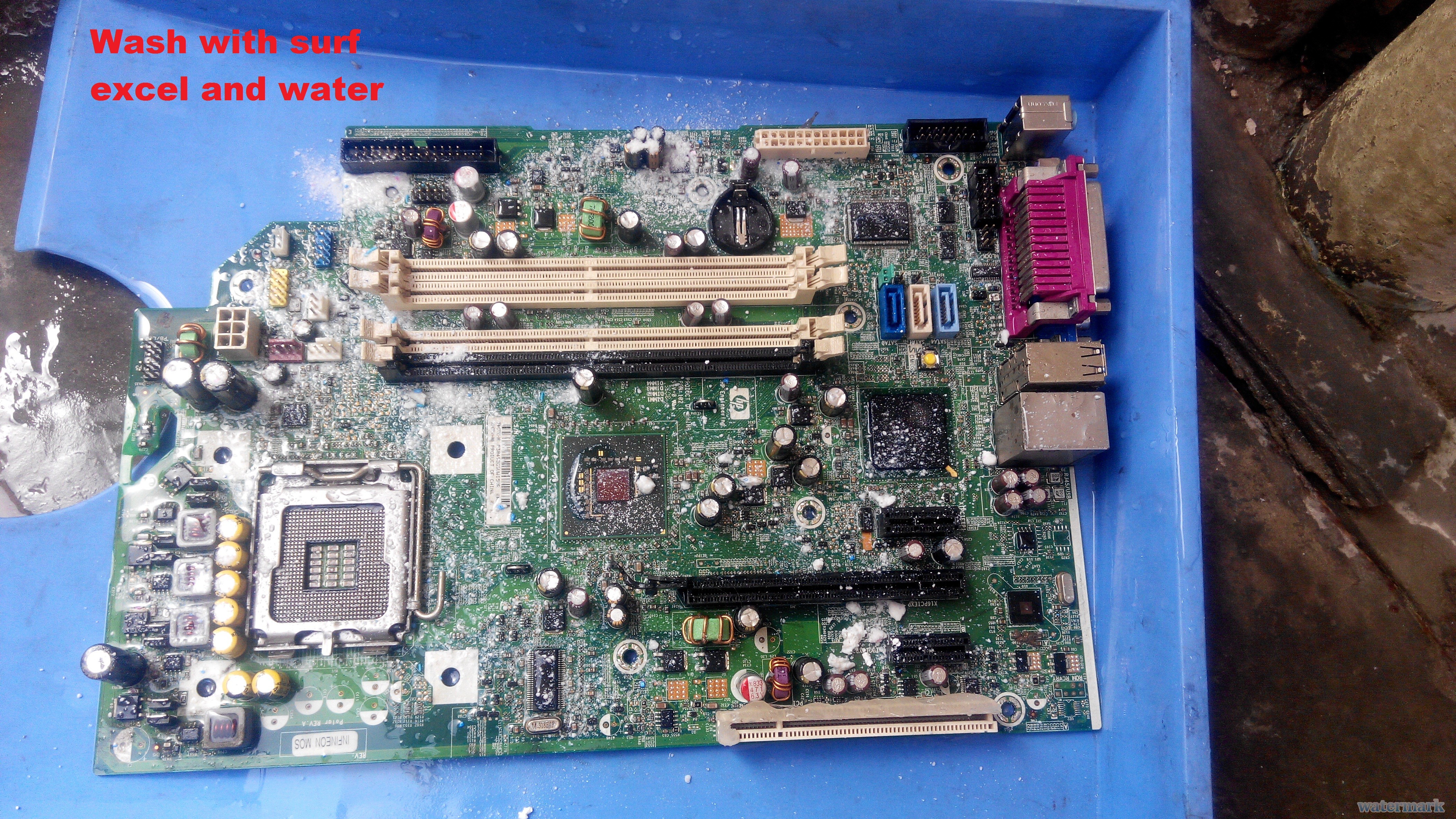

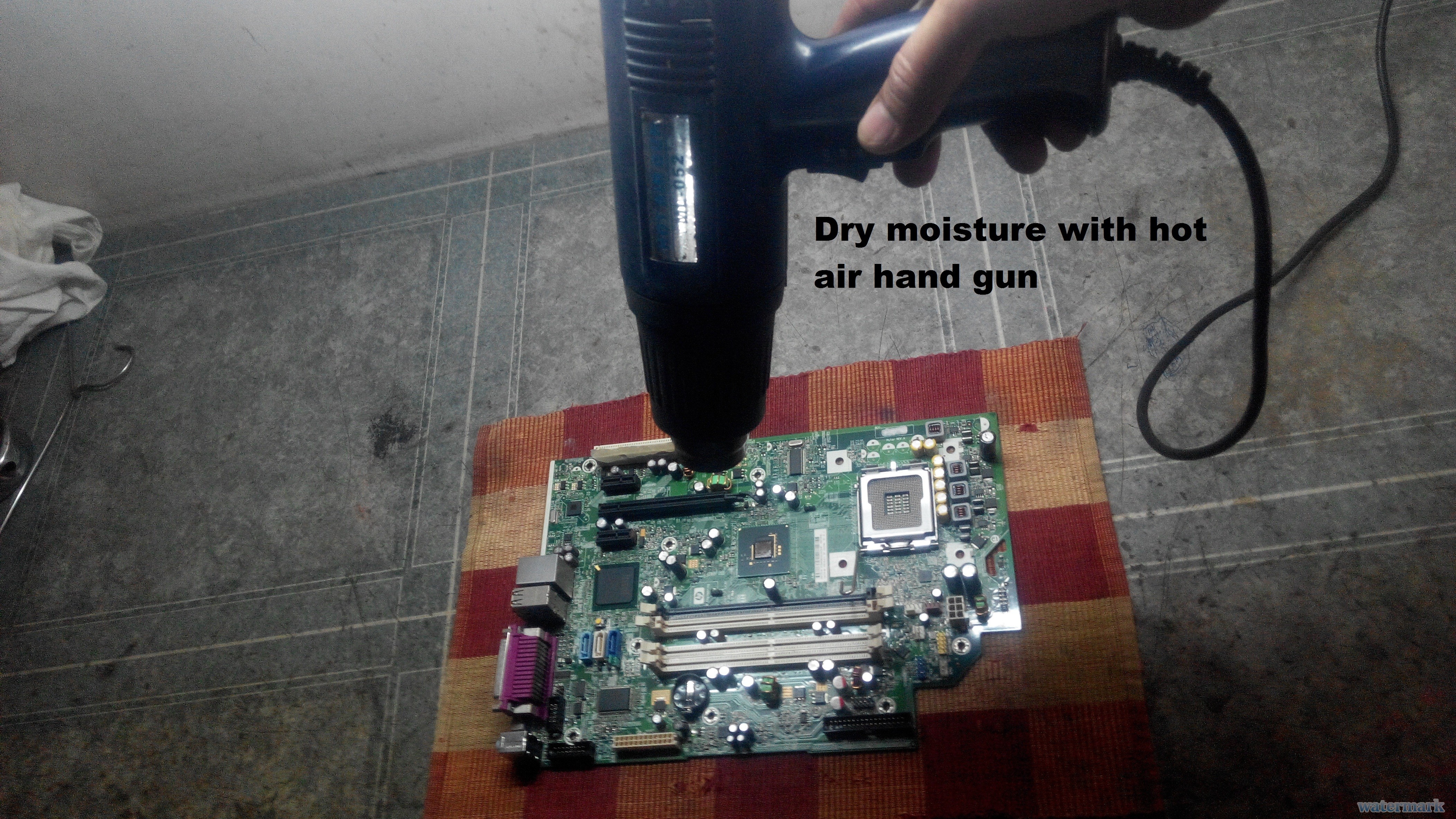

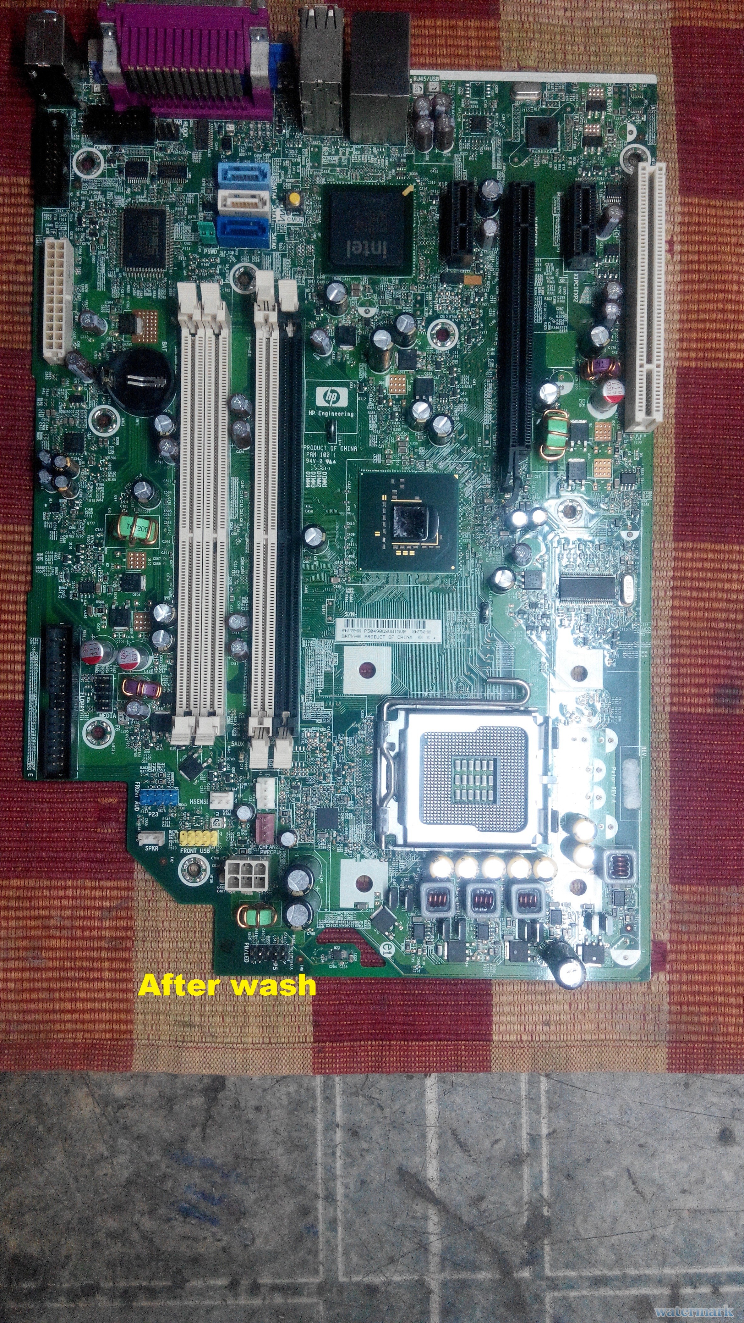

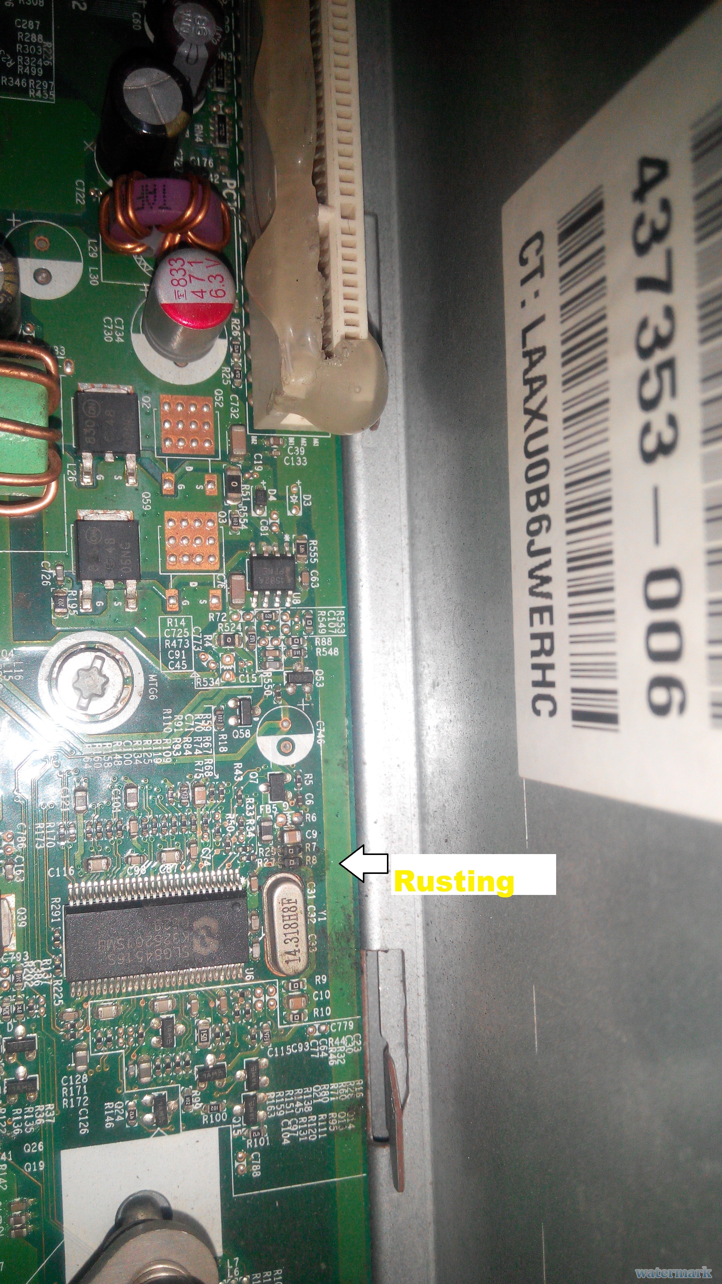

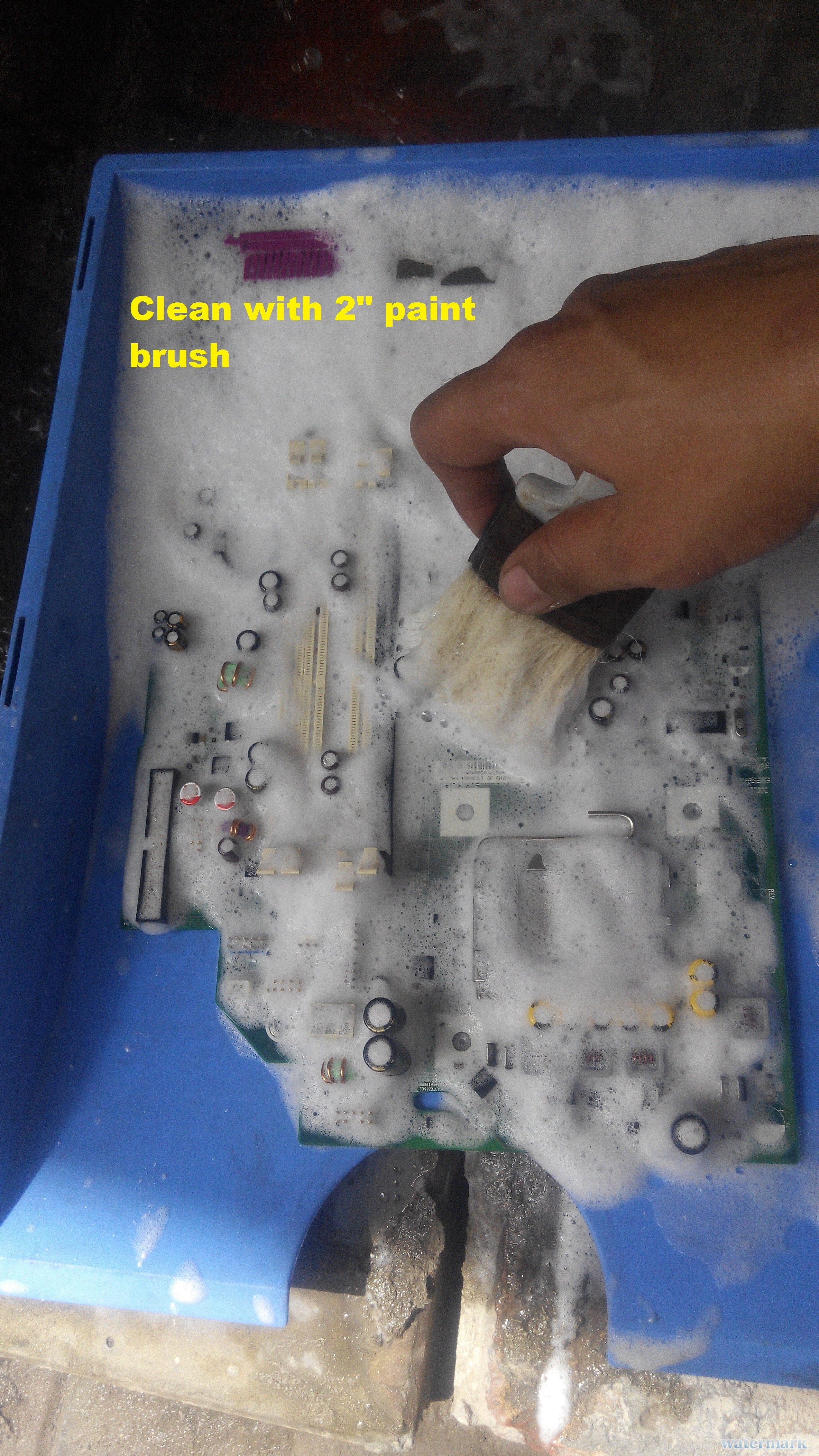

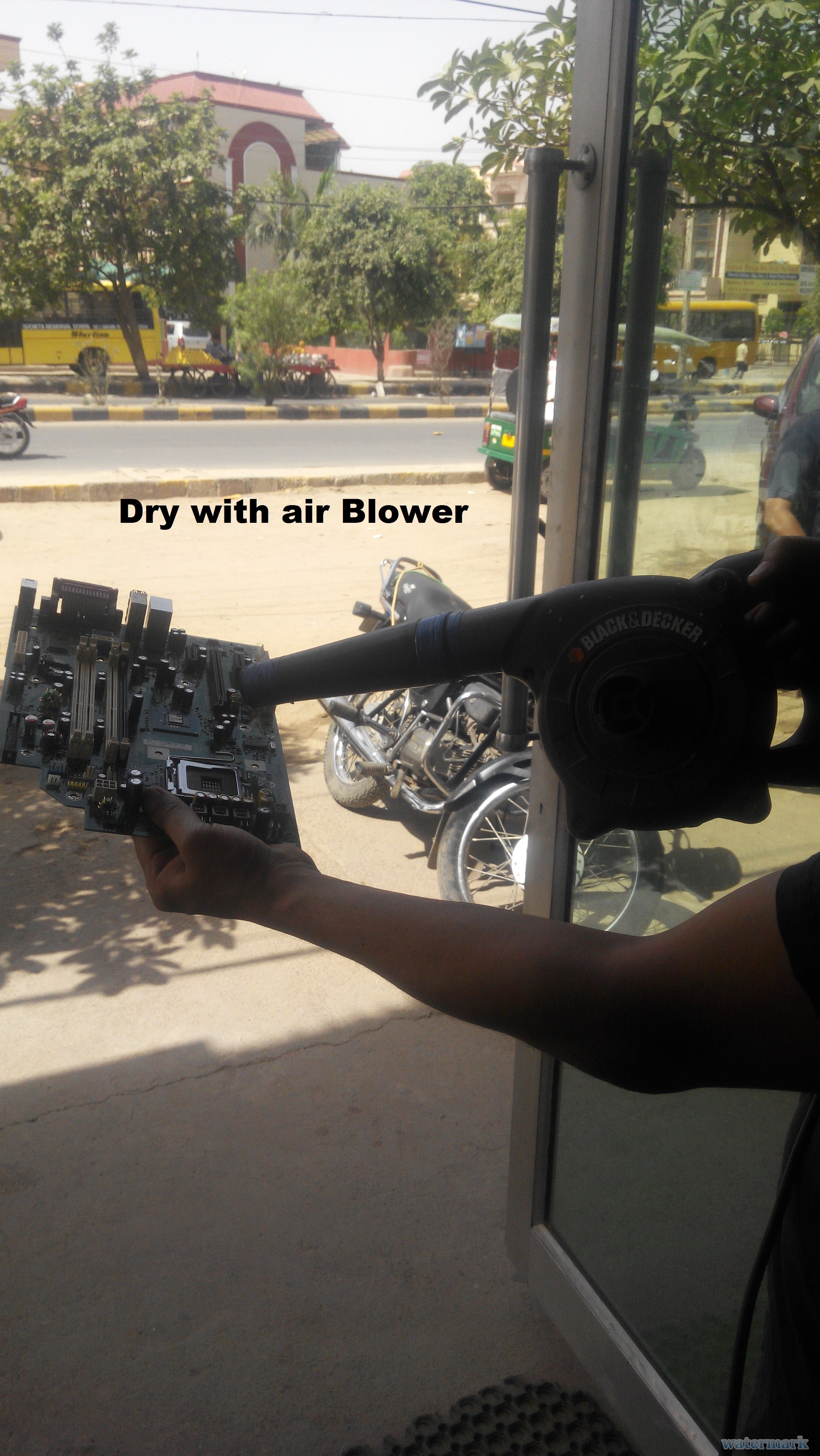

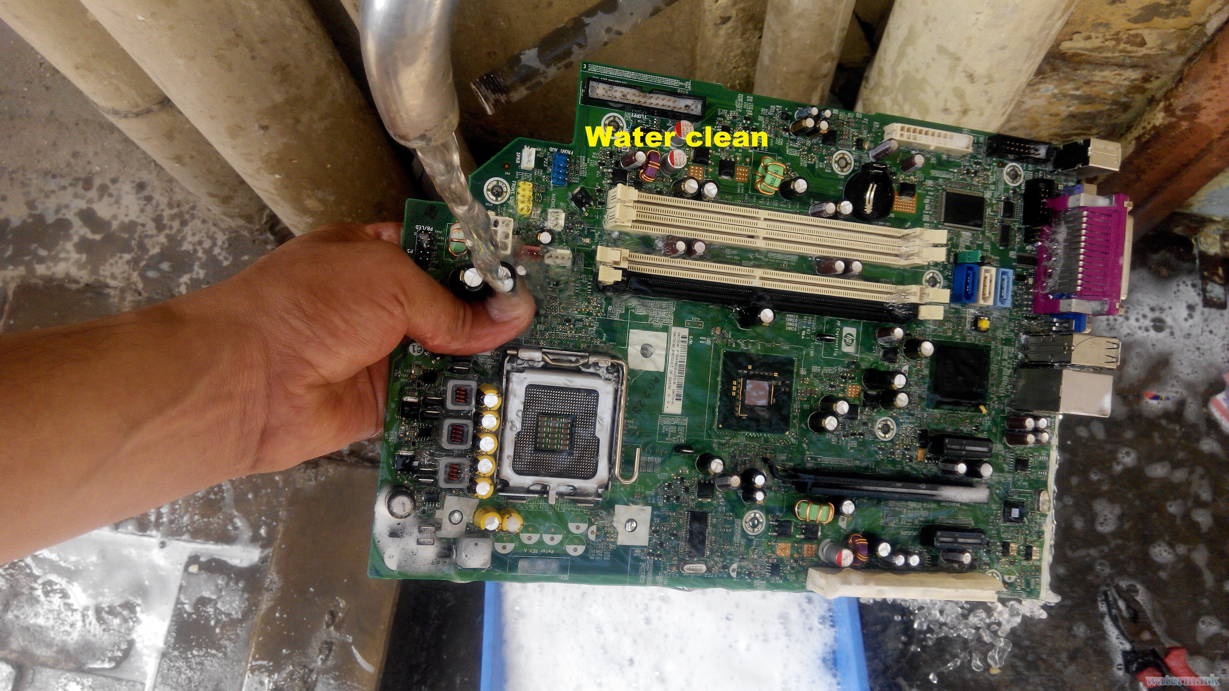

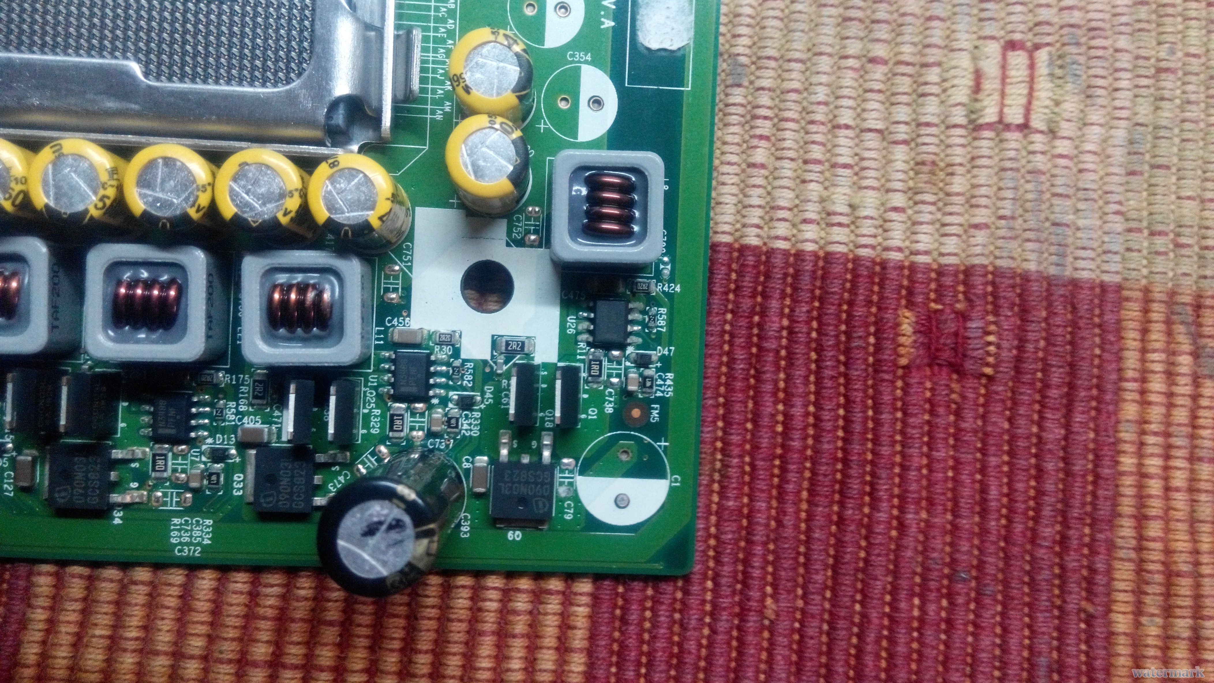

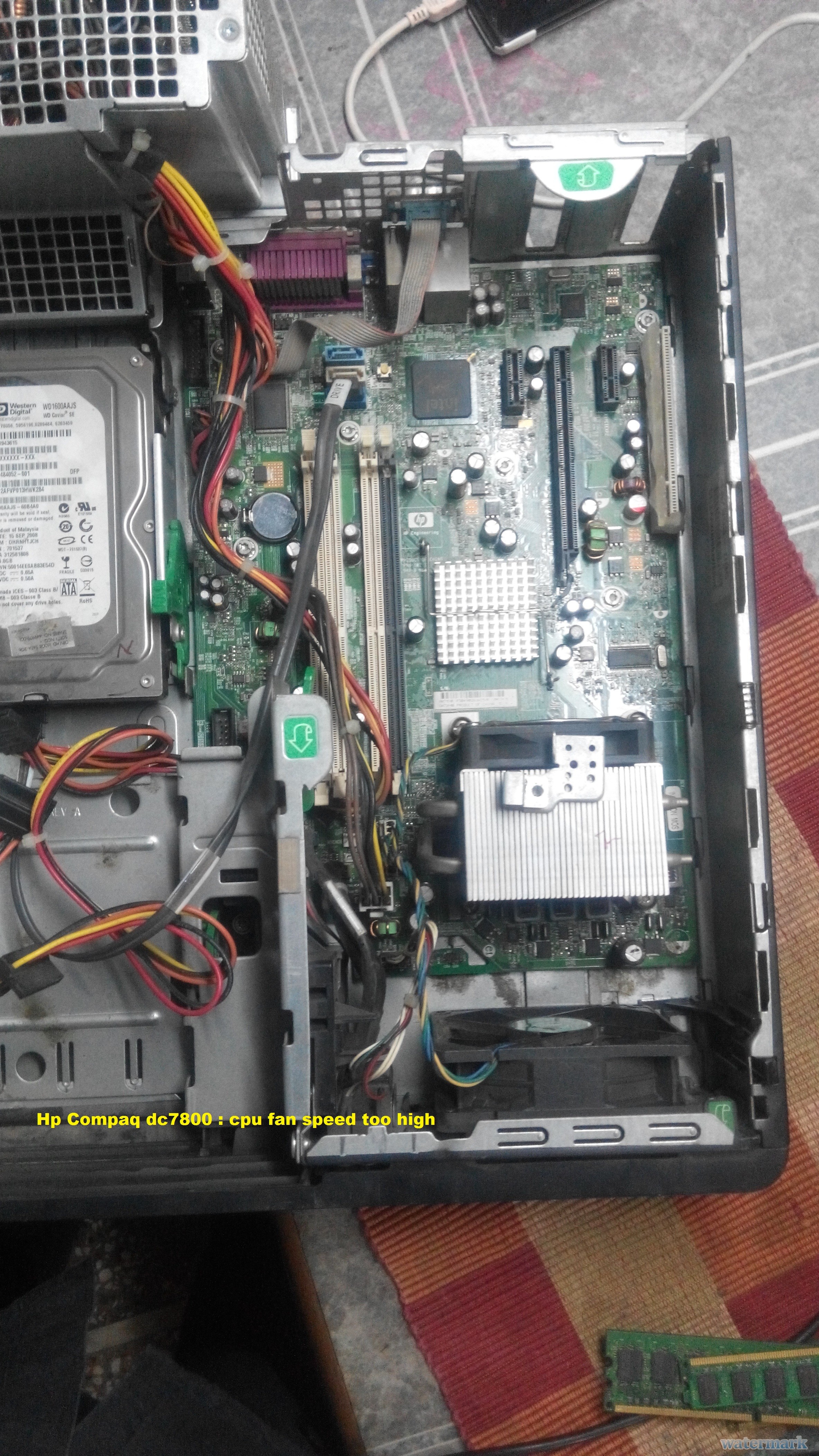

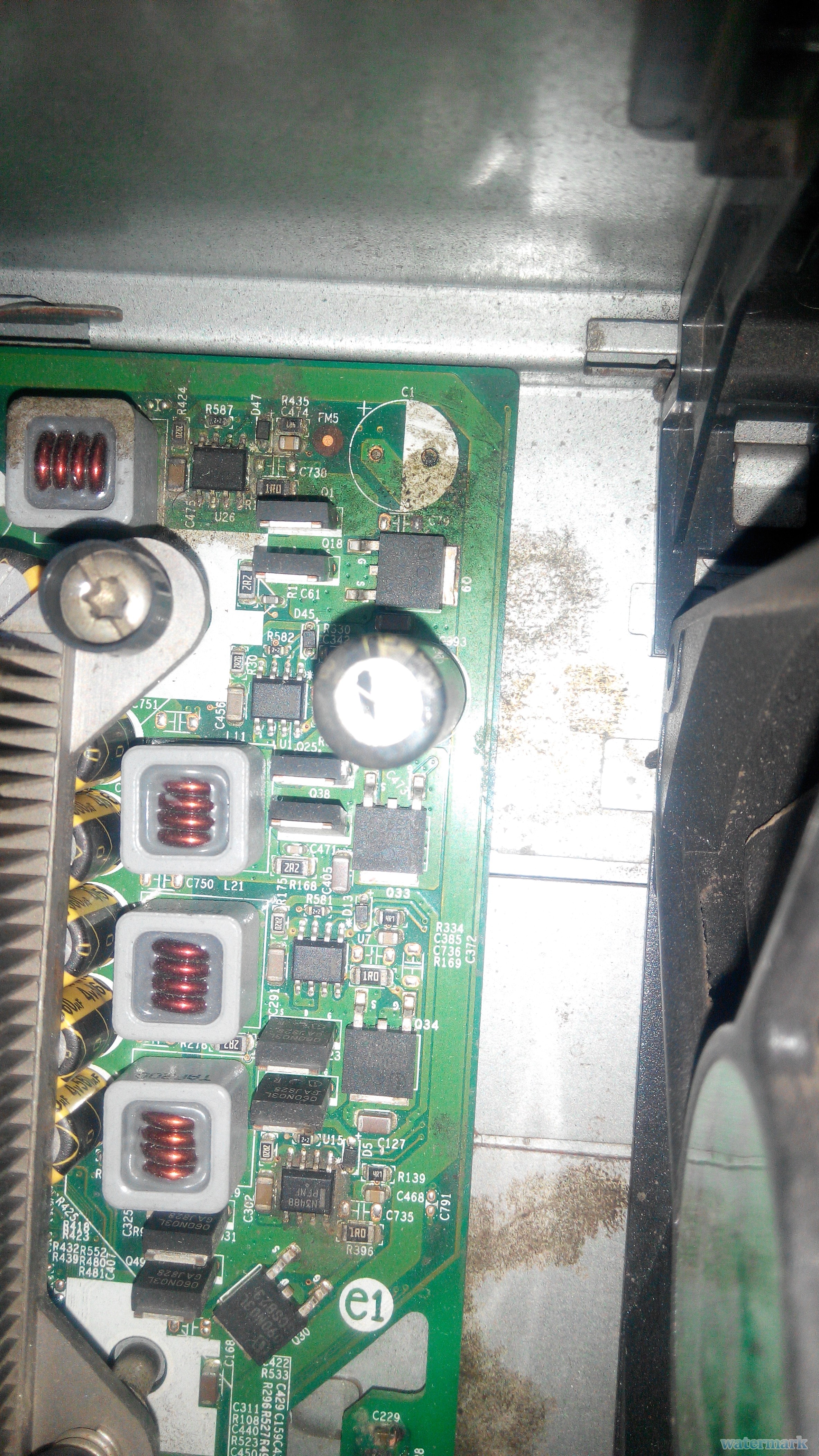

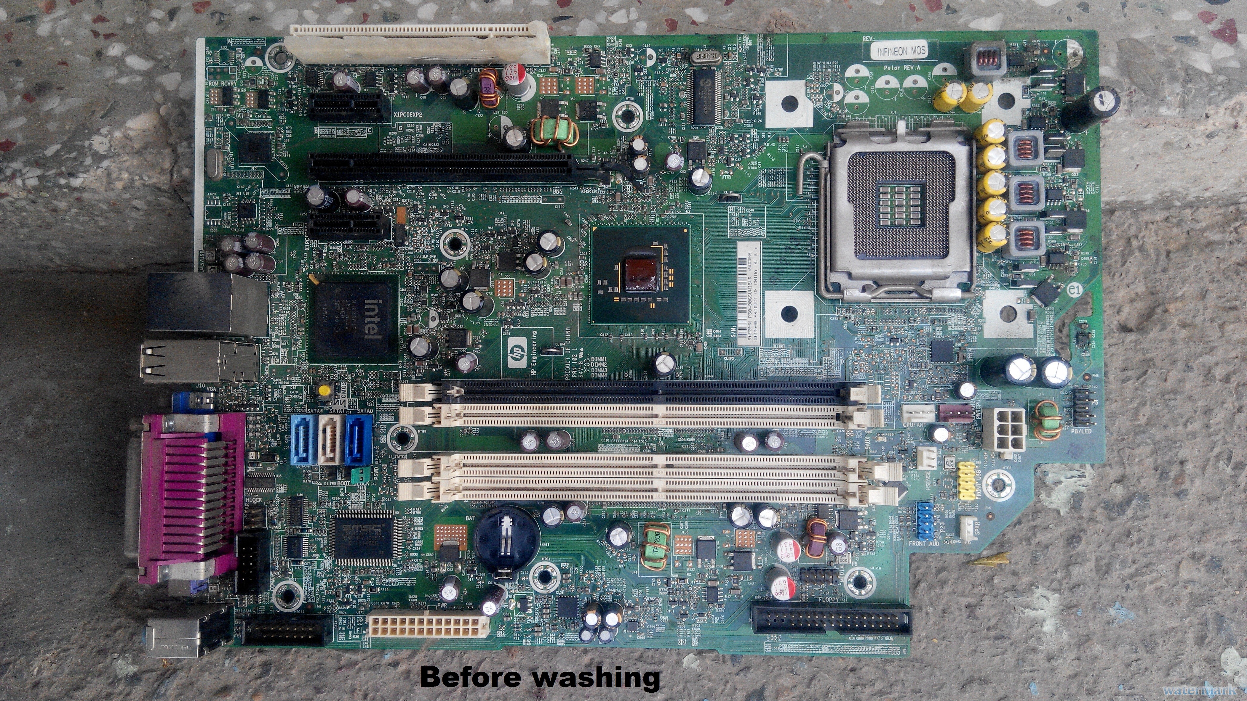

case study hp compaq dc7800 desktop pc : cpu fan speed too high . so sound of fan vary critical . system mb too much dusty and rusting many area of mb . i wash with water, dry and check mb ok .fan speed normal without sound .
