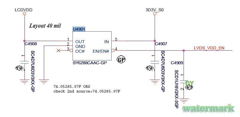

LENOVO B490 WHITE SCREEN PROBLEM.DISPLAY AND LCD CABLE CHANGED.FINALLY TRACE THE BOARD LCD VDD 3.3V MISSING.REMOVE U4901 AND DIRECT PIN 1 AND 5.NOW DISPLAY WORKING.
