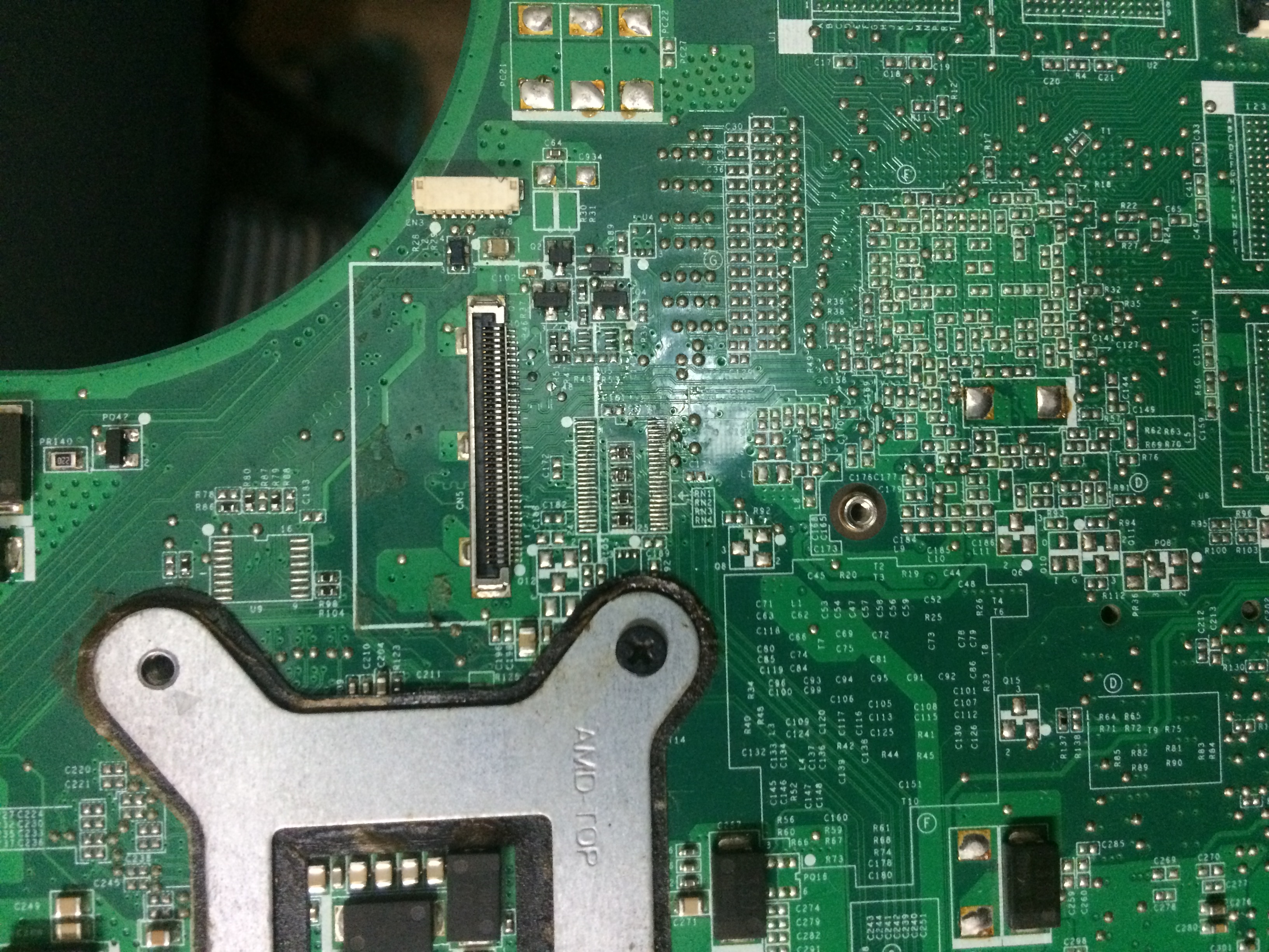

plz send some pic of up and down mainboard near lvds

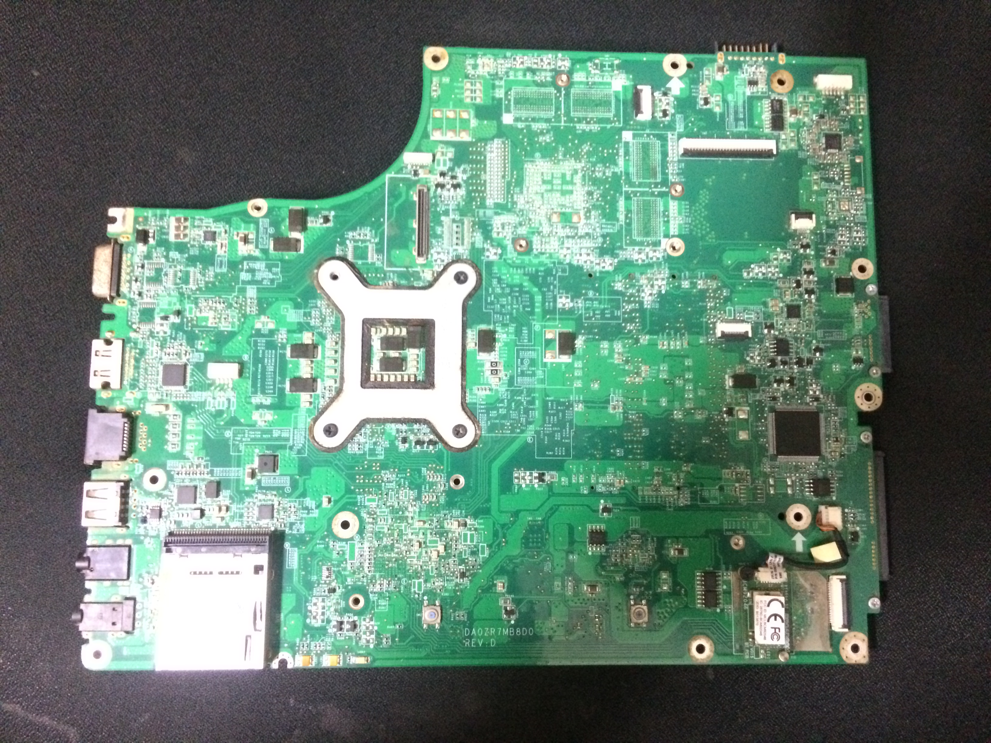

satish panchal
Posts: 41
Joined: Tue Jul 12, 2016 1:29 pm
Re: acer 5745 backlight not on
Post by satish panchal »
i have attached pic of motherboard
please give me urgent answer of backlight not on problem
mahmood
Posts: 67
Joined: Thu Aug 17, 2017 6:49 am
Location: iran,golestan
Post by mahmood »
plz jamp pin 5 and 36 lvds amd remove this cap
