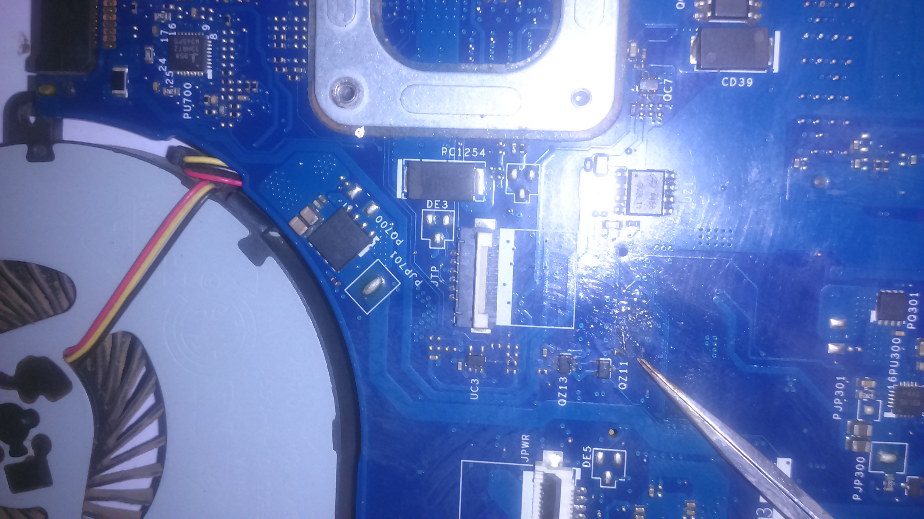

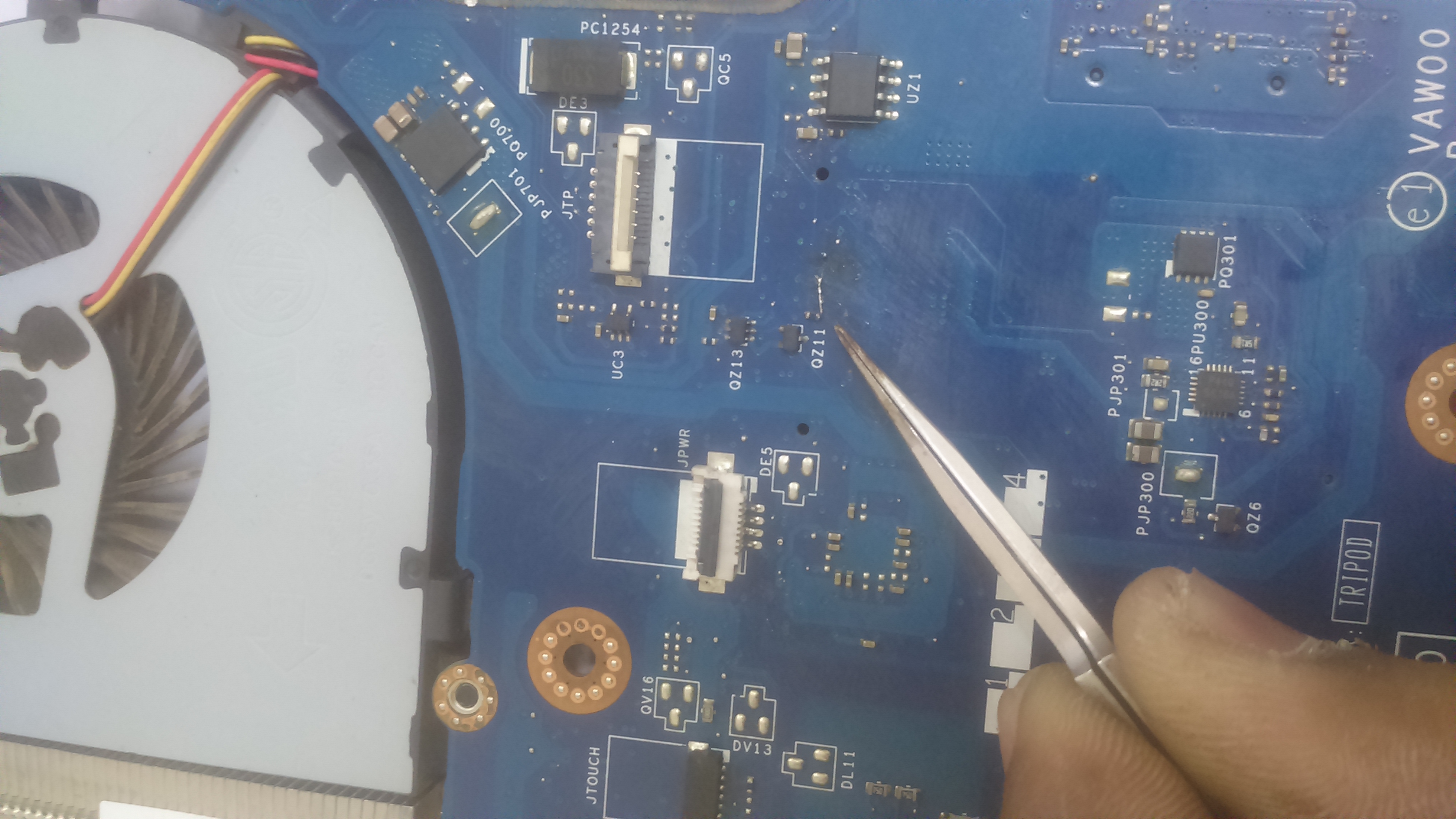

Dell 3521 laptop Power on but no display ...
Chek ram holtage ...okk but chek cpu not proper working then i found...cpu back cide track is cut...build it and now laptop working...
