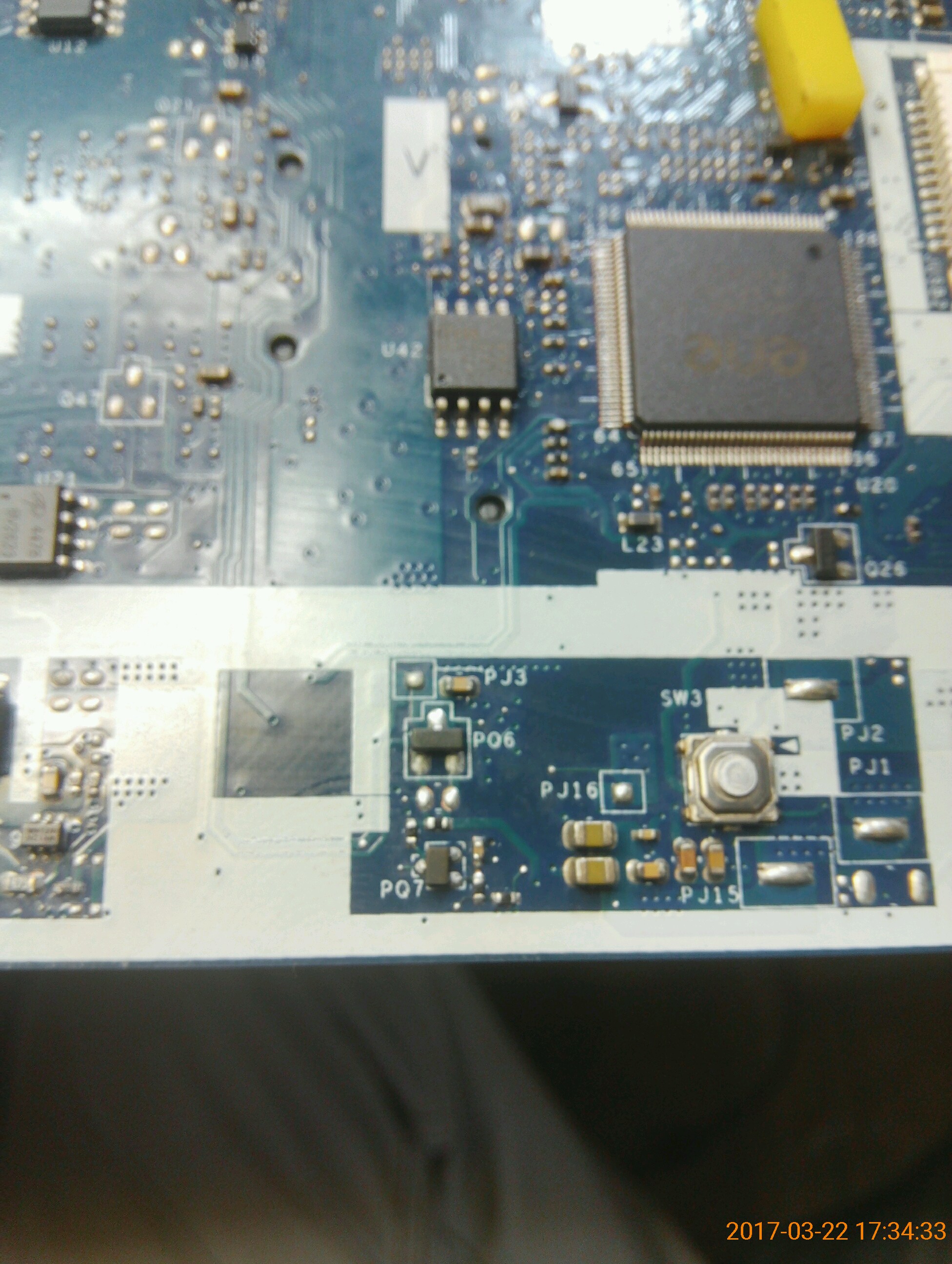

Acer E1-571(LA-7912P) had no display.checked all voltage ok.no vcore supply.psu taking load of .11 only.found 100k resistor open near pq7.replaced it and its working fine
