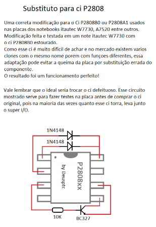

Many people suffering on Clevo Motherboard for power controller SMD IC P2808B0. Because it is very difficult to find the replacement chip. Now i found a solution through internet. Now i solved that problem by following way. First remove the chip and place 2 diodes, Resistor and transistor indicated on image. That's all enjoy. If it useful to anyone please add some points to me and give some positive comments.
