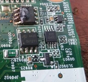

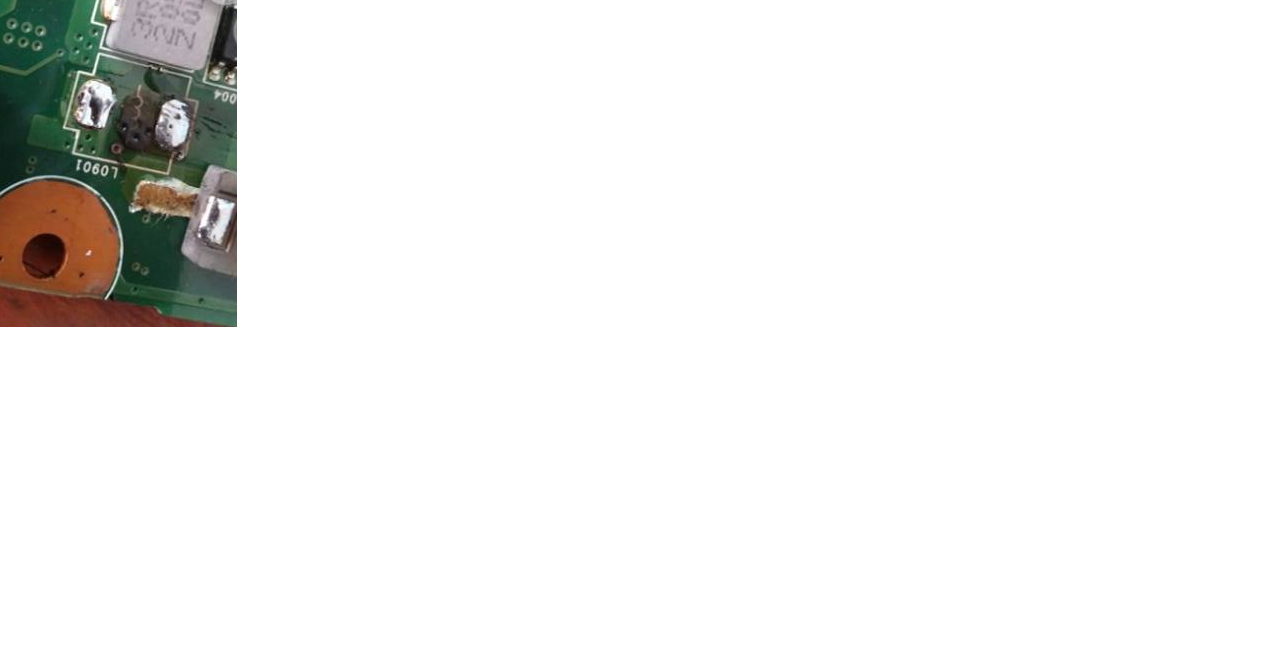

HP 630 laptop no power. Found ic,s burnd Replace burn ic Q0901,Q0902=P1203BV N-Chanel 2FET.Q0906=AO4435 P-Chanel FET and U0901=OZ8681LN Charging IC. .Problem solver. Power on and charging good (my net connection is slow so i crop imeges for low size kb) thank u

GOOD JOB BRO
