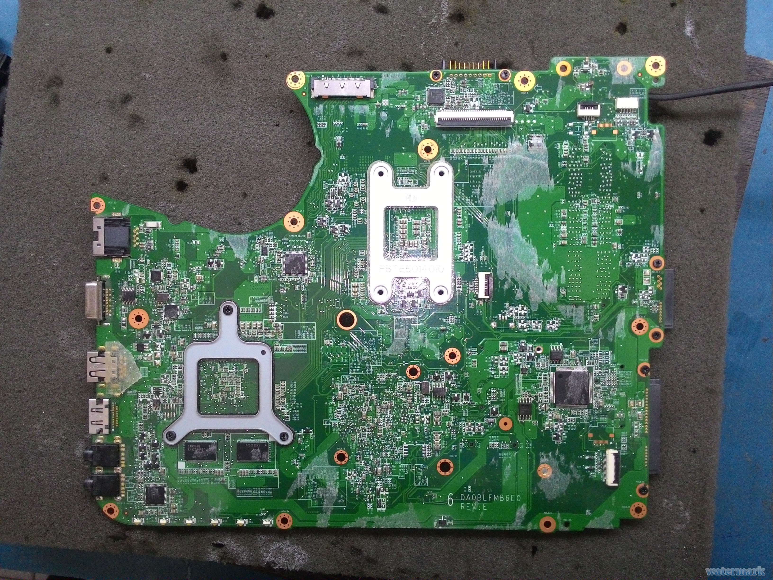

TOSHIBA N750 DA0BLFMB6E0 FULL AMD
problem no power
checking 19v short in motherboard
check PC138 short
change capisiter
laptop working ok
