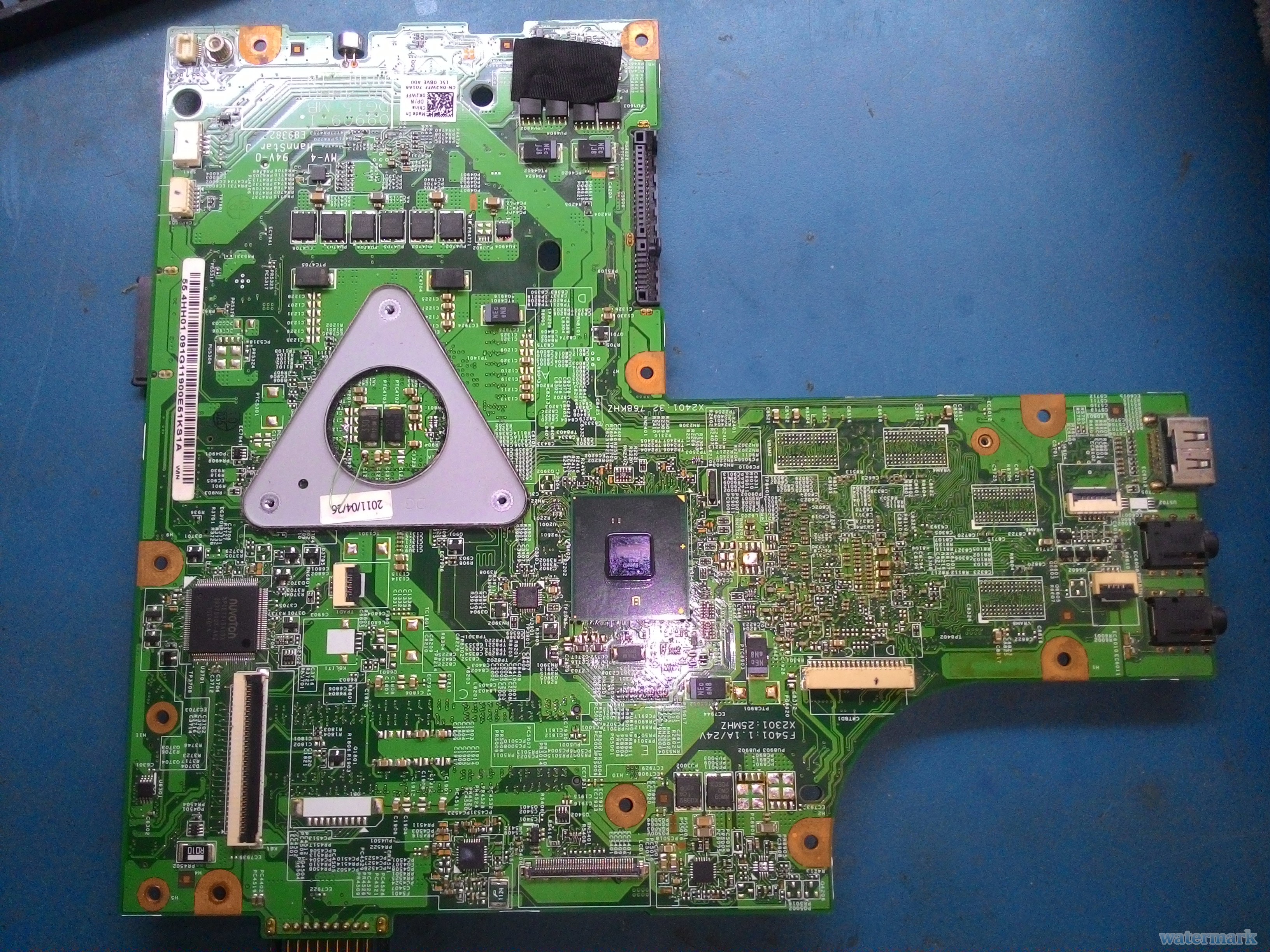

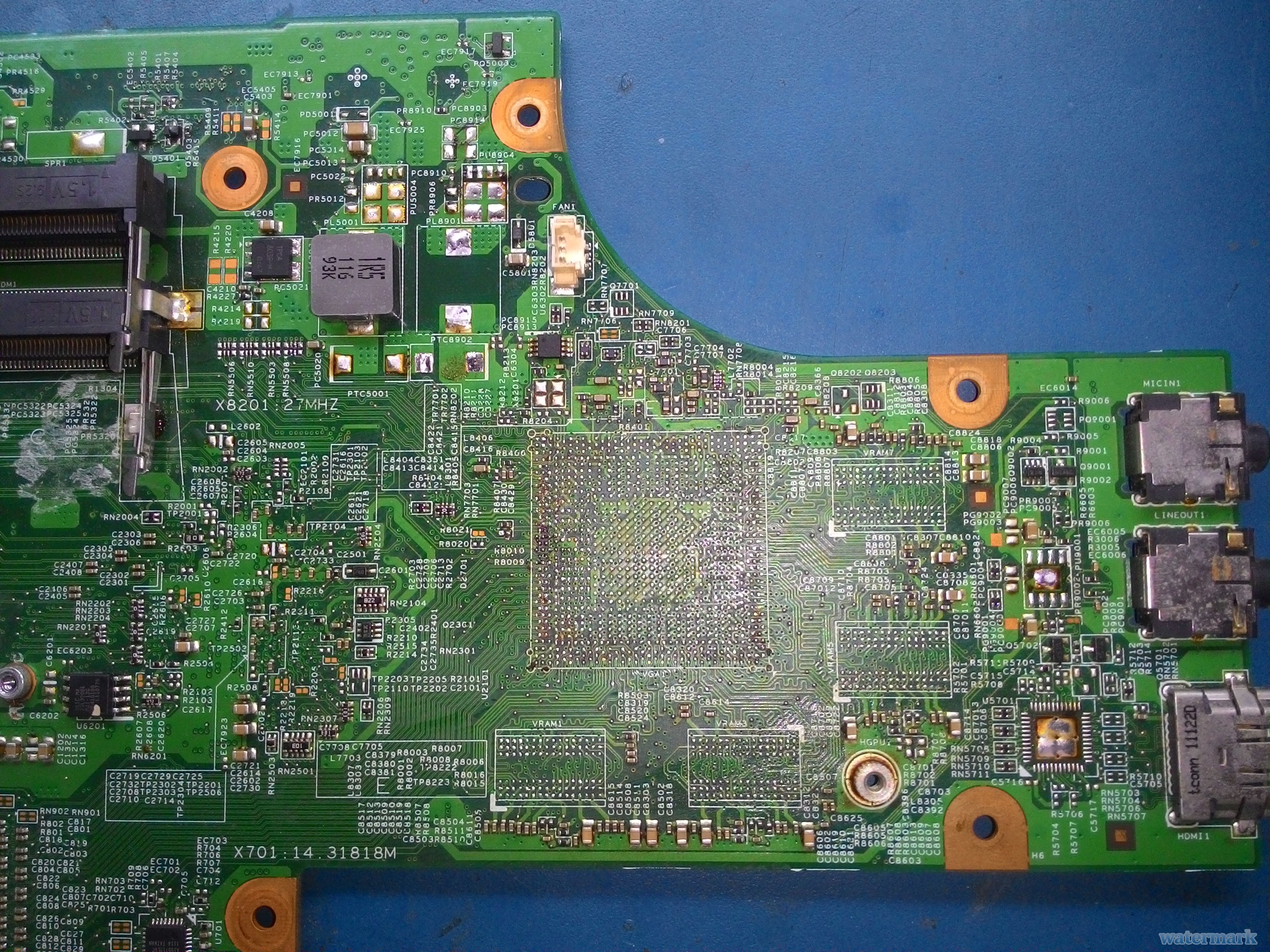

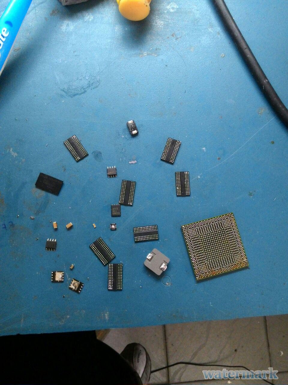

Case Study
Dell N5010
problem no display
checking laptop motherboard bga rebolling other person

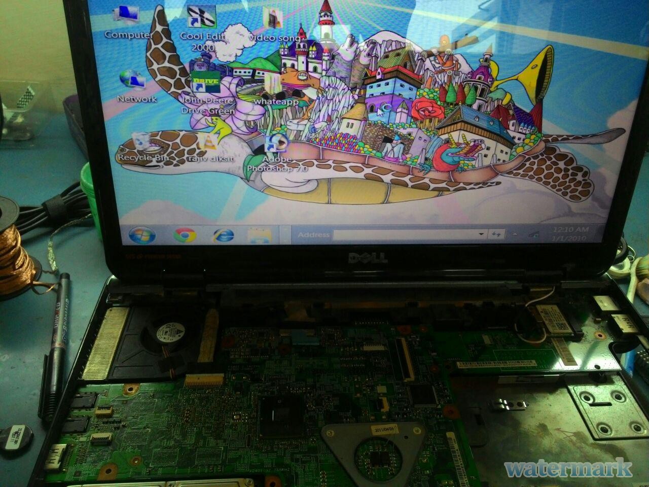

I am Graphics to Non Graphics conversion
laptop working fine

good but this pic methode...vga and hdmi not work....

Sir 4 vram near ATI chip this type board plain screen.no data.but 2 vram chip board convertion ok

I need to add one my personal thing that I use max don't I use GPU fx supply to CPU fx make jump from GPU supply to CPU supply my max prob solved nd now I converted around 50 MB on it
