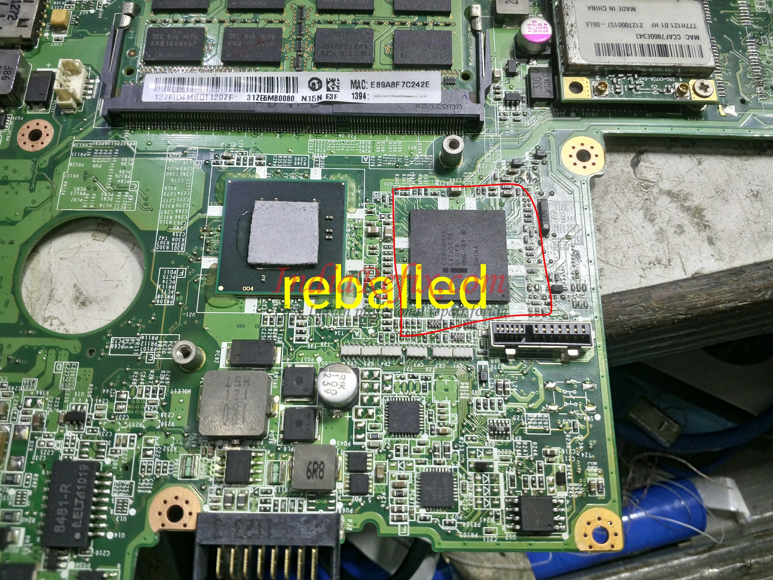

Acer aspire one D257
not switching on all volt present like + 3.3 ,+5 volt and switching volt also ok
Done bios same
After that done cg82nm10 reballed
And job done it's running fine now
