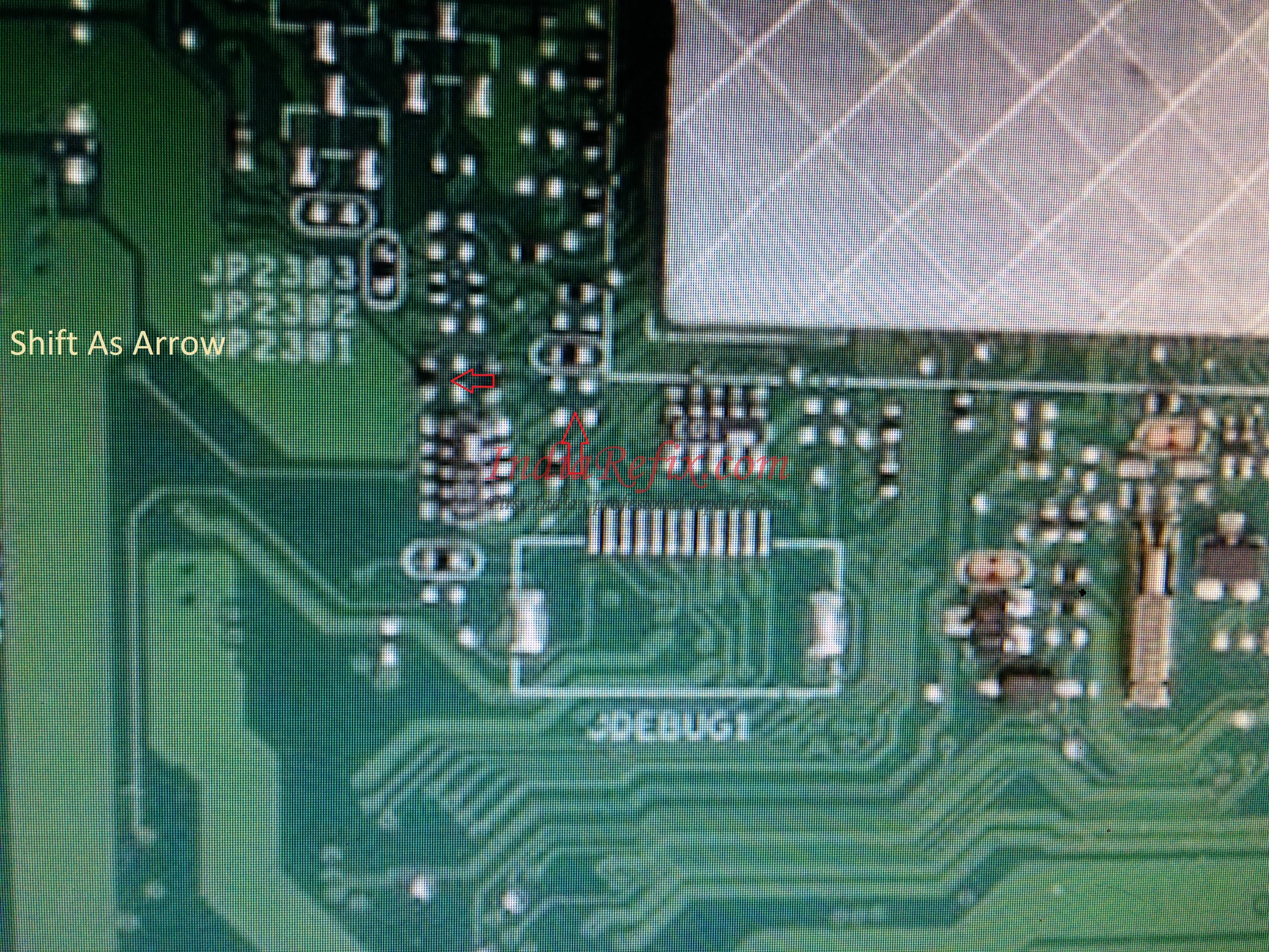

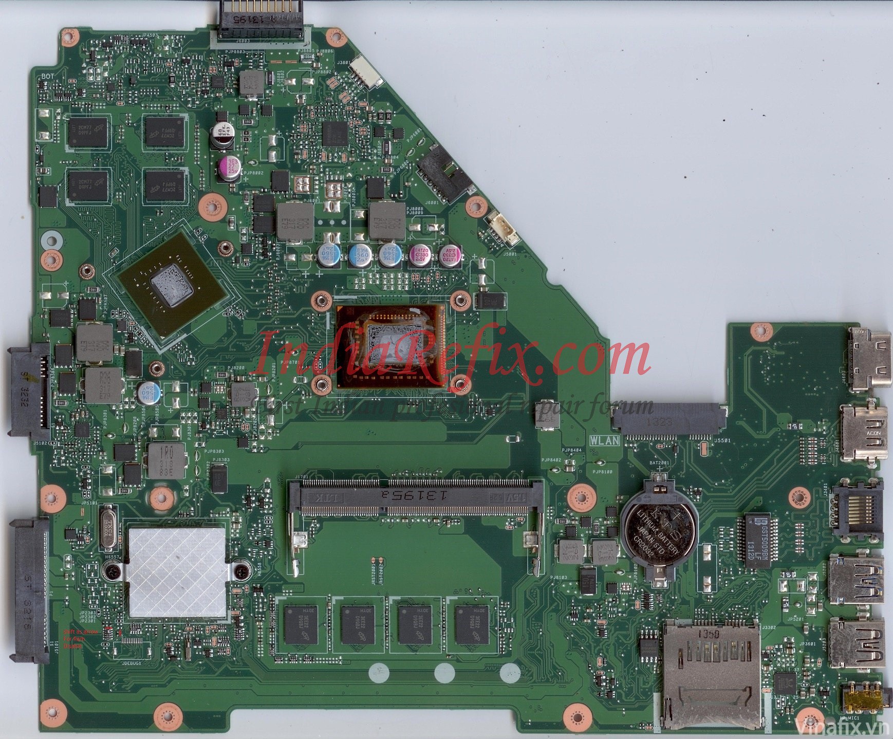

Useful when ram chip short or heats in such case remove on board ram chip and enable Ram slot..
If On board ram chip are dry and lines appear on screen then this Job can be done with Bios Change may searched on WEB
