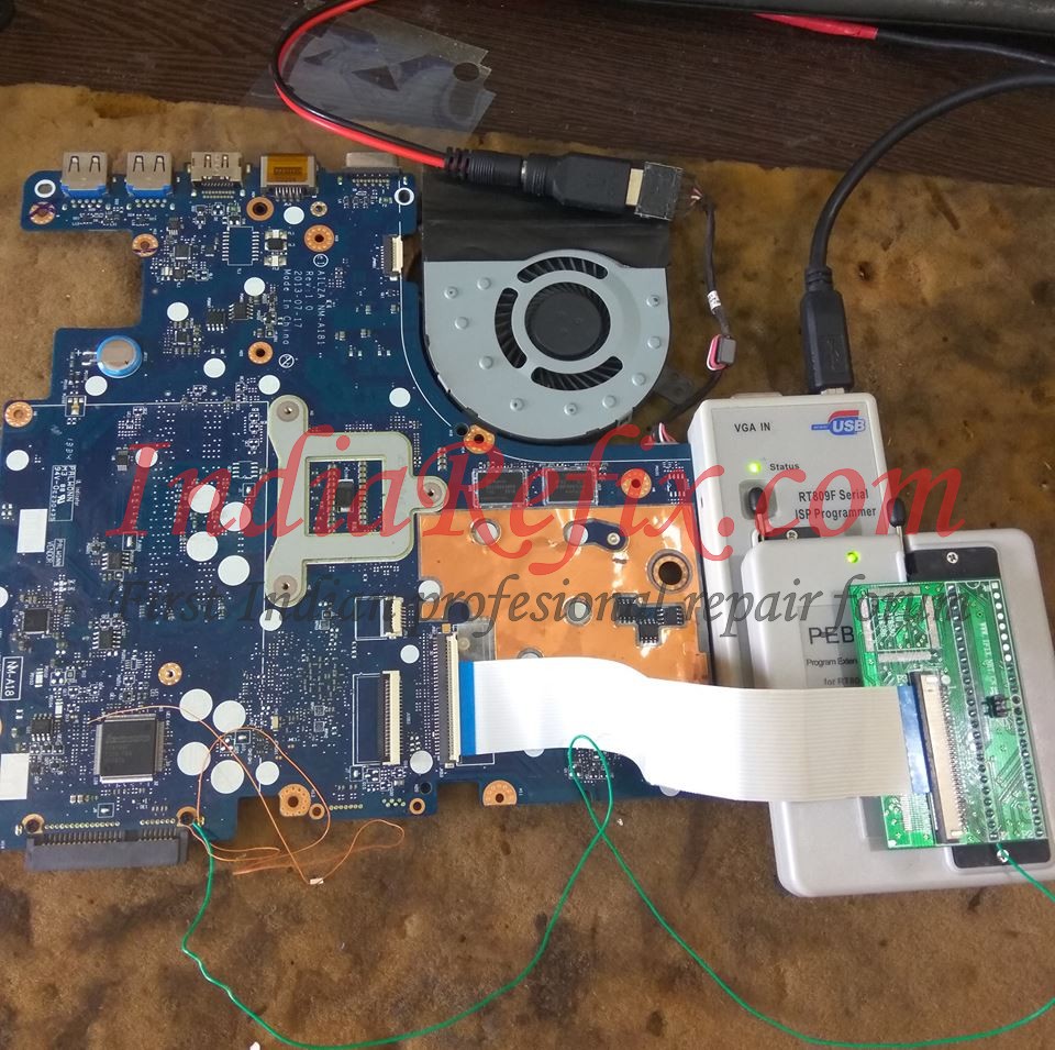

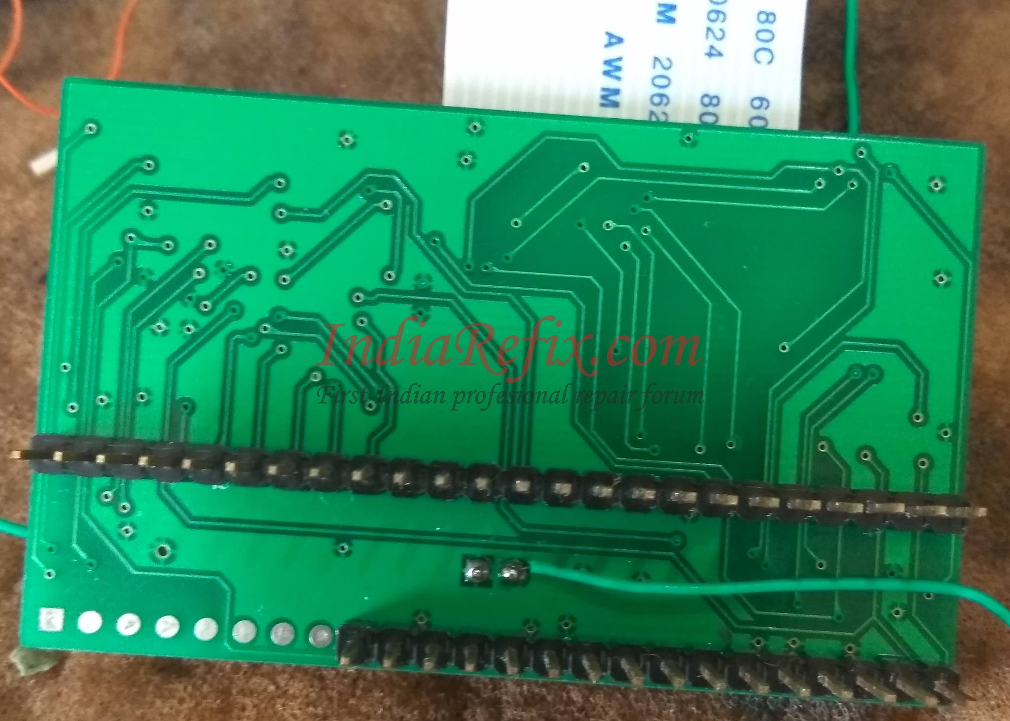

Solder one wire to Grond on Peb1 Connection Board and Laptop Mother Board
For ITE 8586 and ITE 8587 Pin 100 Must Connect to Ground
Connect 24 line Cable on PEB1 board pin 1 to 24 and same in Mother board (1 to 24)

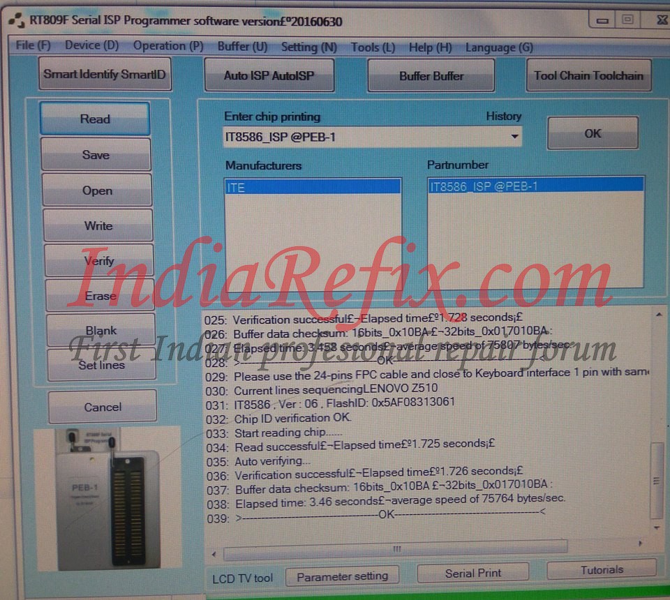

Run RT809F Software

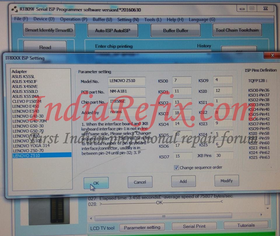

Select ITE8556_ISP@PEB1
Then click on SETLINES (if ur MB is already listed the select it Other wise Create new one as per Pin Configuration)
All these steps Ok
then clcik on read button after click on read button connect Power to Mother Board It will Start reading. Now U can also write new bios to the Chip.
