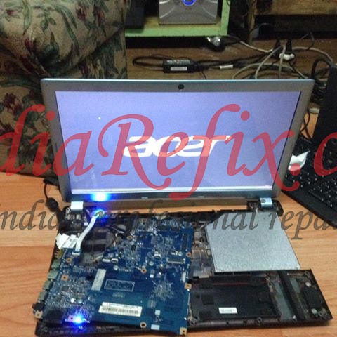

Acer V5-571G Shutting down in 2 seconds
Post by ronmay13 »
Acer V5-571G
Shutting Down After 2 Seconds. No Display
Check all Coil. No short
When Ram is Seated the Problem Occur
No Ram- Not shutting Down
Replace Ram. No Good
Checked 1.5 Ram Supply Line All Good
Bios Flash
Works Like a Charm.
Problem Fixed
i will Attach the working dump in another post :)
