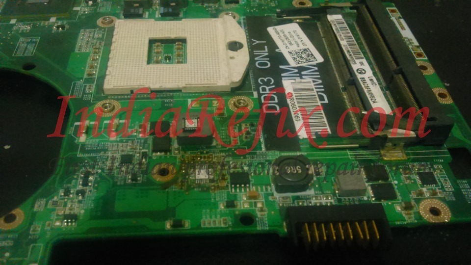

Dell inspiron 1464
Problem... Not charging the battery
On a BIOS it's showing none

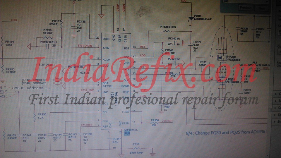

I checked PSID Signal 3v ok
On a SIO PS-ID 3V OK
All related resister capacitor Diode n via components r Ok
But shome time charging mosfet is showing shot with ground
Then trace the track charging IC showing shot pin no 20&21 LDO dlo short I checked all related components Ok finally I replace the charging ic problem solve........
