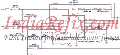

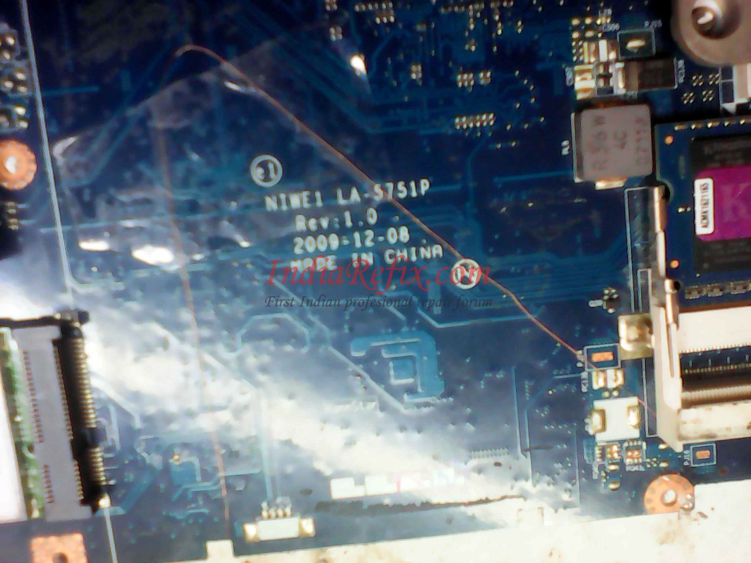

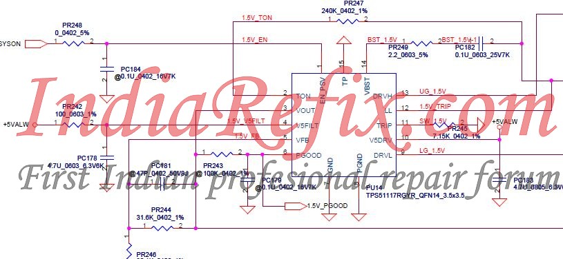

BOARD: NIWE1 LA-5751P

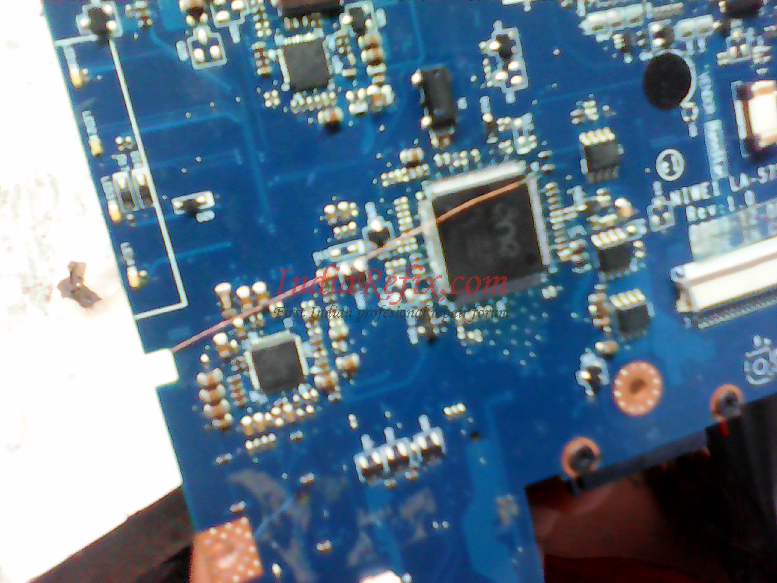

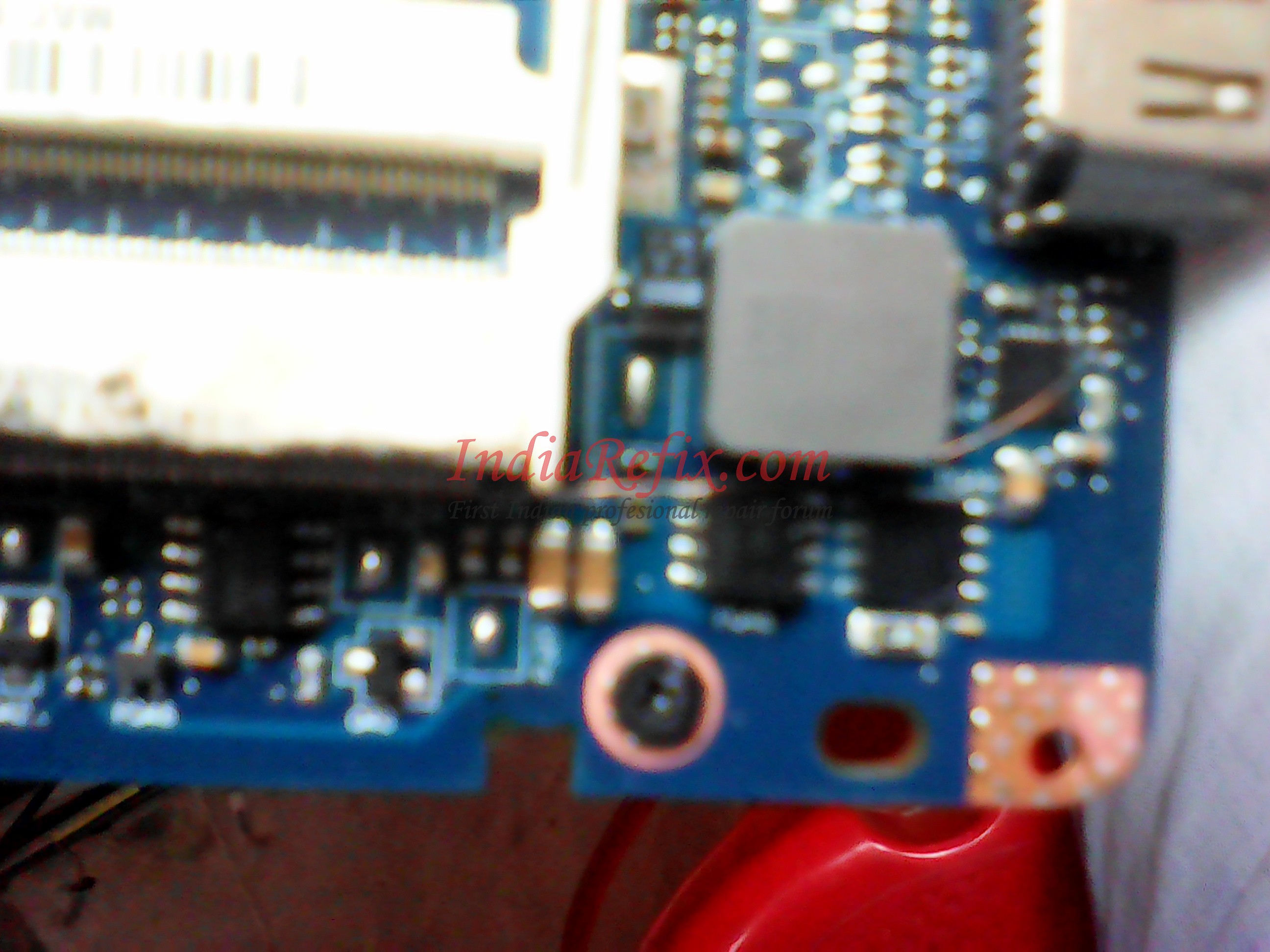

WHEN I PRESS POWER BUTTON LAPTOP GETTING SHUTDOWN IN FEW SECONDS.AFTER TRACE THE BOARD RAM IC SIGNAL VOLT MISSING.MAKE A JUMPER FORM IO.LAPTOP WORKING FINE.
