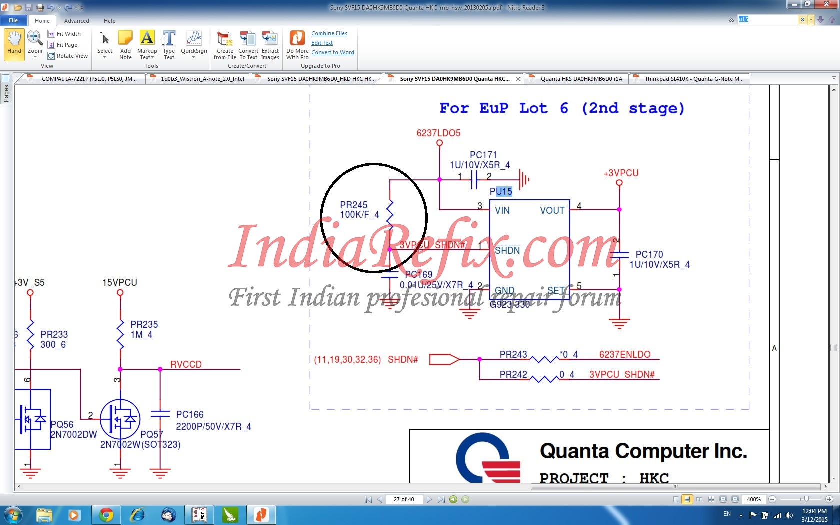

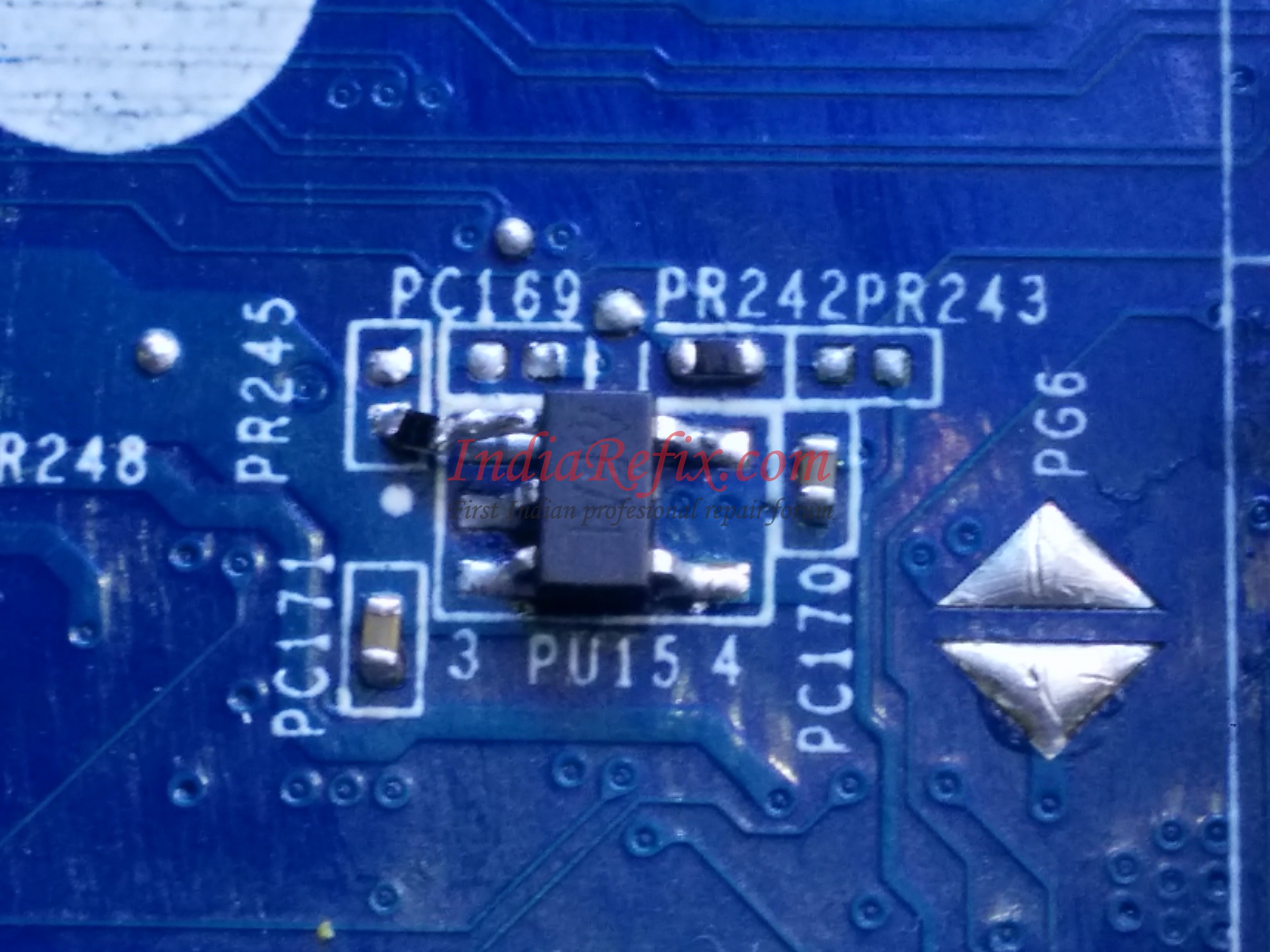

5 Volts to 3volts converter no out put due to black circled resistance failure

In this motherboard rtc/ldo supply initialize by this ic pu15 if this ic do not triggered then board seems no load in power supply.
