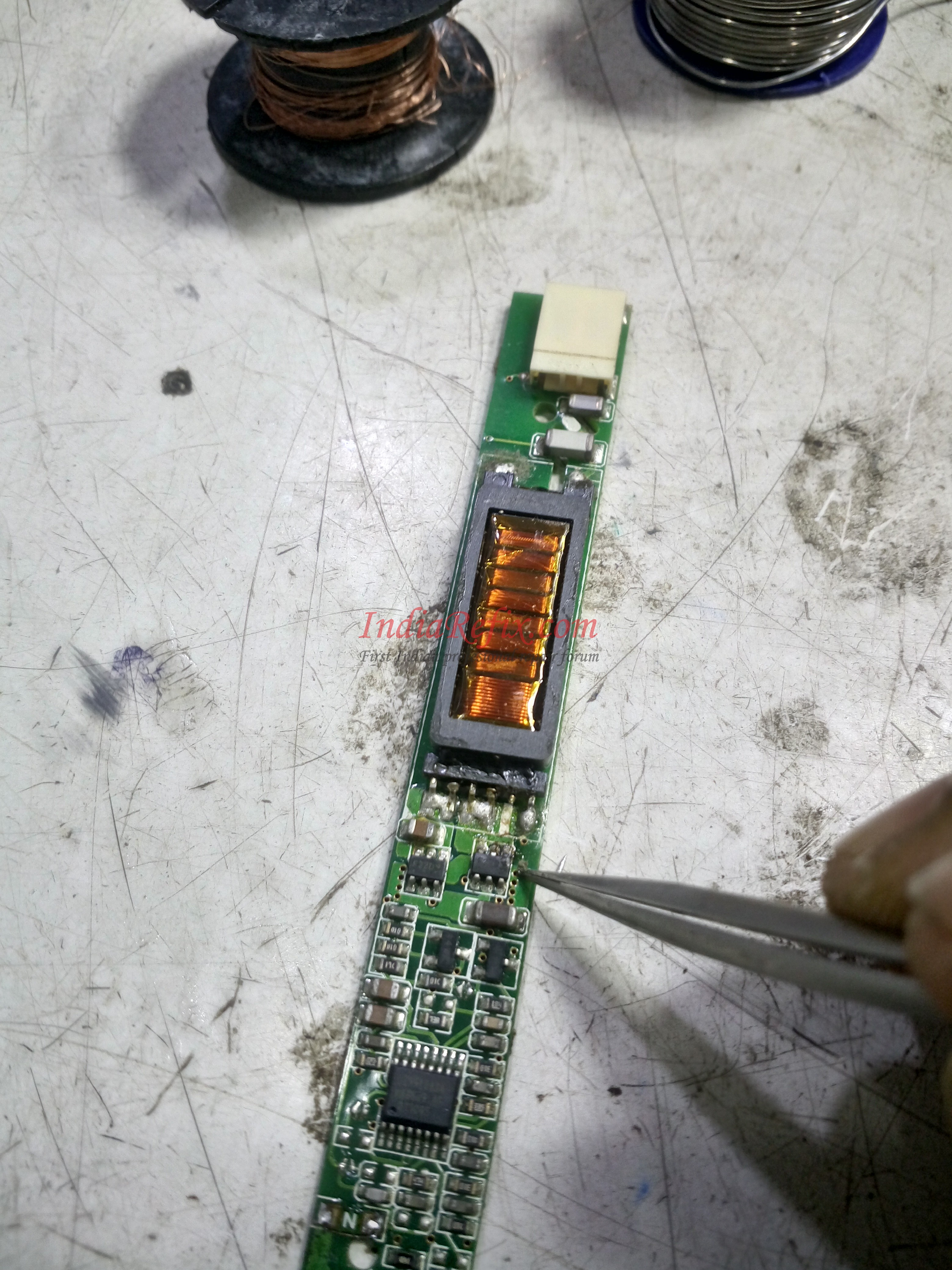

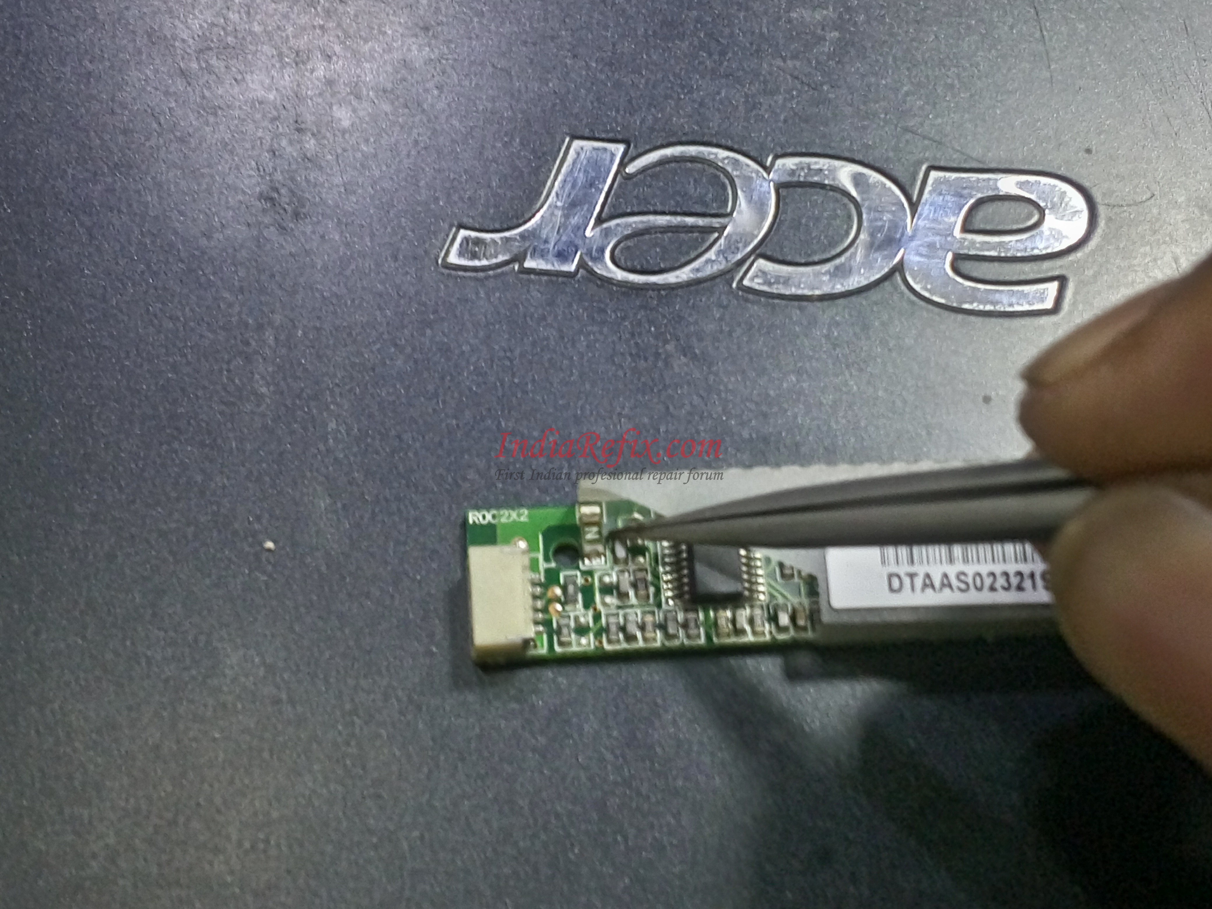

FUSE WAS CUT (PUT JUMPER ) AND ONE IC BURNED (CHANGED FROM SCARP FL)
