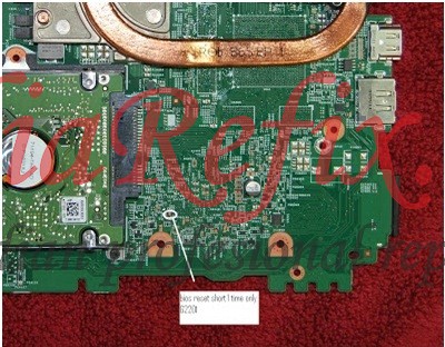

Reset Dell 15R-N5110 Bios
Add caption
1. remove motherboard from you laptop.
2. connect power and turn on.
3. short G2201 only one time.its shout down.
4. remove power and assemble your laptop again
5. Then go to bios by press F2.
note: This instructions for help only and for professionals only. general users do not try this.
Don't short G2201 two times or in even count.it will show you password prompt again.

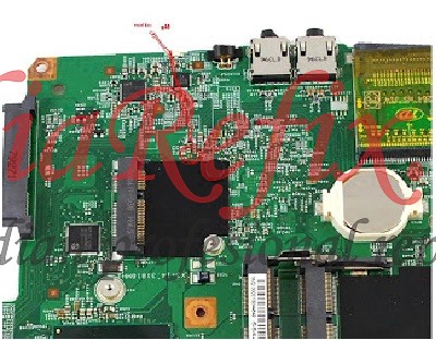

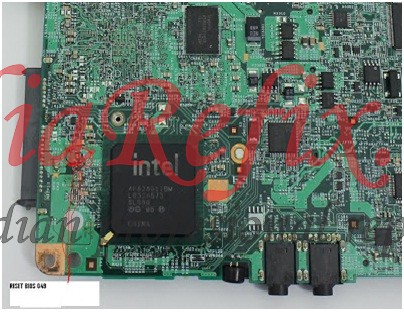

RESET DELL 1545 Bios
1545 mobo with Graphics
1545 without Graphics
3. short G49 only one time.its shout down.
1545 without graphics can be reset only to remove wifi cover.
Don't short G49 two times or in even count.it will show you password prompt again.
