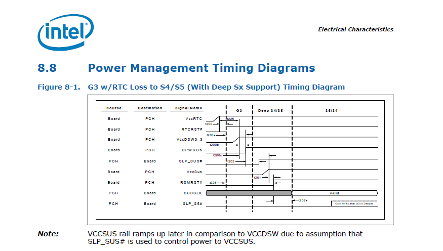

Good Post, but it is better to read PCH datasheet, complete timing diagrams and power sequences are detailed in PCH datasheet and these are freely available for download from Intel.
Attached you will find typical timing diagram taken from 9 series intel PCH datasheet. Keep reading and enjoy..
