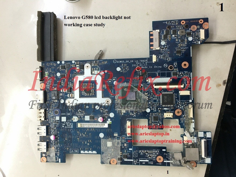

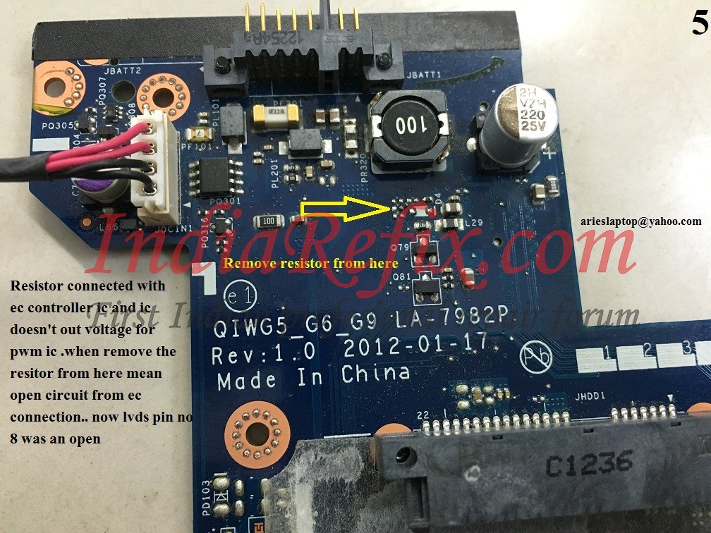

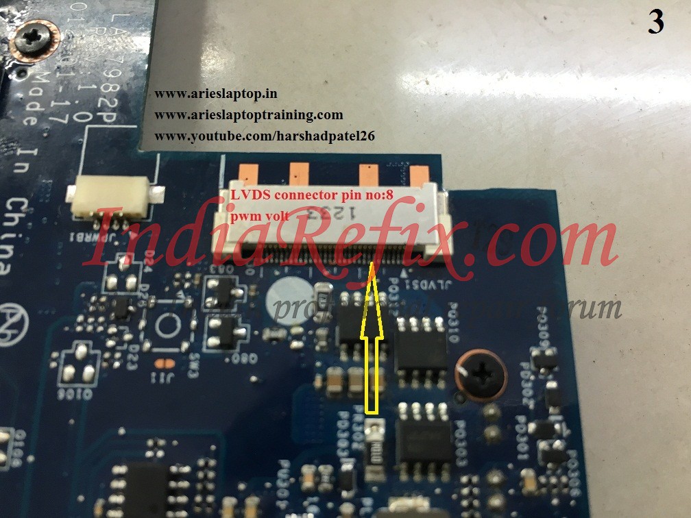

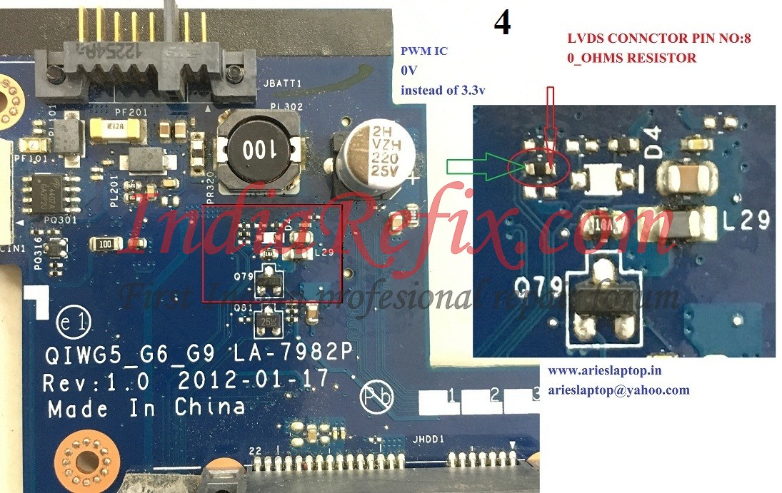

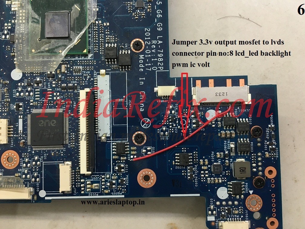

Today's Case study

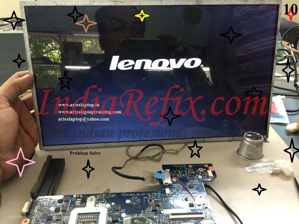

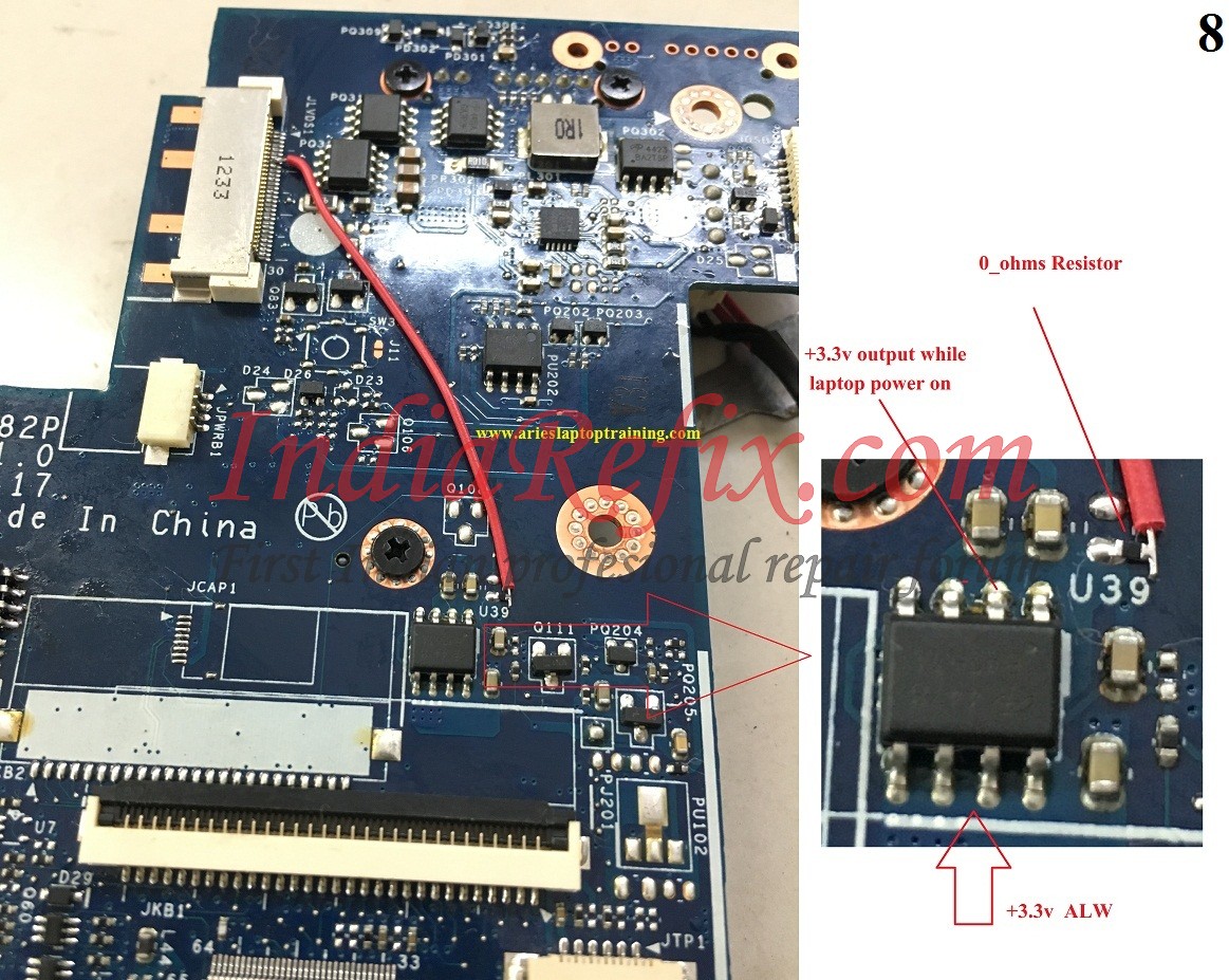

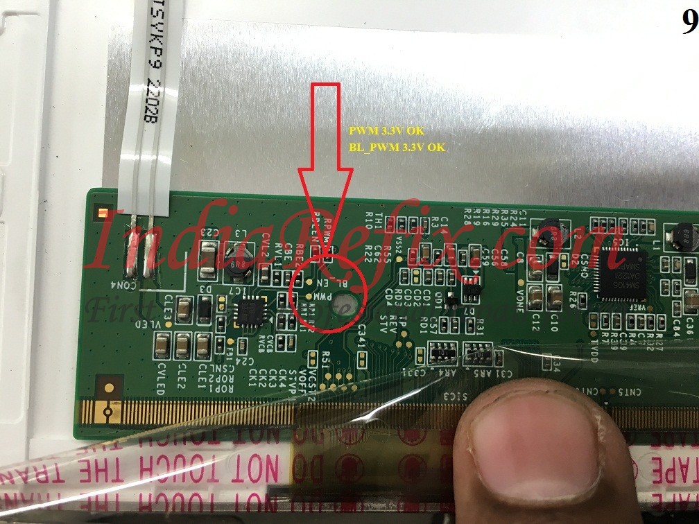

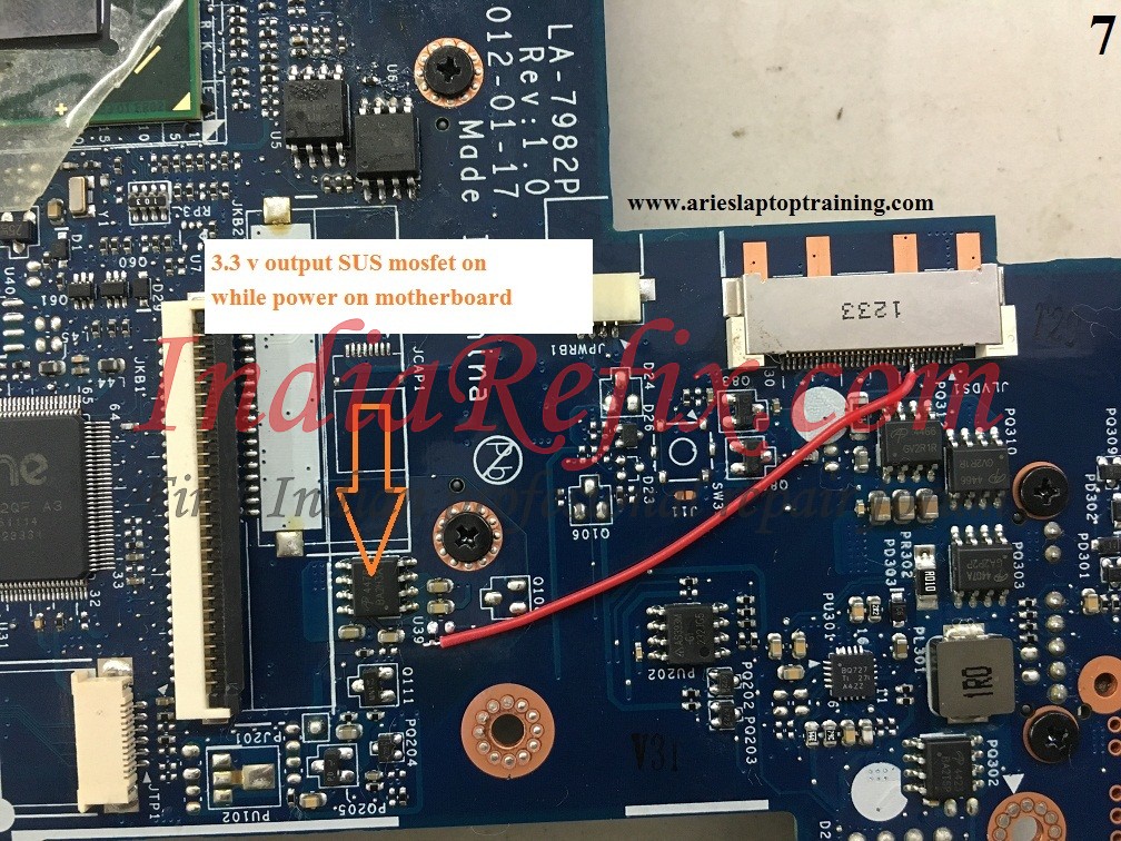

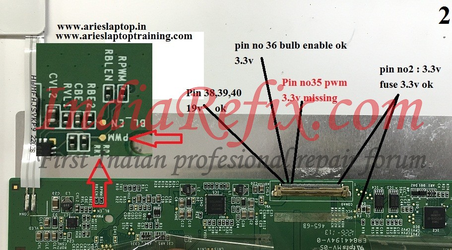

Problem : Lenovo G580 backlight not working
Solution: lcd pwm ic 3.3v missing jumper it from 3.3v output mosfet
