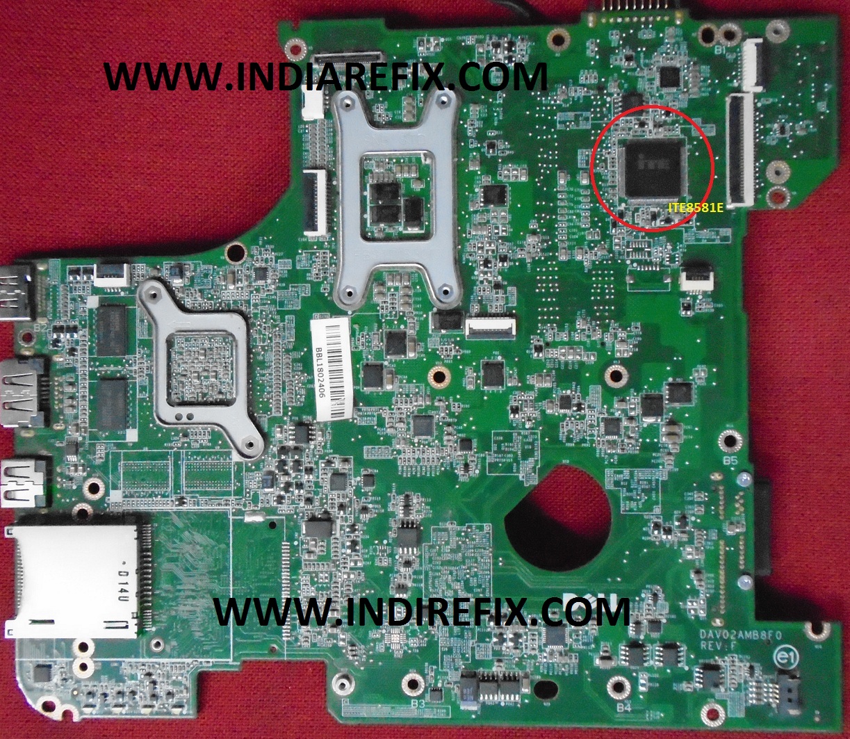

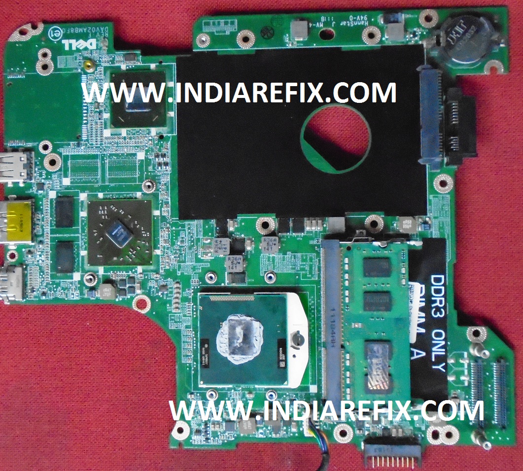

Make/Model- Dell Insprion N4110
Motherboard Part No-DAV02AMB8F0
Processor Type-I3 2ND GEN
Ram Type –DDR3
Problem –Display Ok Auto Off
Diagnosis-I/O Controller Faulty
Process-
Coming Dell Insprion N4110 Laptop and Problem Is Display Coming and Auto off after 4 second open laptop and found I/O(ITE 8518E) rusted and track damaged pin 27,28,29,30. Repair track and changed i/o .after repair track and i/o problem solved..
