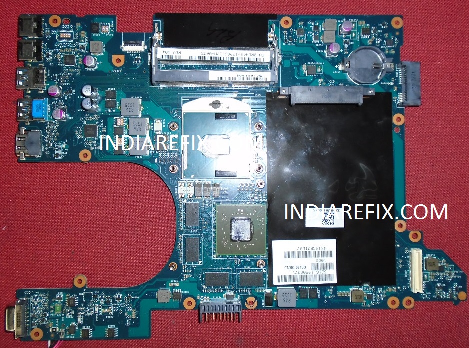

Dell Insprion 5520 Dead
Motherboard Part No-QCL00 LA-8241P Rev-1.0
Problem- Dead

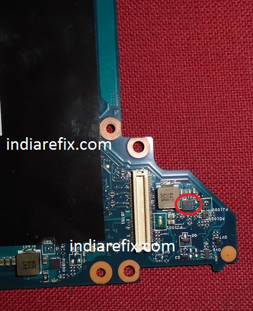

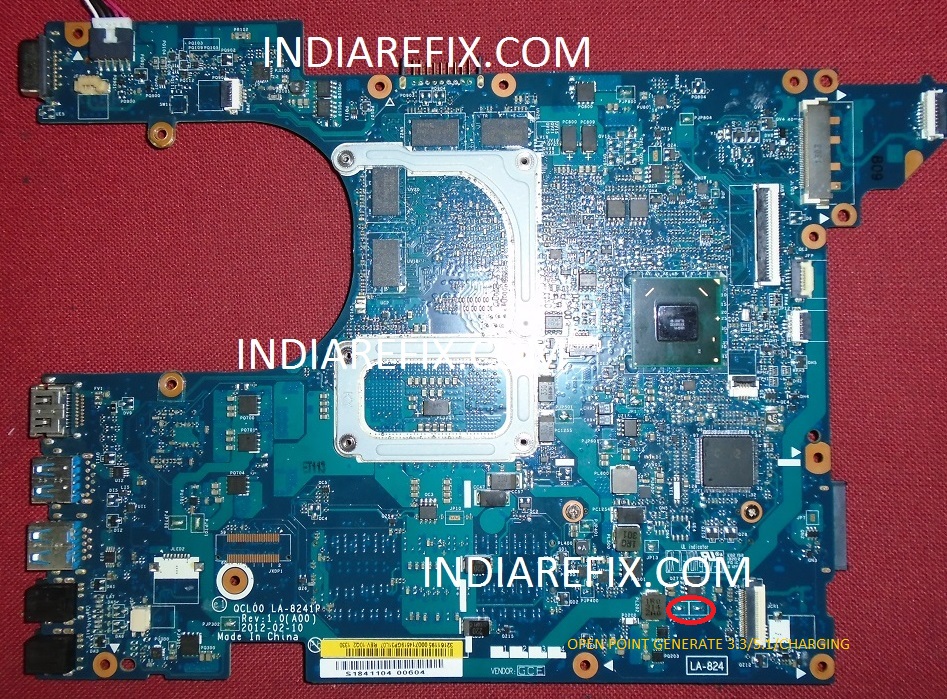

Diagnosis- Found 3.3v line shorting
Process-
+19V Working
Charging Voltage Not Working
StepDown Voltage Not Working
Found Problem 3.3V Line shorting Remove shorting (PU1000 Replaced ) problem solved

sir plz post pic for clear understanding....thanks
yashan
Joined: Thu Dec 10, 2015 9:09 pm
Re: Dell Insprion 5520 No Display
Post by yashan »
Good sir ji per short kya tha sir plz tell with pic if possible
yashan wrote:Good sir ji per short kya tha sir plz tell with pic if possible
pic uploaded
