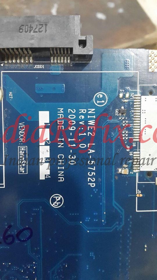

Case Study Lenovo Z560 (LA-5752P)[glow=red]
[/glow]
Problem: No Display. laptop on and it's take .65 ampior
Diagnose Found 3.3 Output Coil Showing Low value .44 ohms with beep it's shorting on 3.3 volt coil
Solution: Use DC Power supply and found shorting Got IO Faulty Change io Now Display ok........
