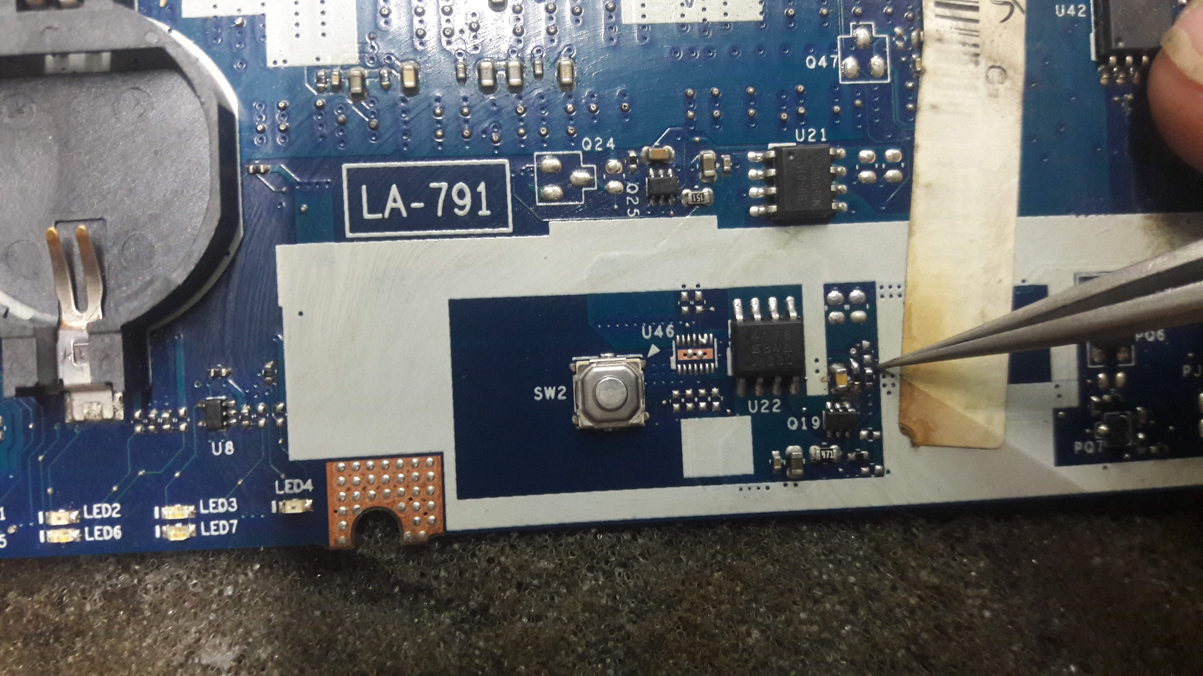

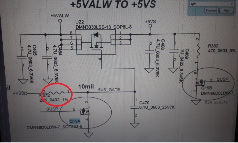

Acer La-7912p
Power on no display
No vcore
All other other voltages present
amps was 0.200
Fount 5vs voltage was low only 2.3v due to R372 20k reg was miissing and track of reg was also missing
place Reg of 20k and build solder pad for it
system is fine now
