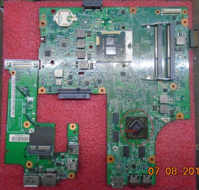

Description: Dell Insprion N5010 No Display Continues 3 beep sound Replace ATI Chip Problem Solved
Make/Model: Dell Insprion N5010
Motherboard Part No: DG15 MB 48.4HH01.011
Processor Type: I5 First generation
Ram Type: DDR3
Keyboard Controller: NPCE781BA0DX
Problem: No Display 3 beep sound
Diagnosis: Processor Power Supply and ATI Faulty
Process:

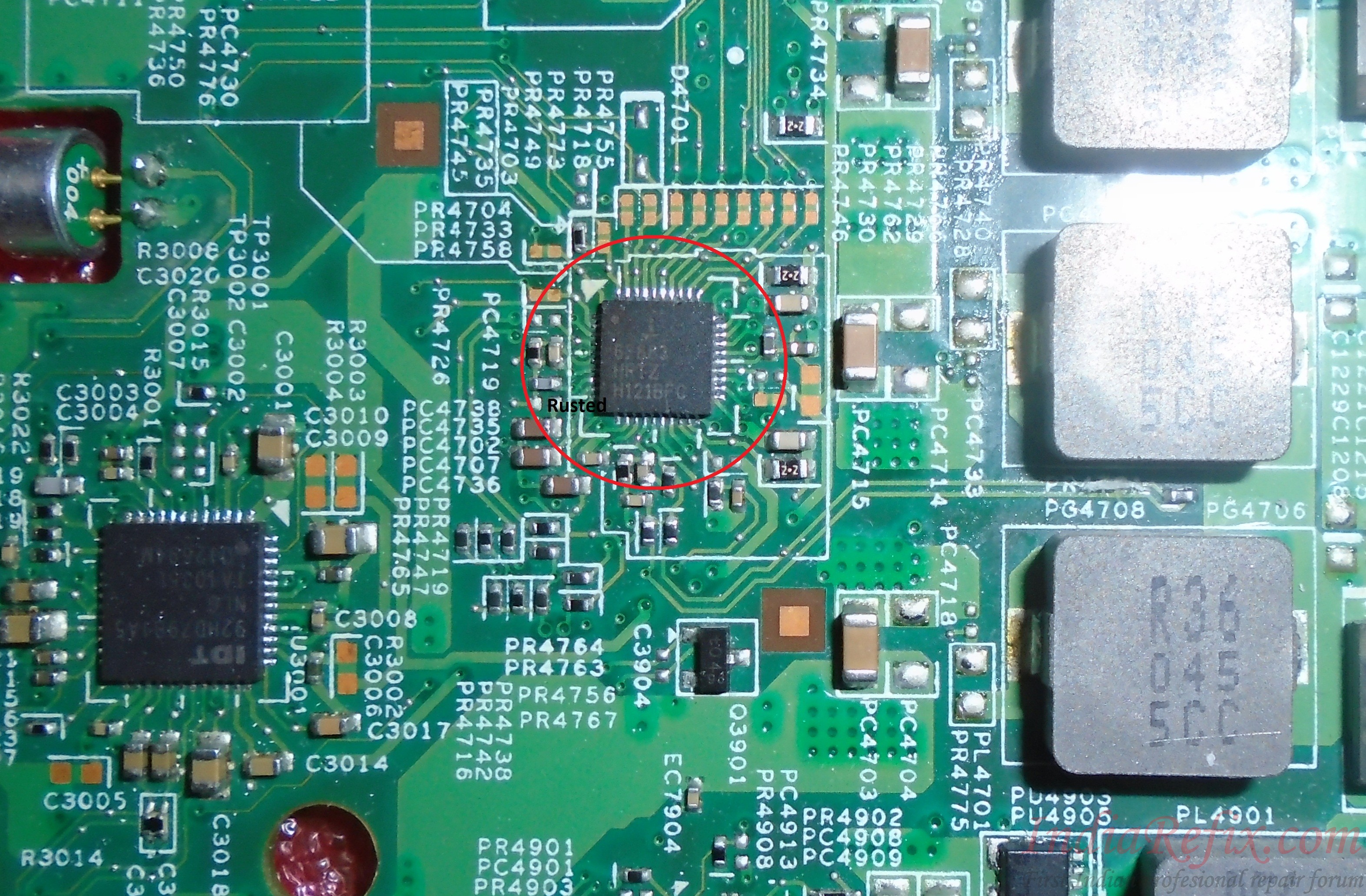

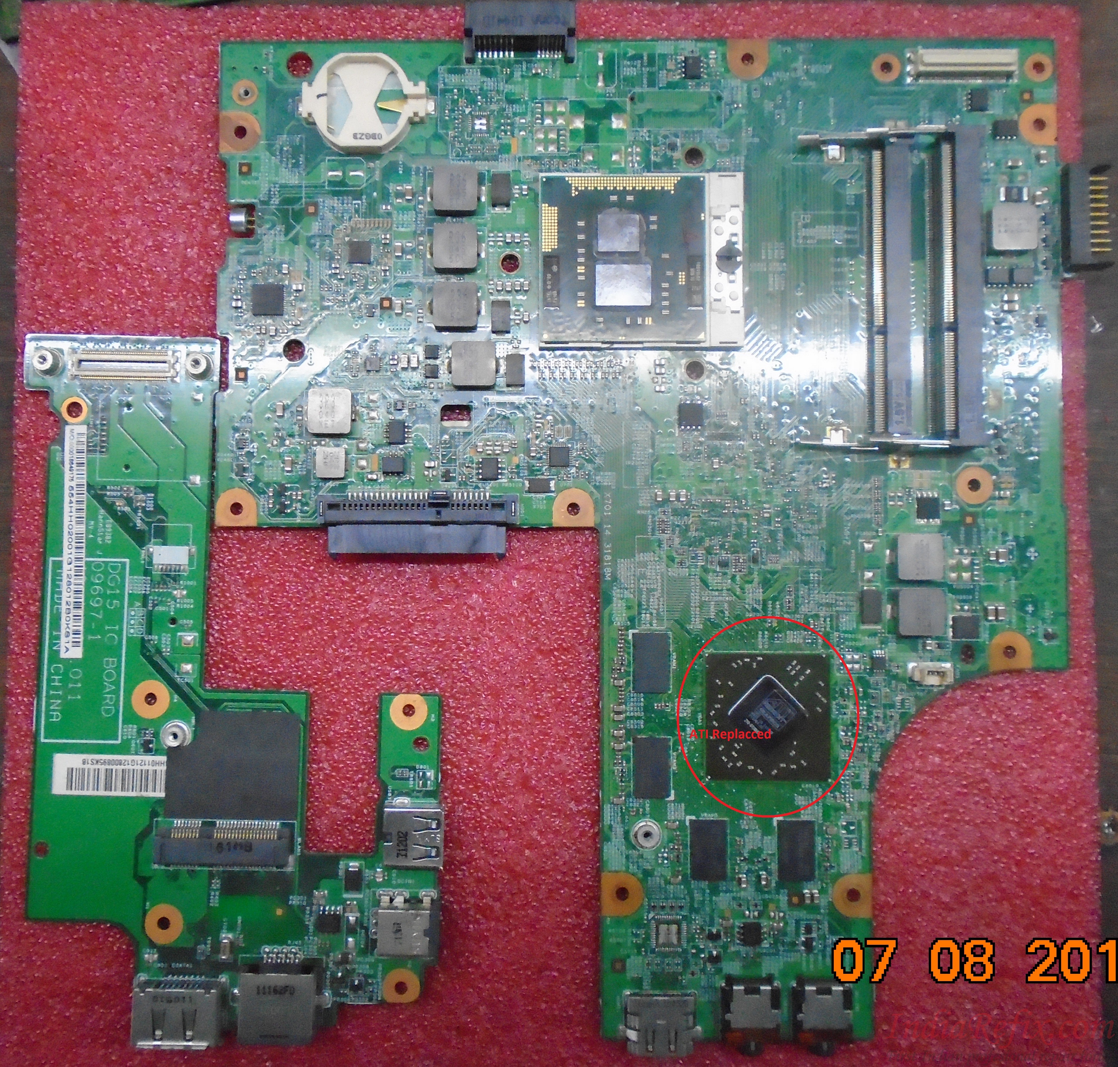

Dell Insprion N5010 Laptop No Display And Continues 3 beep sound open laptop and found Motherboard DG15 MB 48.4HH01.011 , after clean motherboard found near PU4701 ( ISL62883HRTZ) Rusted after clear rusted ic coming Display But Water Very Bad luck this display coming without ram and Processor , Then Check Found VGA1 (ATI 216-0729042) Overheating after replace VGA1 IC display coming proper , then Laptop Work Proper
