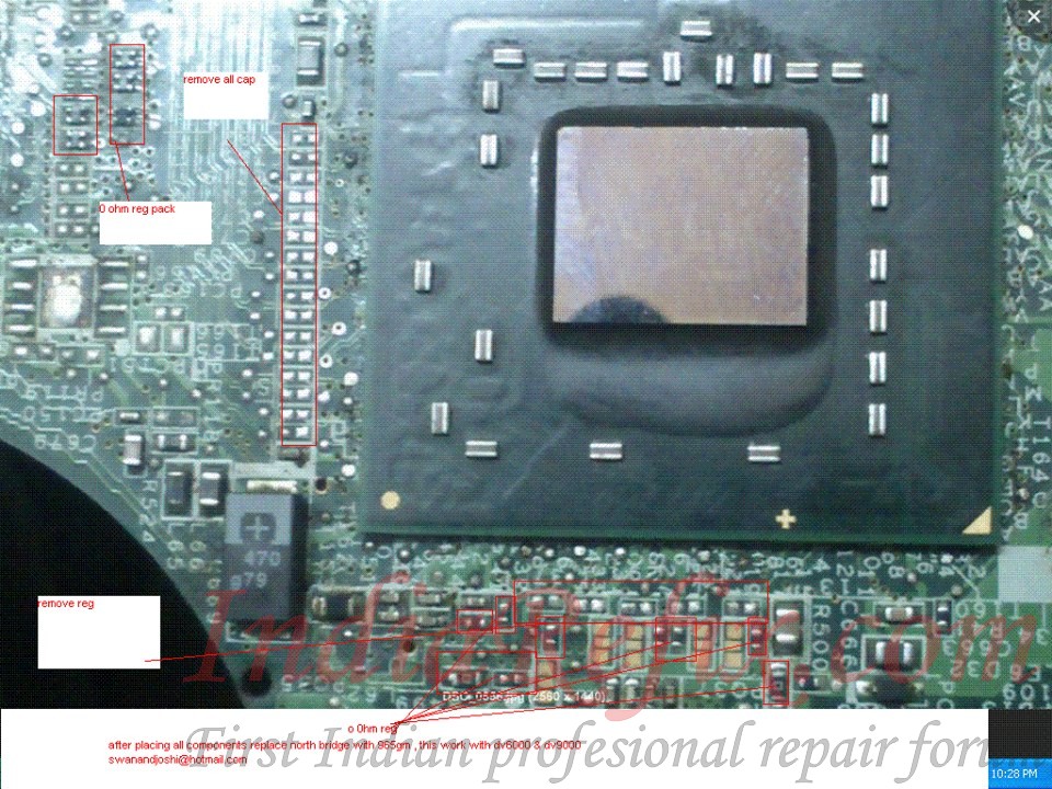

dv6000 convert to no graphics
Post by ravichouhan »
AFTER CHANG ALL RESISTENCE. CHANG NORTH BRIDG AND PUT 45GM
