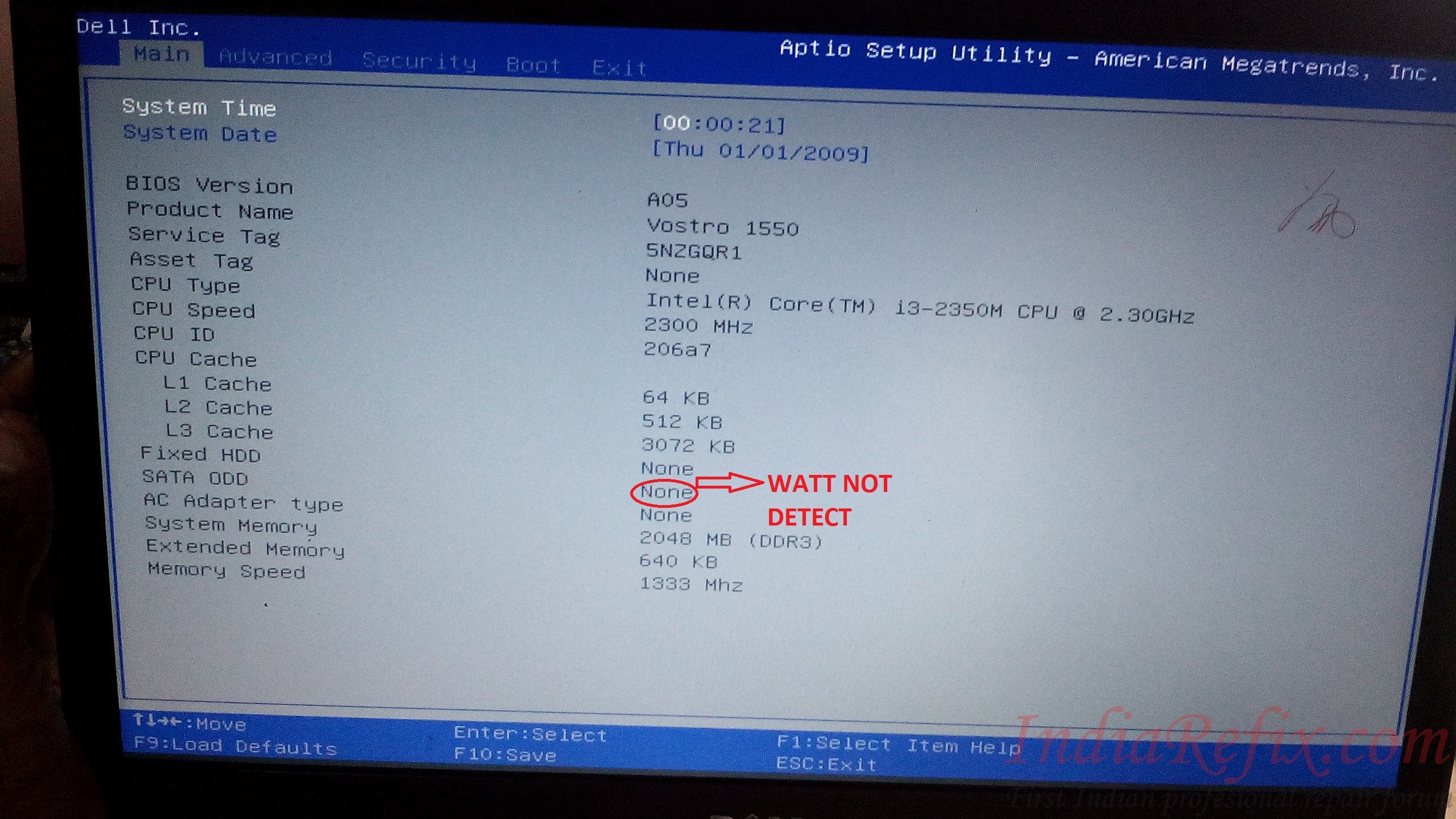

BATTERY NOT CHARGING ADAPTER WATTAGE CANT DETECT
M/B- DV15 HR
CHECKED WITH OTHER BATTERY AND DELL ORIGINAL 65/90W ADAPTER ALSO NOT DETECT THE WATTAGE

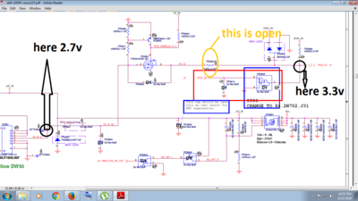

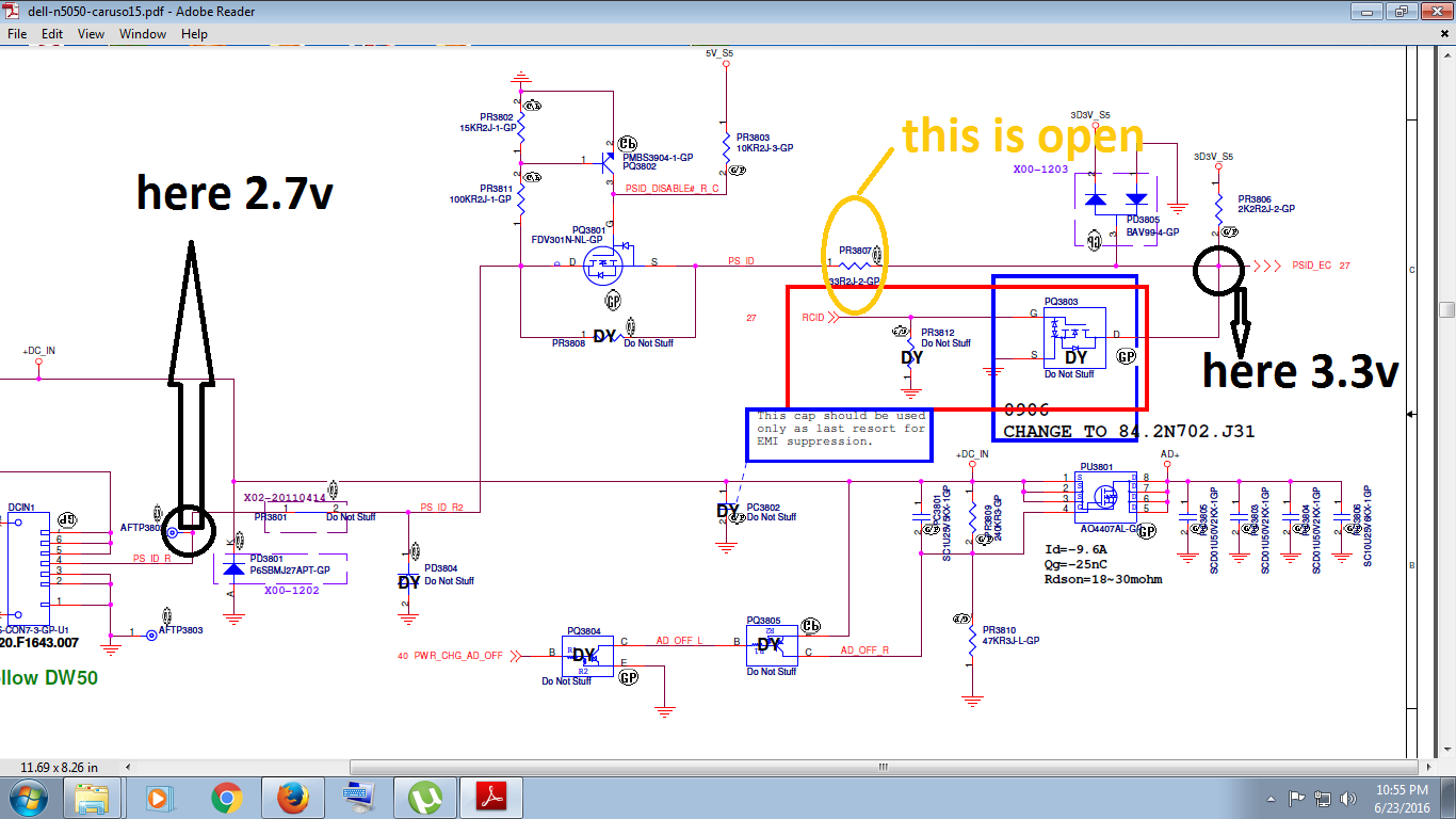

SO I AM GOING THOUGH SCHEMATICS FOR ADAPTER PS_ID VOLTAGE AND TRACK
FOUND 2.7 V IN DC JACK PS_ID PIN
CHECKED AND FOUND PS_ID EC VOLTAGE IS OK 3.3V PR3806
SO I AM CONFIRM MAY BE SOME RESISTOR OR TRACK BURN

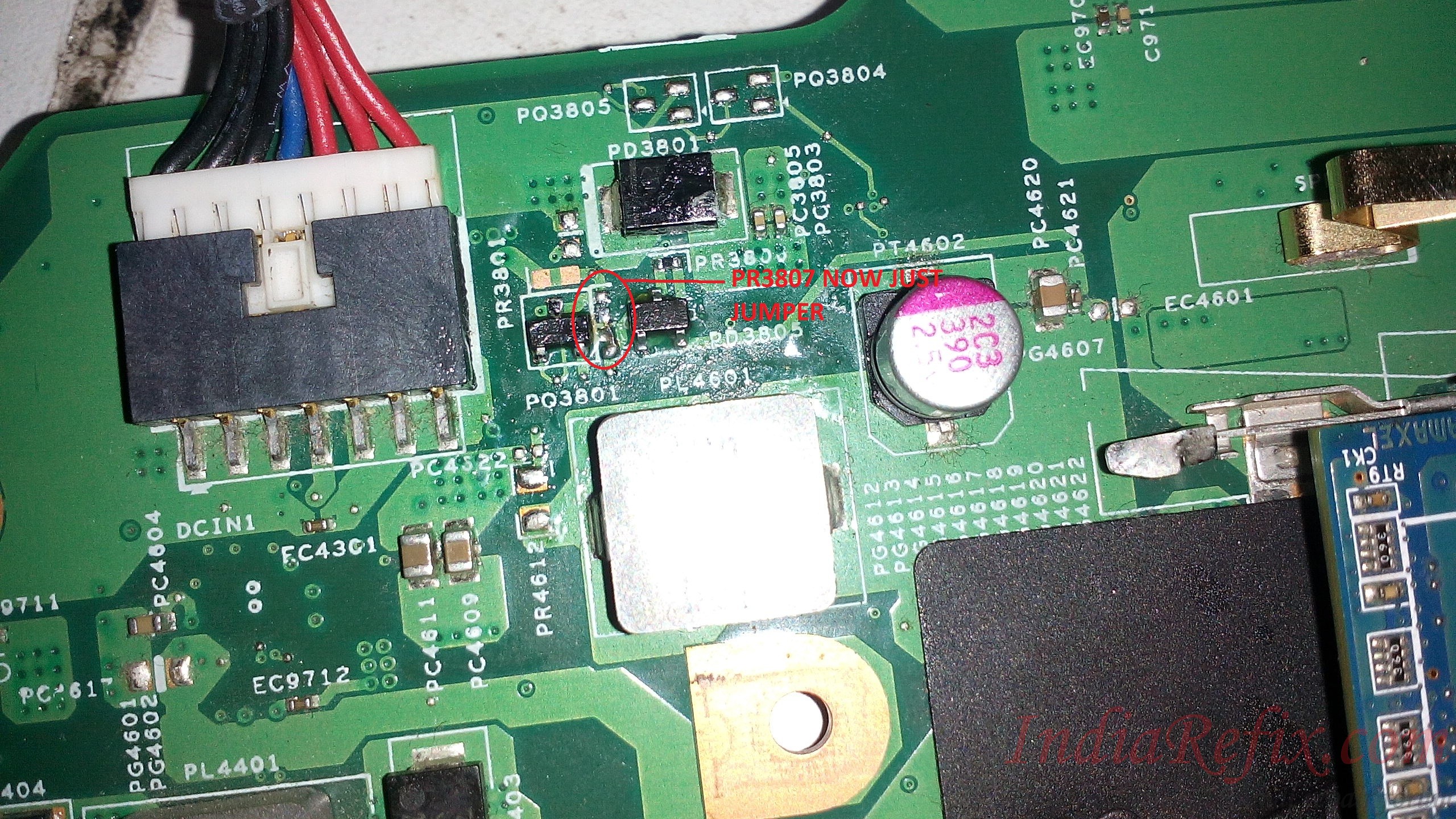

CHECKED ONE BY ONE AND FOUND PR3807 IN BETWEEN PS_ID AND PSID_EC IS BURN
THIS IS 33OHM SO THAT I JUST JUMPER IT AND GETTING 3.3V IN PS_ID PIN NEAR DC JACK IN

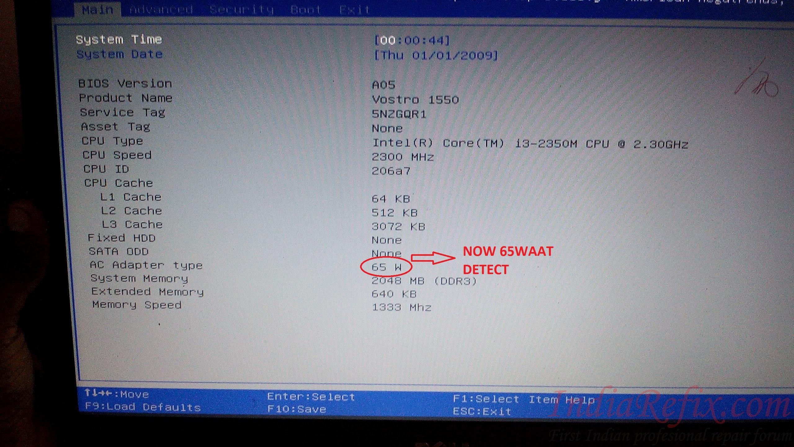

NOW DELL 65W DETECT IN BIOS AND BATTERY ALSO CHARGED PROPERLY
NOW PROBLEM RESOVED AND BOARD WORKING FINE
NOW DELL ADAPTER 65W DETECT
JUST REMOVE PR3807 AND PUT A JUMPEER ONLY
DV 15 HR SCHEMATICS FOR AD PS_ID DETAILS

DELL ADAPTER NOT DETECT WAATAGE (NONE)
