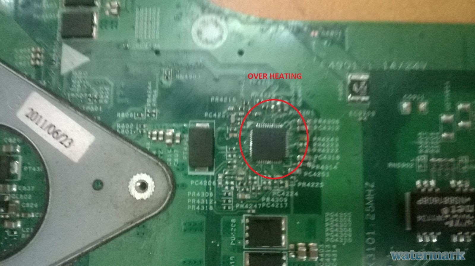

initial Check ...Found Core ISL95831 FRying UP HOT
Chenaged the Core IC ....but the same problem existed ..

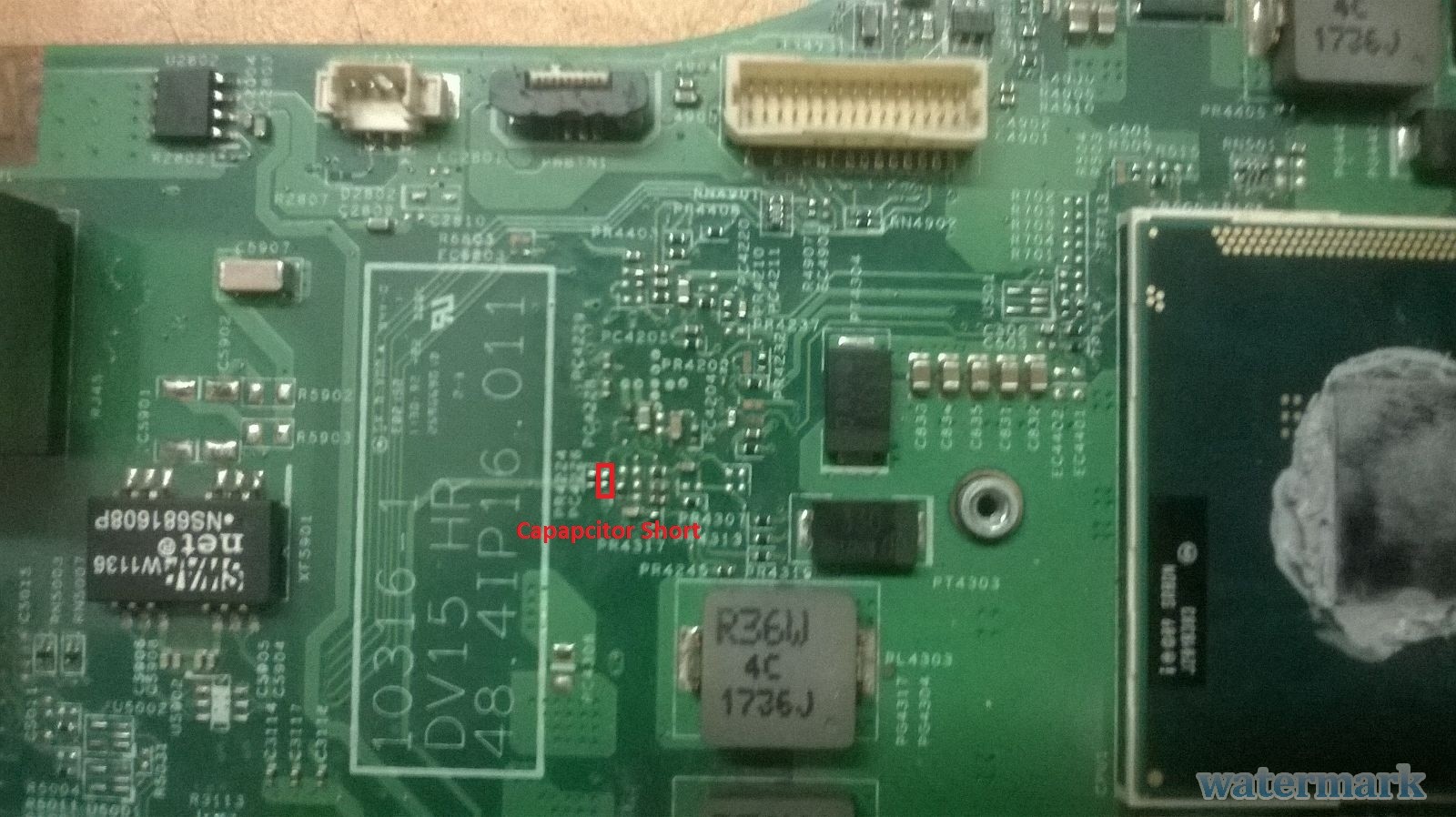

Then Found PC4226 Capacitor Short...
REplaced and
Problem Resolved ....
