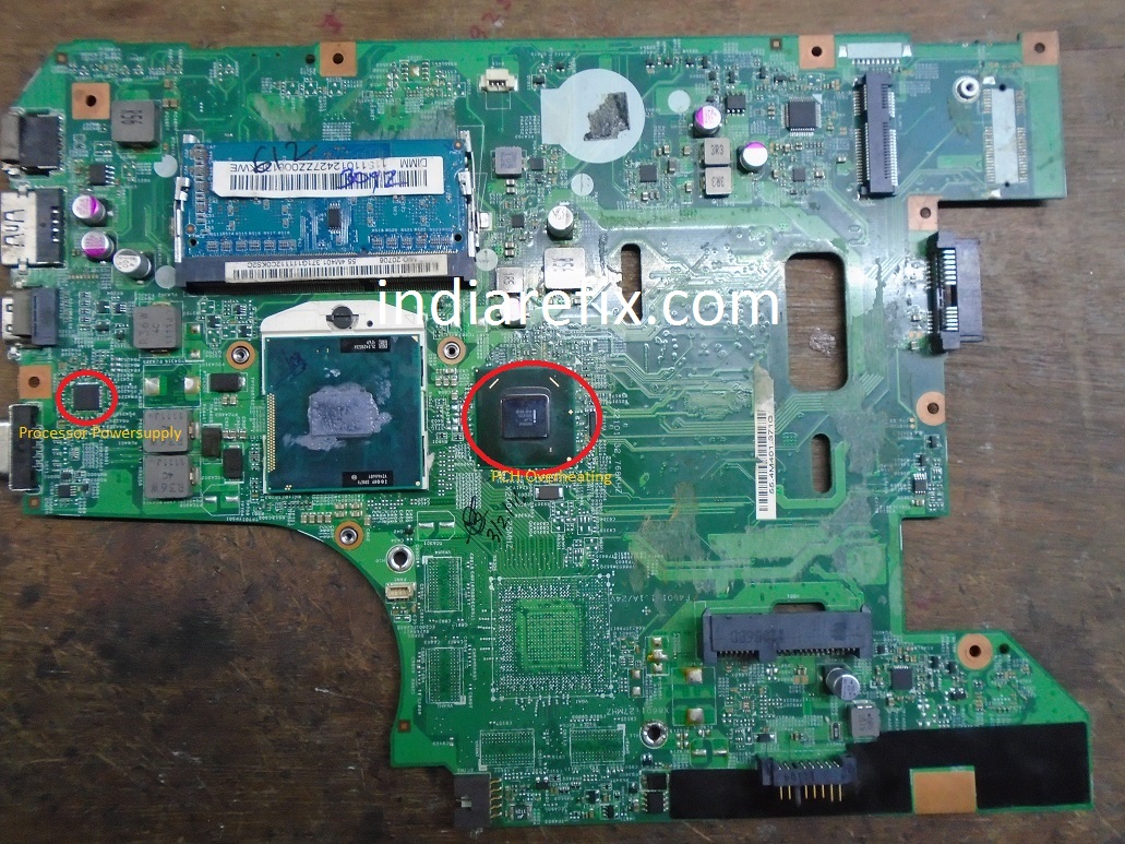

Motherboard Part No.LA57MB
Problem-Dead
Diagnosis-Found Processor Power supply / PCH / Bios Corrupt
Process-

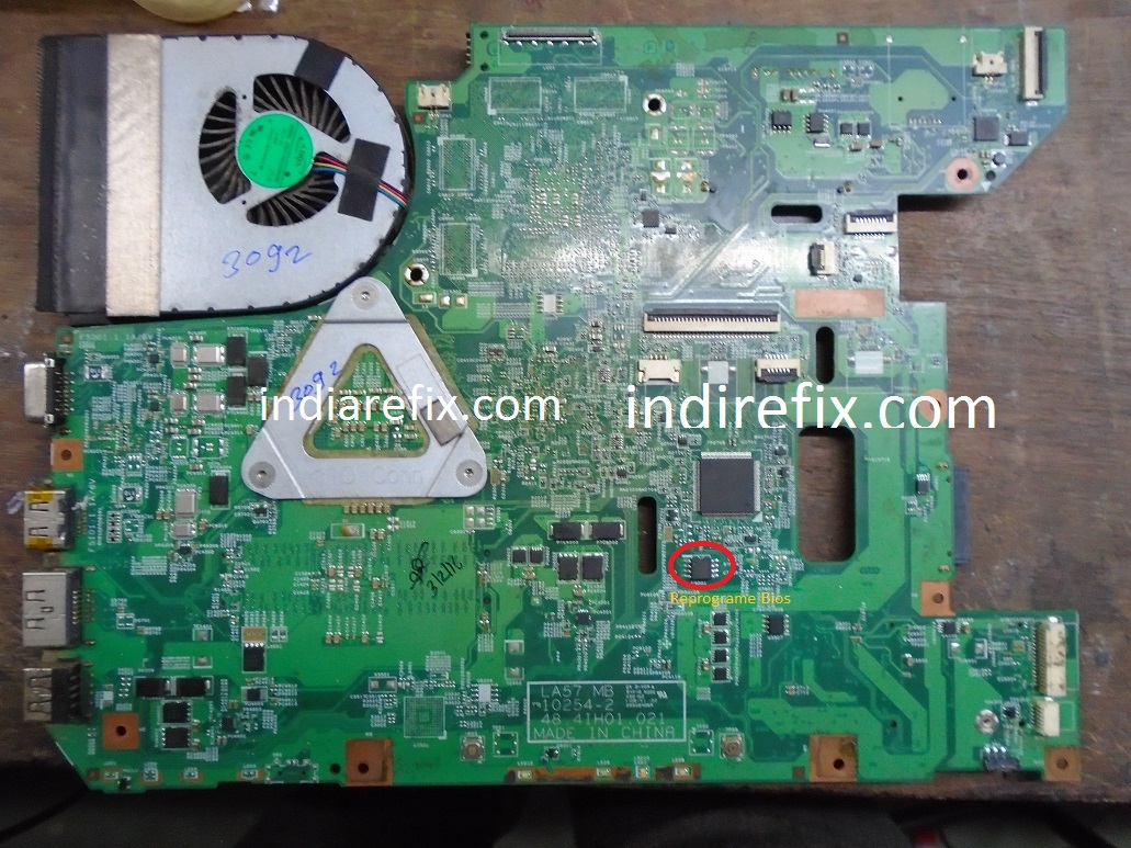

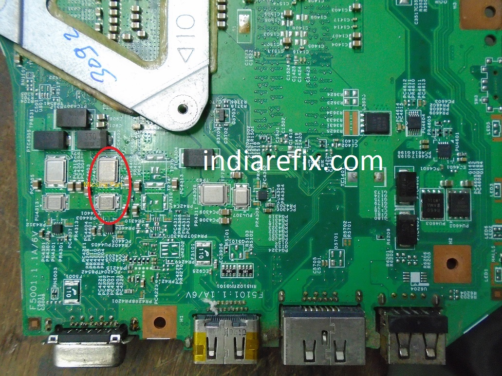

When Connect power Adapter Found PU4403and PU4401 Missing and Processor Power Supply Overheat(PU4201-NPC6131) After Replace Chip overheating off But Motherboard not powering on then Reprogram Bios Chip(U6001) after programming bios chip motherboard power on but no display then found PCH Overheat (BD82HM65 ) Change PCH And Found Problem Solved ...
