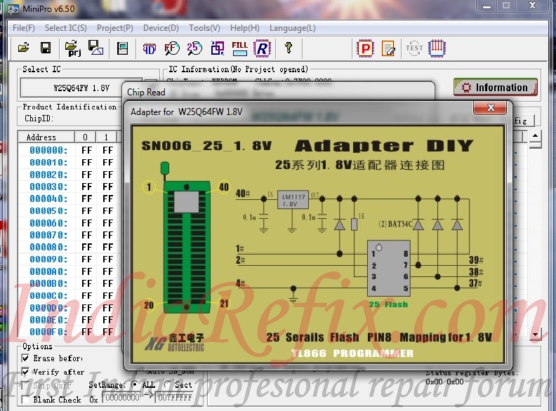

i am facing a problem for programming 1.8 v bios 25q64fv bios that decited on my programmer mini pro tl886 bt cant able to write it i can read bt cant write
on adapter it for it bt cant find adapter for my programmer please help me in regards

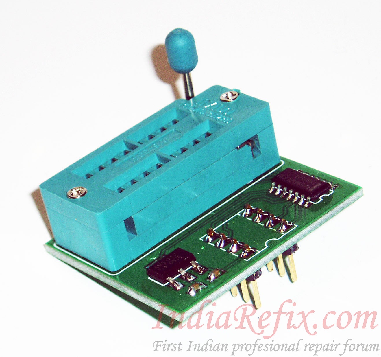

You can buy adapter

You need to buy the proper adapter to regulate 3.6v to 1.8v

I make my own with using lm117 1.8 tl866 can read this bios BT can't write Sol make vcc 3.3 to 1.8 this adopter do same

i have adapter and i can write and read normally

Its neccesary the adapter... ok
