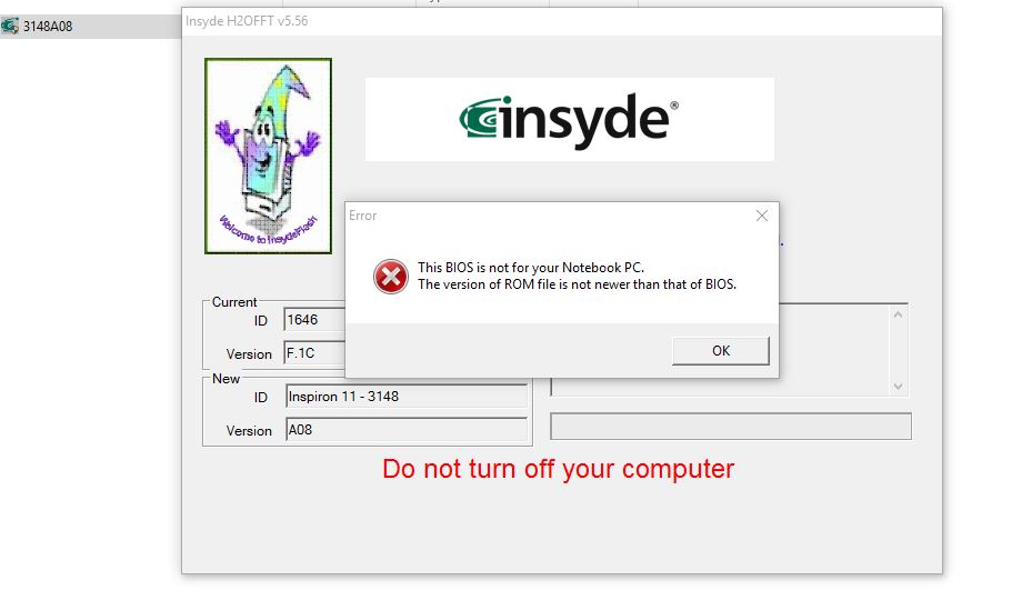

.Jpg represent pictures information only , for details about this post first login and learn how to extrect that BIOS

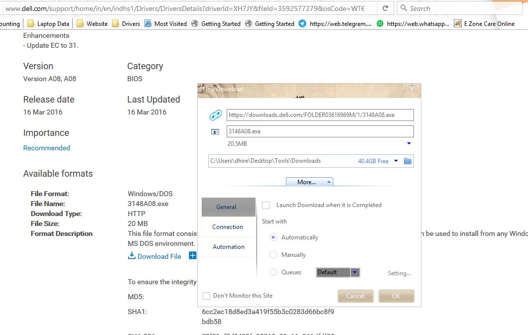

Step:1
Official Bios Downloading
Download Bios.JPG (90.96 KiB) Viewed 3431 times

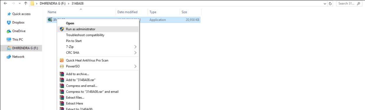

Step:1
Run File Adiministrator
Run Administrator.JPG (38.34 KiB) Viewed 3431 times
Not Install Found This Screen

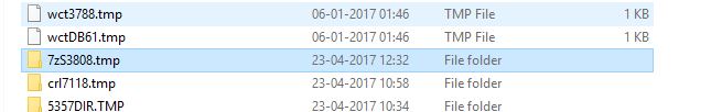

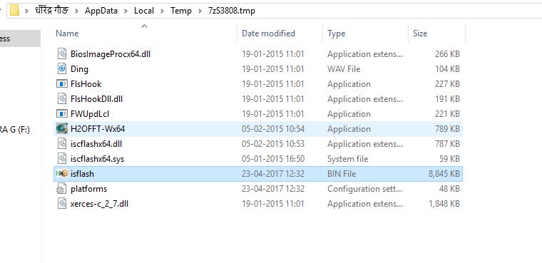

Step:3
Temp Folder
Temp Folder
Temp Folder.JPG (20.46 KiB) Viewed 3431 times
Step:4
Found Bin File
Found Bin File
Found Bin File.JPG (45.2 KiB) Viewed 3431 times

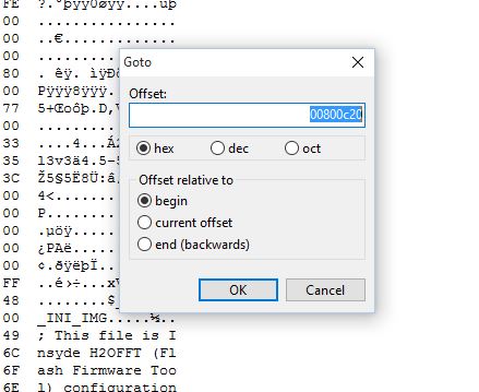

Found Bin File Size is large size open this file Bios Editing tools and go to Offset 00800c20
GO to Offset Location 00800c20

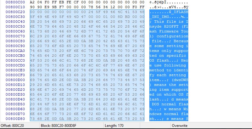

Step:6
After Going Offset 00800C20 Location Select all Contain And Erase
Erase All contain Down position.JPG (110.18 KiB) Viewed 3431 times

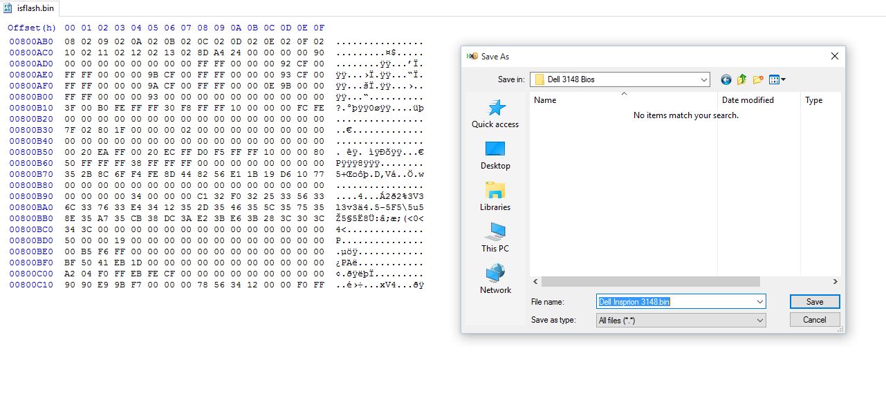

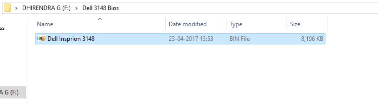

Step:7
Save File with .bin extansion name
Save File.JPG (110.51 KiB) Viewed 3431 times
Step:8
Found File
After Save Found file
File size.JPG (19.96 KiB) Viewed 3431 times

Open Temp Folder
Open Temp Folder
