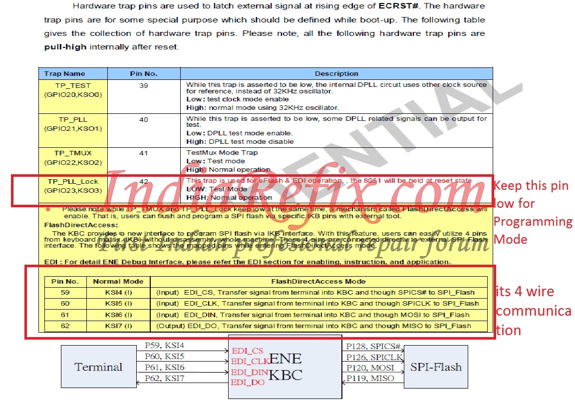

Pin No. 59,60,61,62 of ENE 9012 or 90XX may connected on keyboard connection any where so please refer to keyboard connector in pdf.
Details for ENE pin and programmer pin as attached:
ENE PIN Rt809 Socket Pin
59 05
60 10
61 09
62 06
42 08
Key board connector details as per you motherboard may check with PDF and ene Signal name as well...

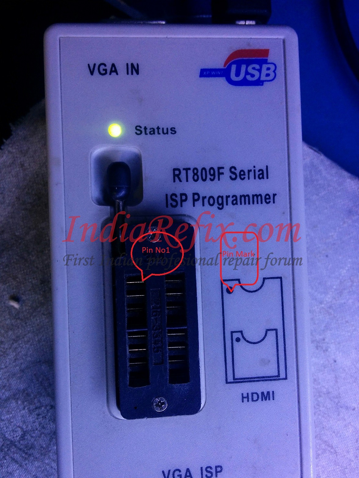

Programmer pin description as 16 pin Socket
