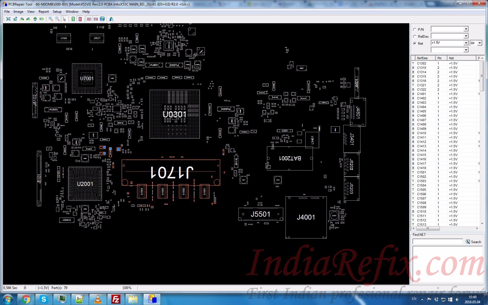

found that 1,5V - 0 ohm

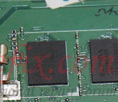

Thought that can be integrated ram chips culprit and what you think. From 8 chips 7 was shorted..

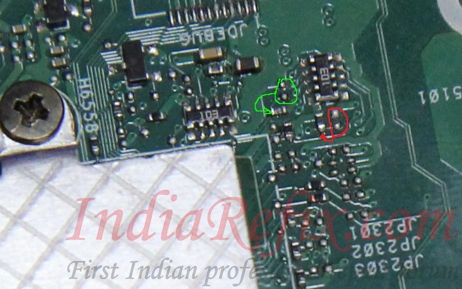

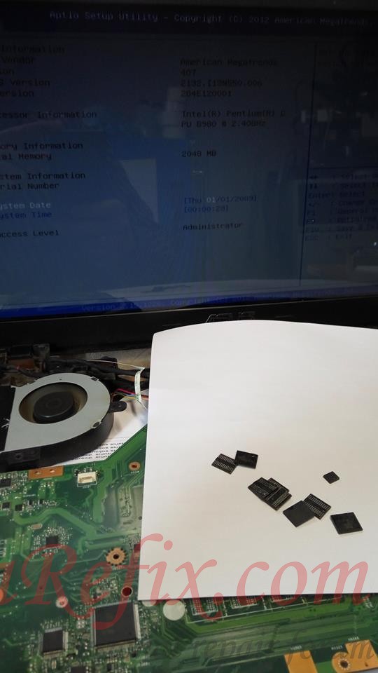

Removed those chips, also 1,5V upper mosfet was shorted too.
Disconnect integrated ram

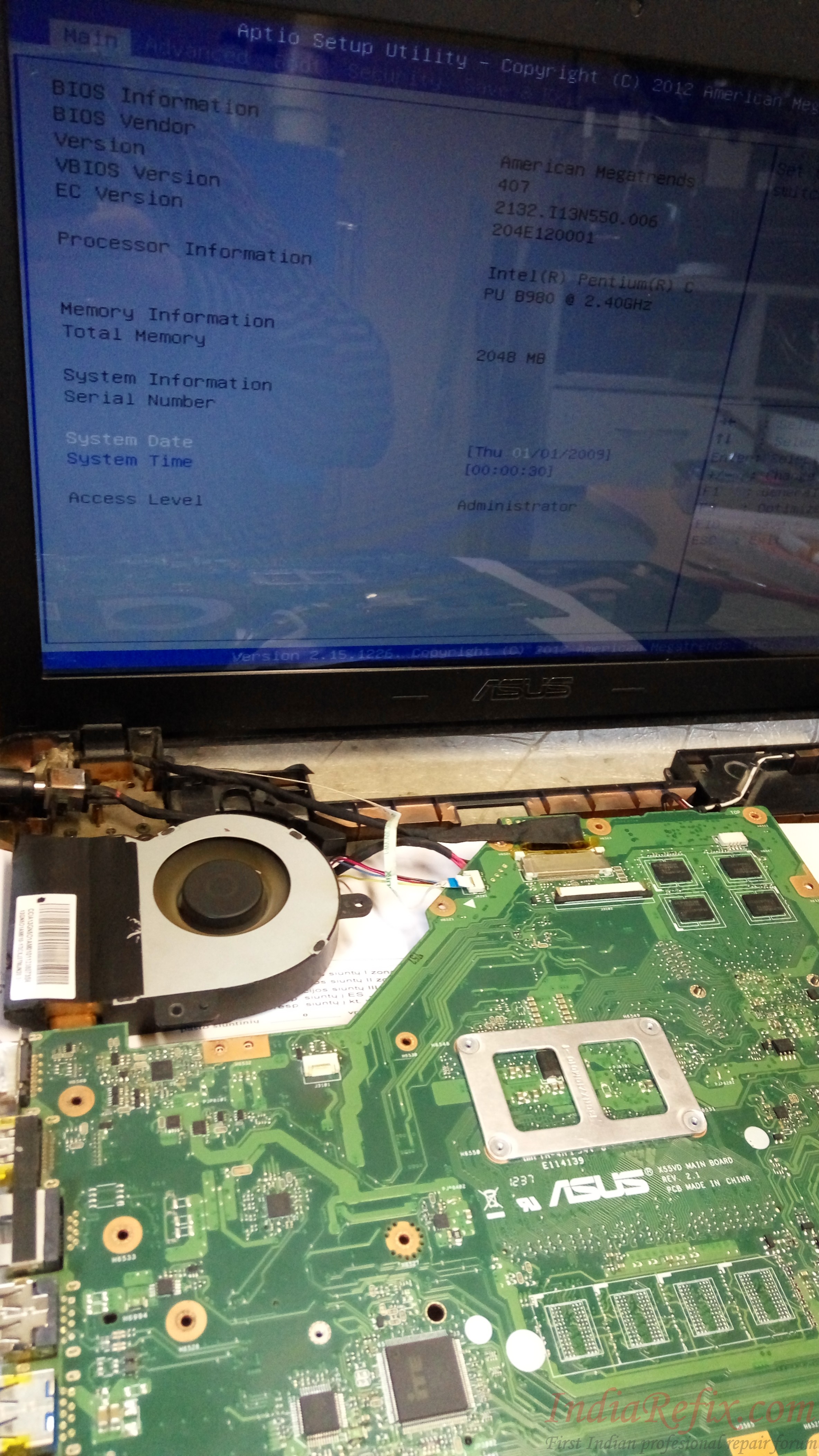

Laptop now working.
