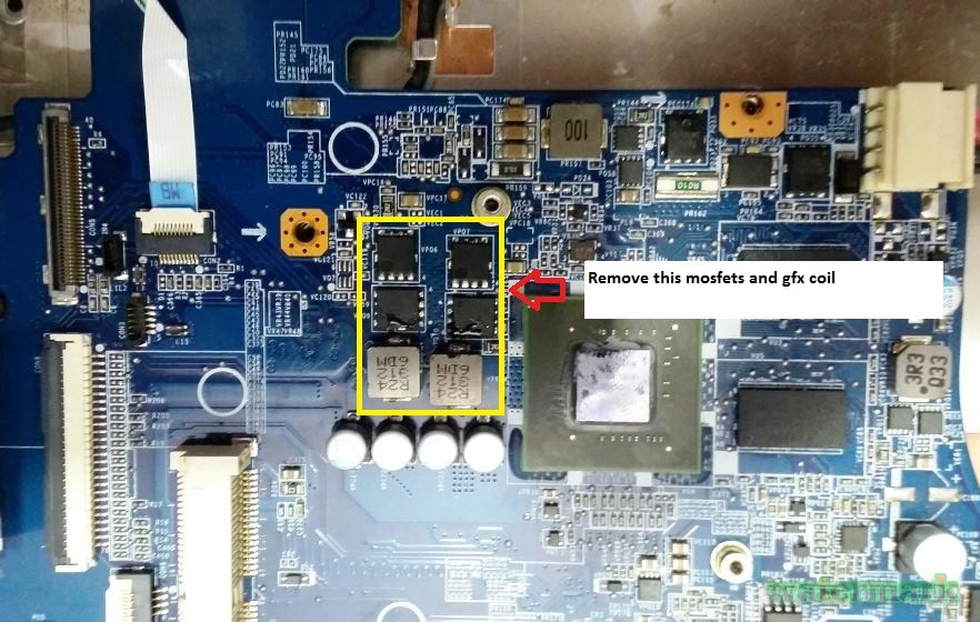

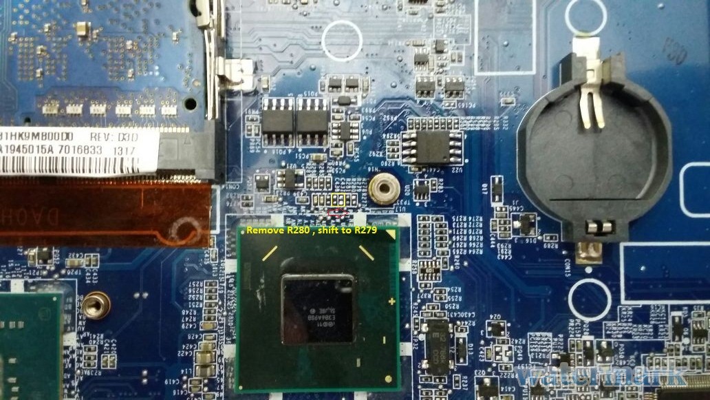

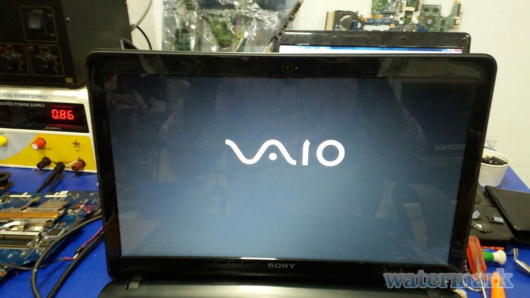

sony DA0HK9MB6D0 gfx to non gfx done..
Post by ibrahim_sydha »
Feeling happy...
