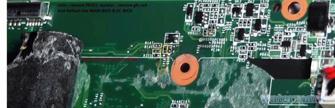

Lenovo Z585 AMD series mother board DALZ3CMB8E0 gfx to non gfx done...
ibrahim_sydha
Posts: 58
Location: chennai
Post by ibrahim_sydha »
Feeling Happy :D :D :D :D

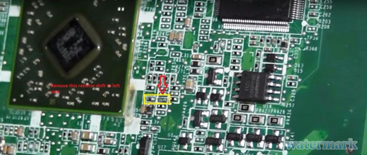

Re: Lenovo Z585 AMD series mother board DALZ3CMB8E0 gfx to non gfx done...

Sir Need to do only shifting 1 Reg..?
nice job
