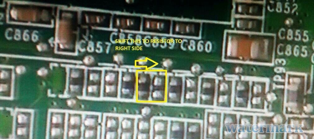

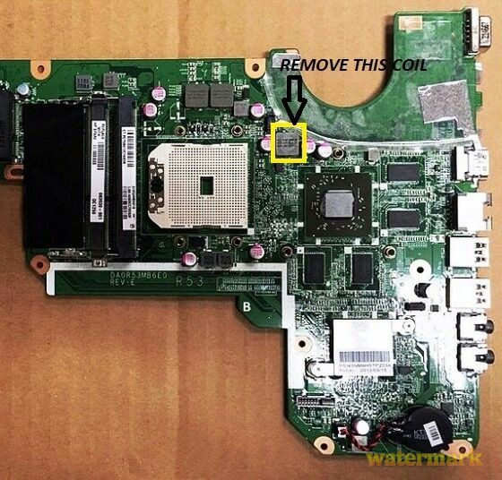

hp g6 (r53) amd series gfx to non gfx done
Post by ibrahim_sydha »
feeling happy :) :)
