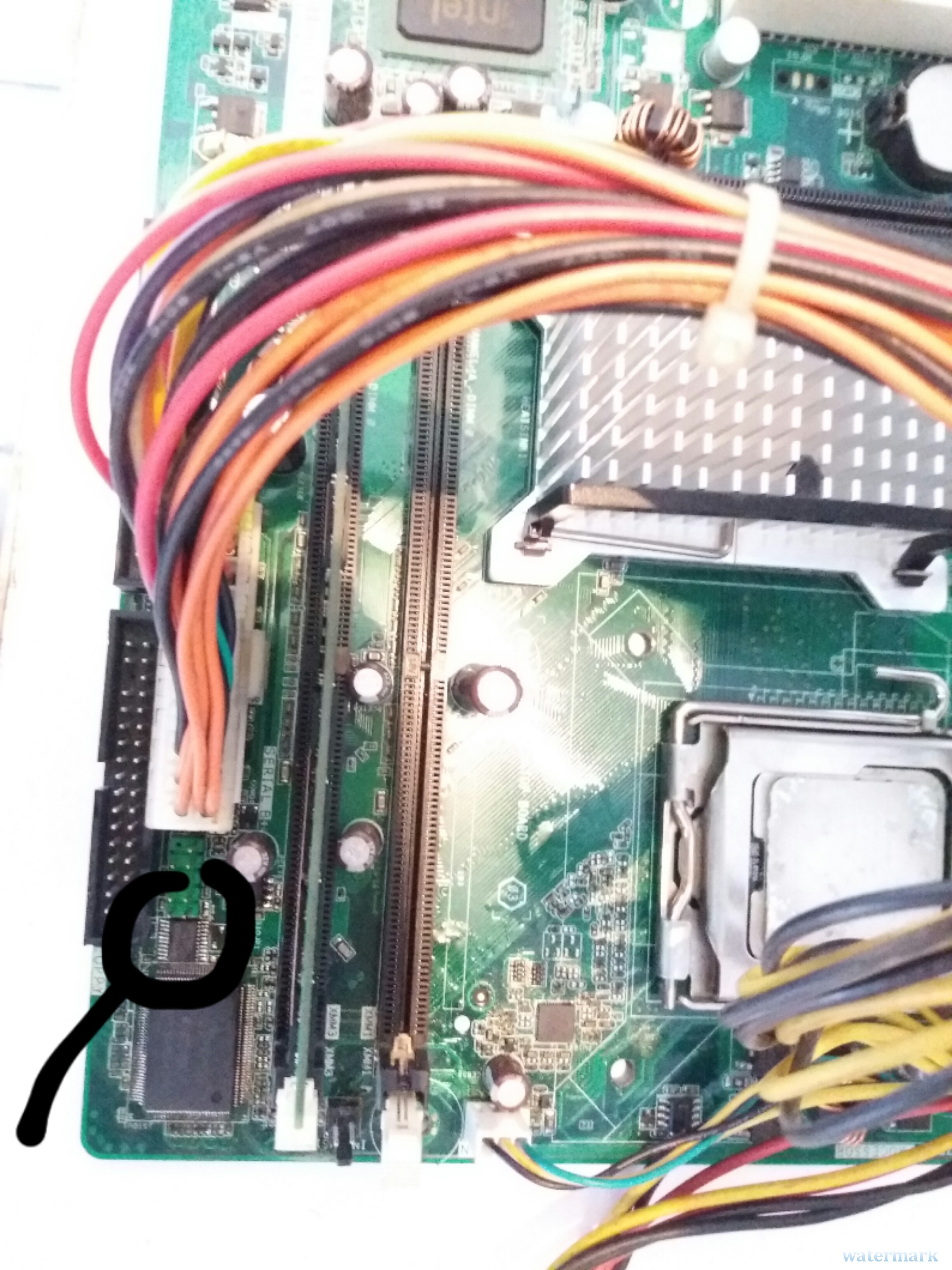

Intel desktop board LGA775 socket
Prob: No display
Diagnose: check VID and VTT power boot voltage. VID is missing.
Sol: changed the marking IC and display come. Job done.
