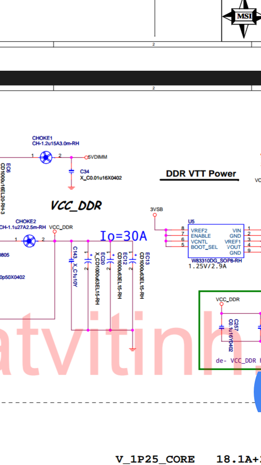

Work chk all standby volts ok then reflow io mb on bt no clock
Debug error 00 reflow io again bt same chk all volts and found ram volt core volt missing chk ram controller (p6103) supply ok bt no volt at gates change controller with 6109 mb ok bt after 20 min mb off chk again all volt found ram volts are 2.5 change controller with same number mb ok & 1.9v ok bt abhi bhi mb band hora tha 20 min bahd bios chip change kia fir b same cpu capcitor change fir b same after all chang u5 ic see in pic wo change kia ab mb finally ok
