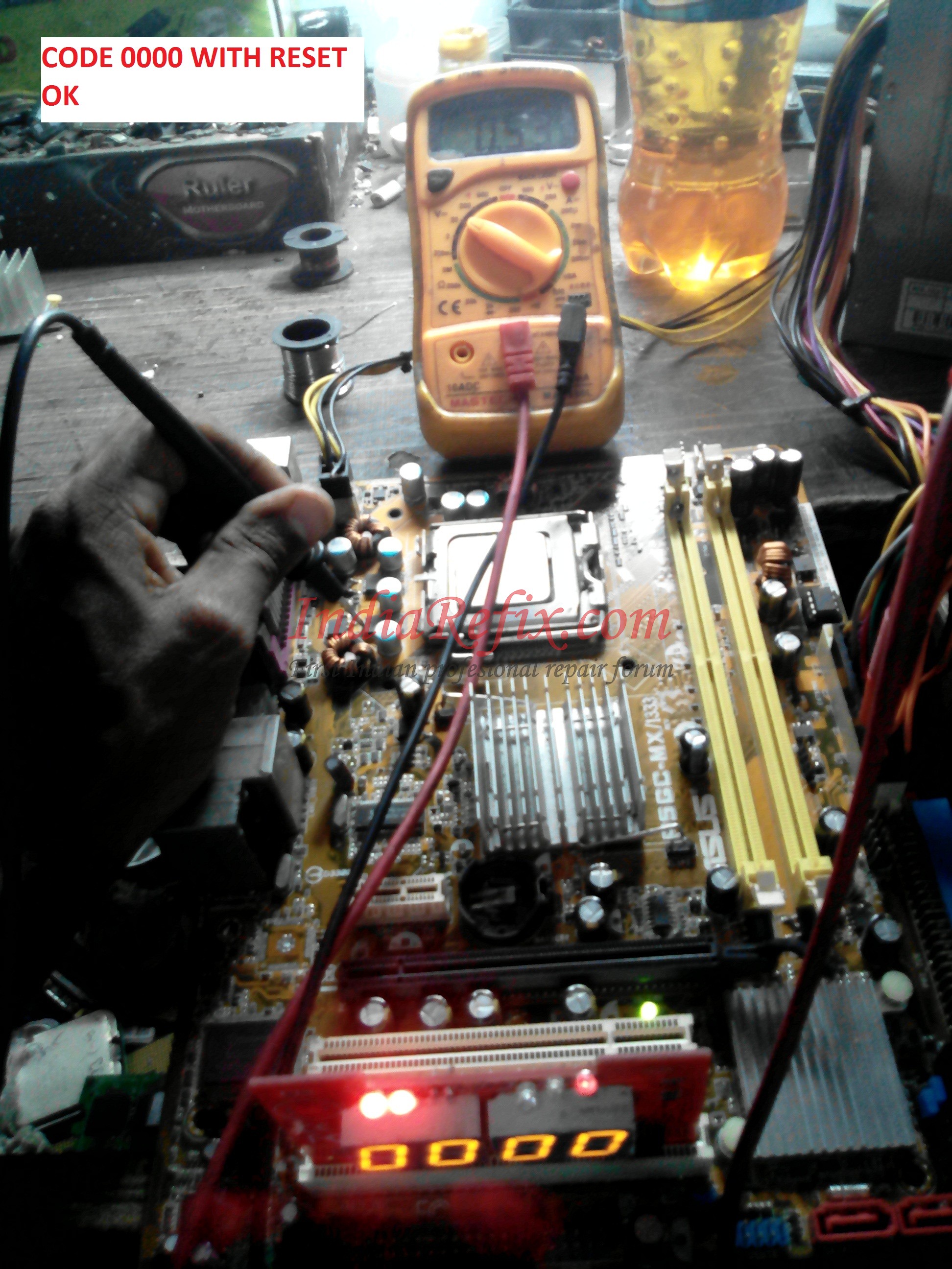

this board have no display... debug code 0000

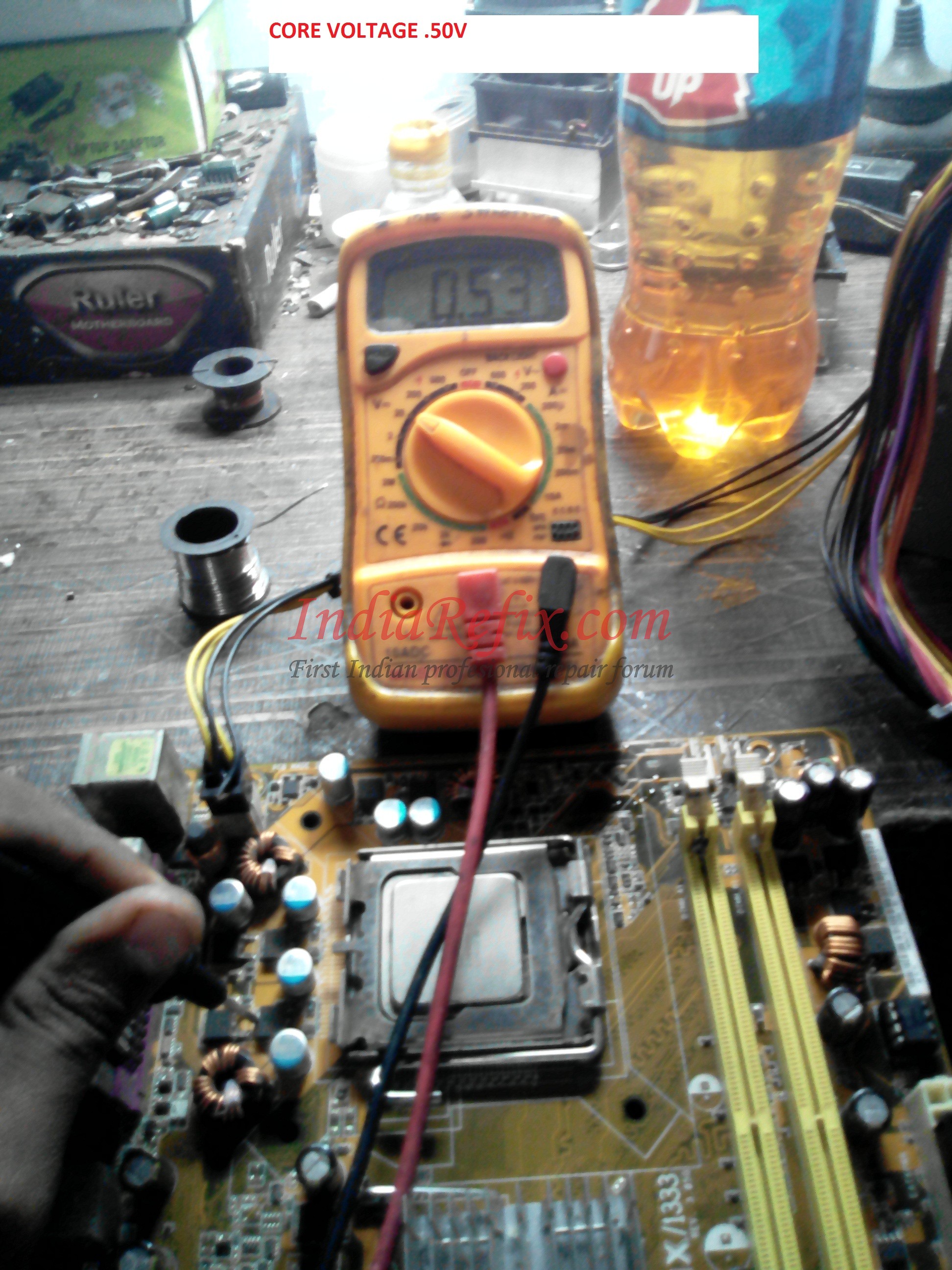

CHECK ALL VOLTAGE OK BUT CORE VOLTAGE HAVE 0.40V
BUT CORE VOLTAGE SHOULD BE 1.10V

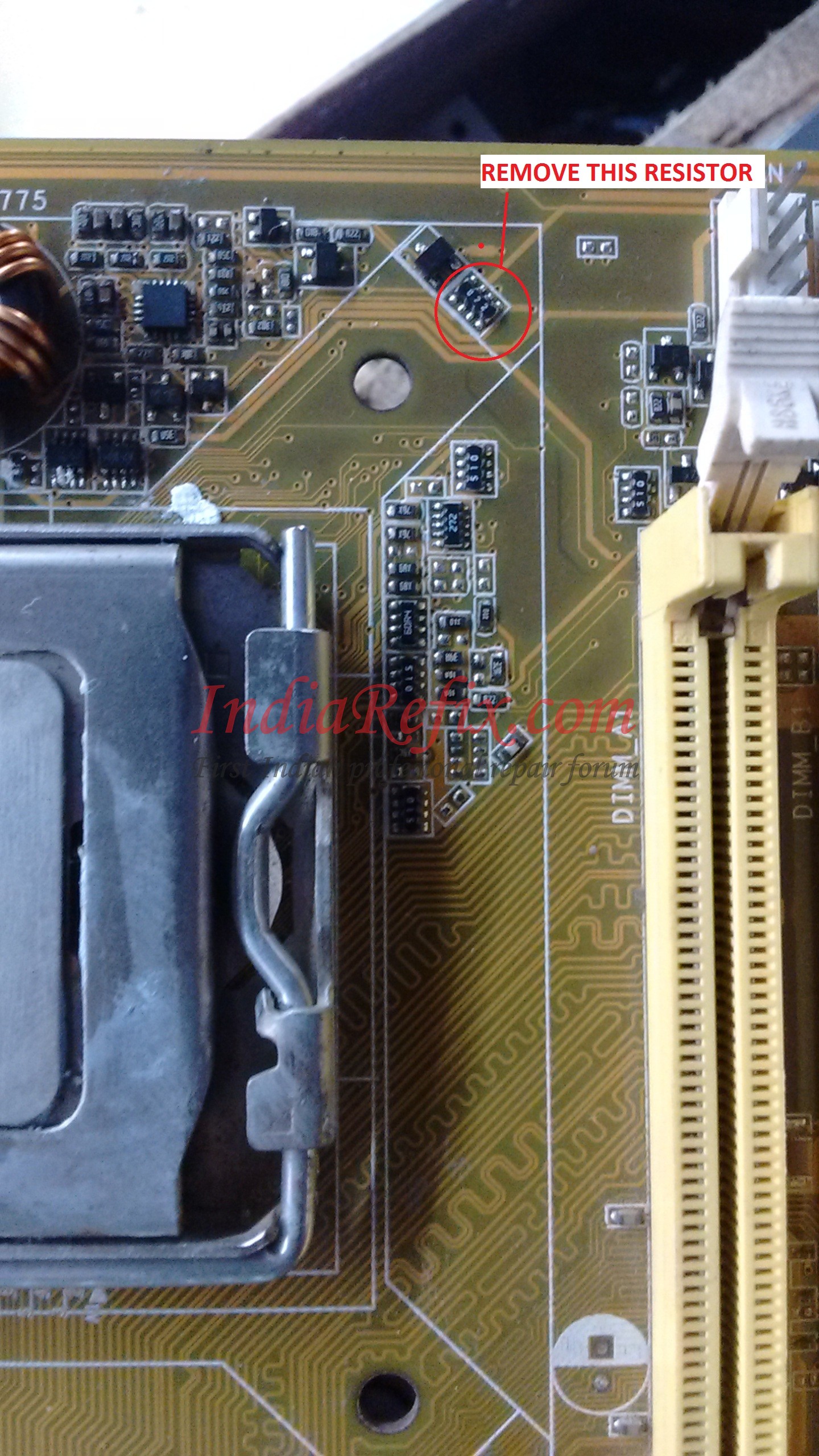

CHECK THE ALL SECTION PREVIOUS ENGGINEER REPLACED I/O, CLOCK IC, CORE IC , CORE PWM IC
THEN I REMOVED JUST 822 RESISTOR NEAR PROCESSOR SOCKET AND CORE PWM IC
CHECKED CORE VOLTAGE OK 1.10V AND BOARD RUNING WITH ALL CODE
NOW DISPLAY COMING
THIS IS ASUS P5GC / AM/PS LIKE THIS BOARD DEFULT ISSUE MANY TIME I FOUND THIS RESISTOR PROBLEM .. REMOVE THIS ONLY BOARD OK
DEBUG CODE 0000 WITH OK RESET BUT NO DISPLAY
CHECKED CORE VOLTAGE .50V (PROBLEM) WIRTHOUT PROPER CORE VOLTAGE CPURESET CANT GENERATE

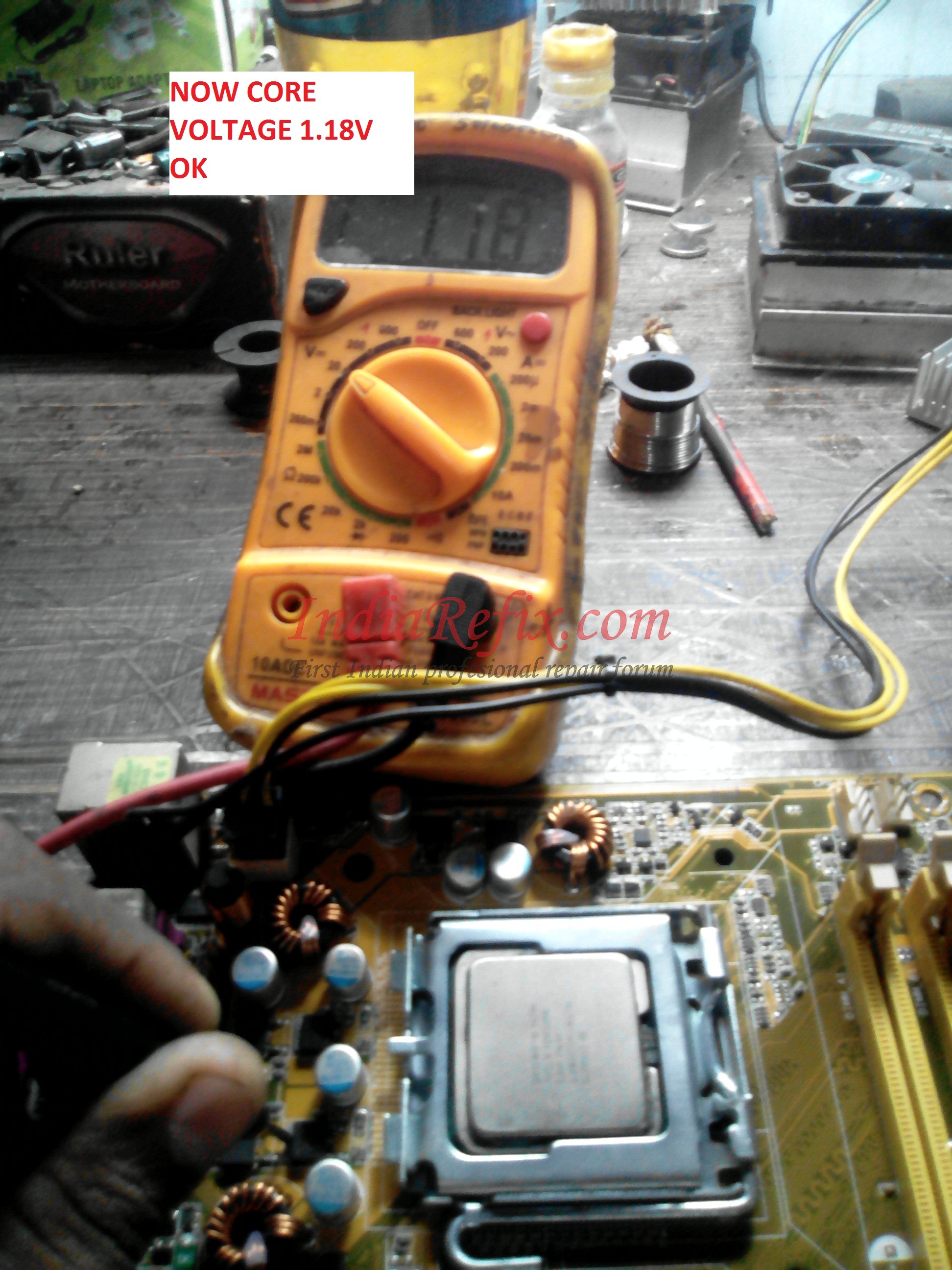

NOW CORE VOLTAGE OK 1.18V
