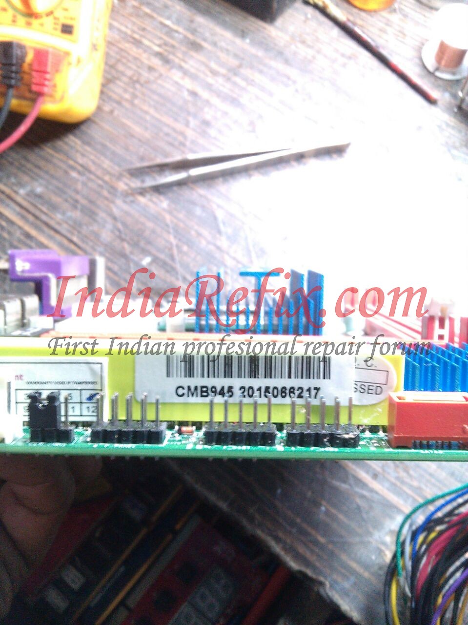

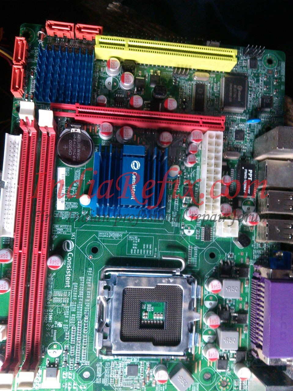

CONSISTANT CMB945 GREEN BORAD NO DISPALY
ERROE SHOW IN CARD 0000
CHECK ALL VOLTAGE OK LIKE
RAM- 1.8
VCORE- 1.0
GMCH VC- 1.0
CPU VTT 1.0
VRMPGD-3V OK
CLOCK EN- 3V OK
SOLUTION- CHANGE THE CPU & BRUSH THE BIOS
NOW BOARD OK DISPALY OK
