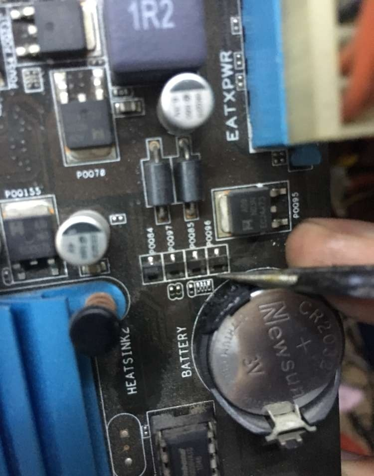

ASUS M4A87T power on seconds down feels like a short circuit maintenance in VRM
YOU CAN CHANGE 822 NETWORK RESISTOR NEAR CMOS SOCKET SIDE.
THIS IS IMAGE
