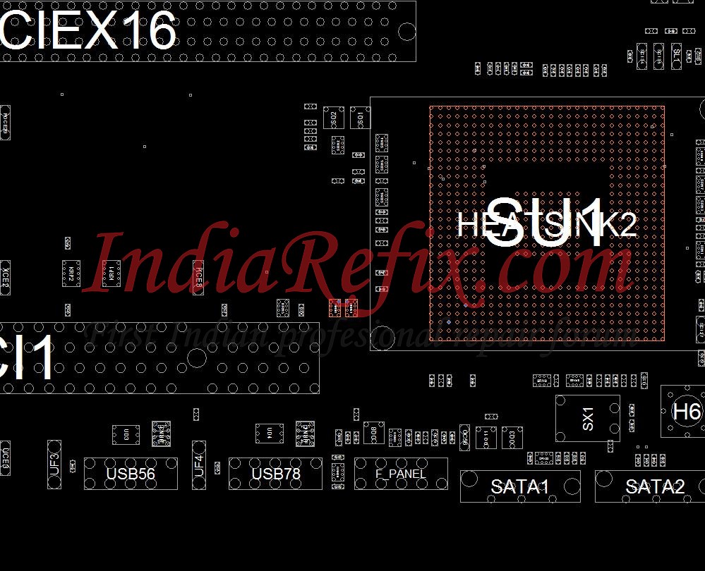

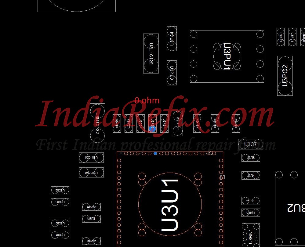

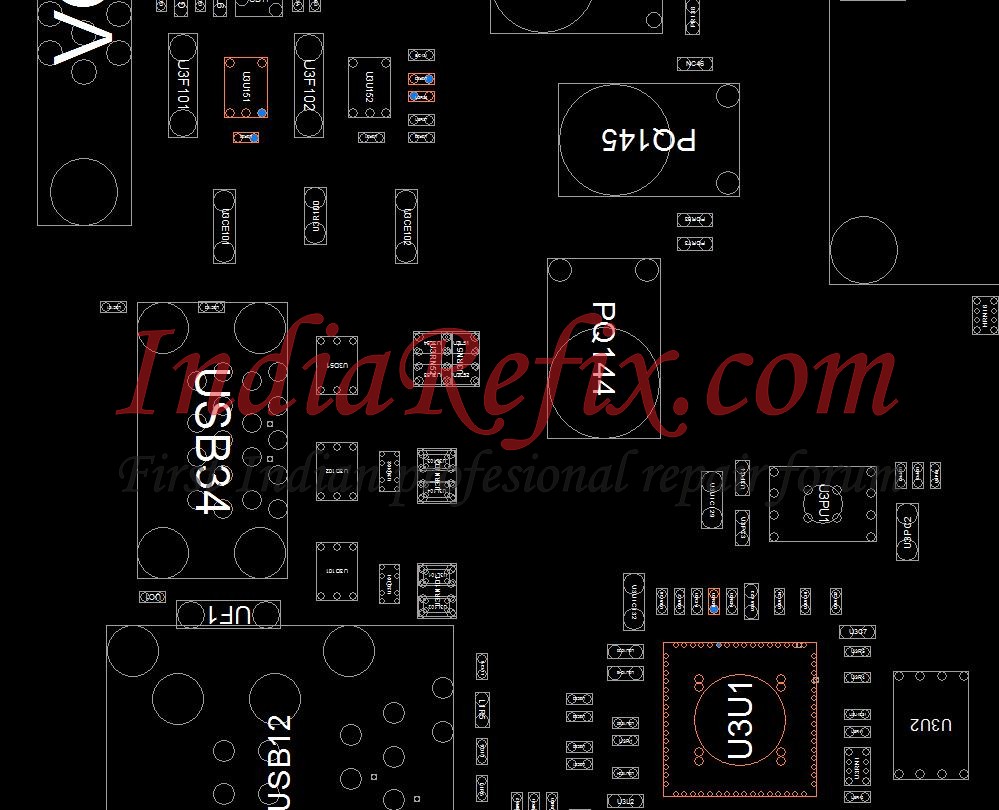

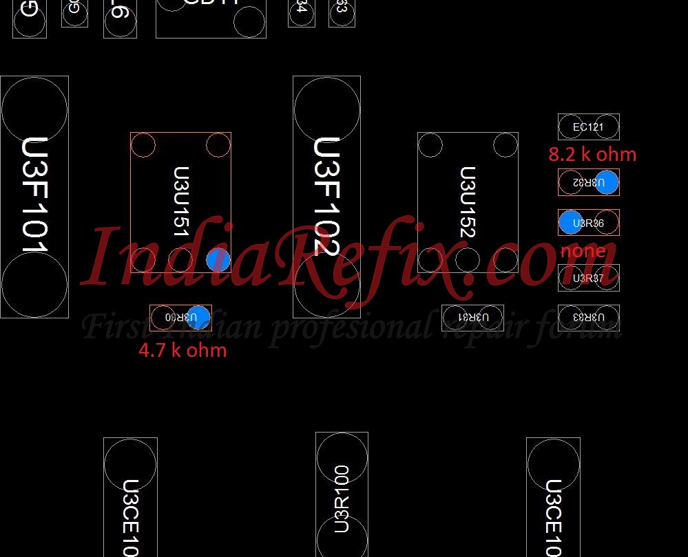

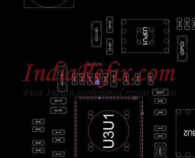

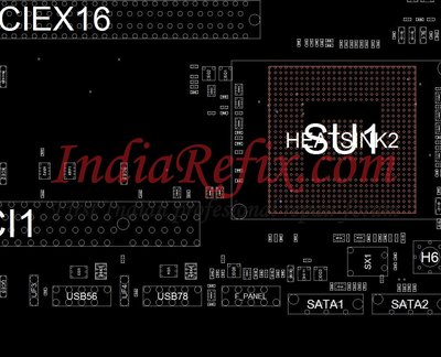

P5G41T-M LX3 REV:1.01 15 SECOND USB DEVICE OVER CURRENT
Post by DHRUVGONAWALA »
