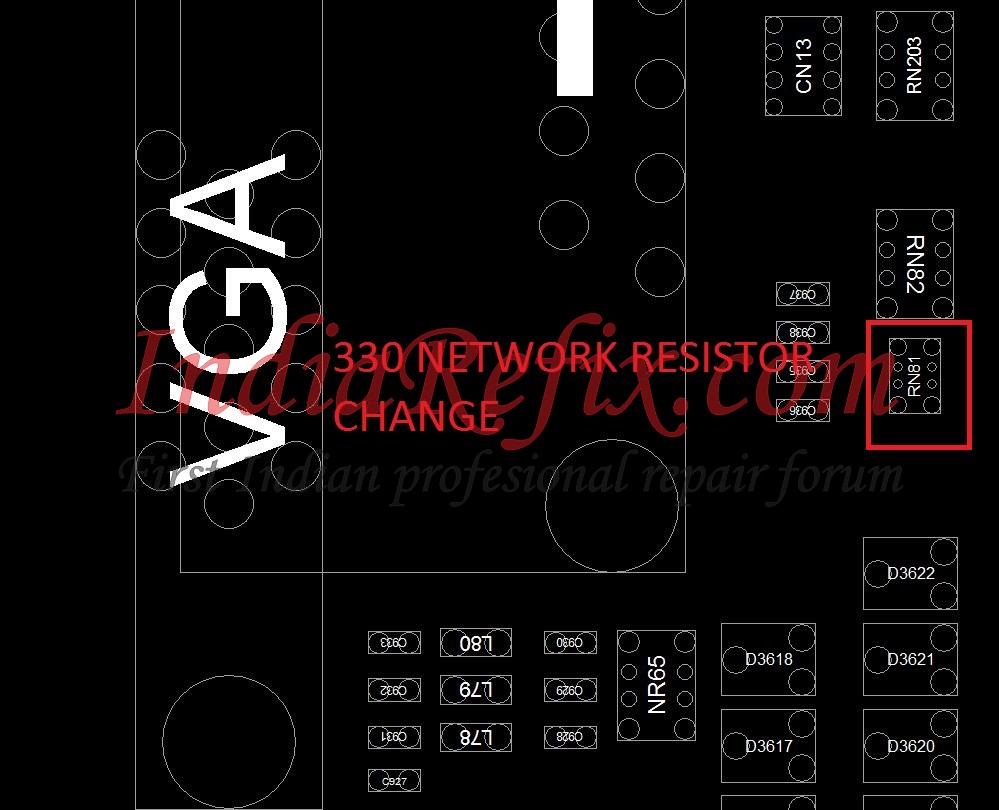

M2N68-AM PLUS
has power on run code but no display
i trace all vga line
i found
rddc_data
rddc_clk
rhsync
rvsync
this siganl is not perfect to nivida chip
i change 330 netwrok resistor change near vga port
